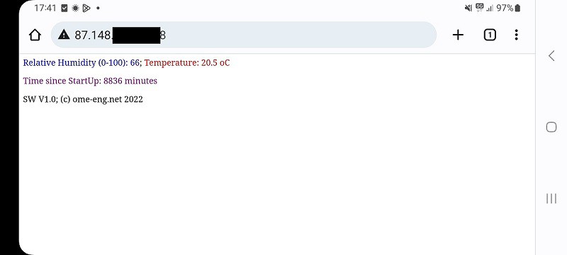

3. Humidity sensor
Prototypes are also used for relative humidity measurements with HIH 4020 sensor (7-Segment-Display as well as IoT version). Parts of the already created algorithm had to be enhanced and modified for this obviously (see links to my github repo).
A basic output in a web browser (as to the ambient light sensor, see project log):
Note: there are some robustness measures for the webserver in place, such as using the HW watchdog and using a port different from standard http port 80 (that is dealing with a lot of useless data and requests what may generate confusion in an algorithm).
