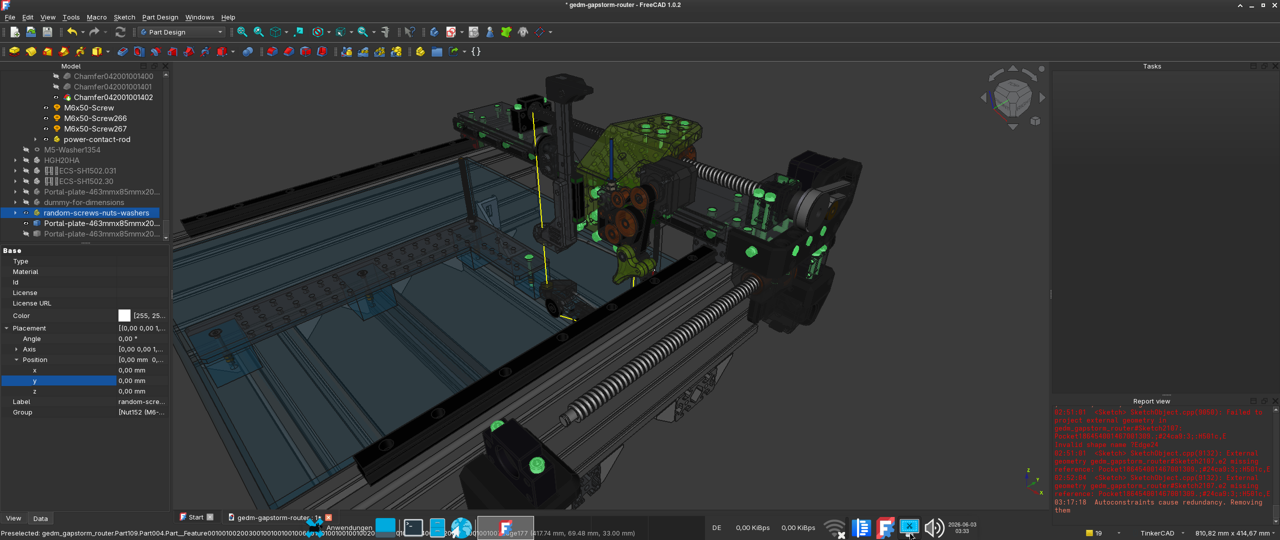

The G-EDM is a fully automated ESP32 based three axis EDM CNC machine that supports different kinds of electrodes like brass tubes or brass sheets and is highly customizable. With the new wire EDM extension it is possible to cut high precision parts out of aluminum, mild steel, HSS and other metals. Besides normal operations like drilling and wire EDM it also provides an experimental EDM engraving mode that uses a normal brass rod as a floating electrode to engrave text into metal or erode pockets.
It uses 3D printed parts where it is possible and in the future it may support even laser and mill operations.
