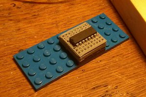

The electromagnets are constructed with 50-micron enamel-insulated copper wire with a ferrite core. A 3D Printed winding tool makes winding such small electromagnets easy.
Apart from the winding tool, all standard assembly & soldering tools are sufficient to build your own braille modules.

Hey there! Great project. I am working on a robotics project which needs custom electromagnetic actuators just like the ones you made. I am trying to replicate the solenoid coils that you made. Can i please know what was the gauge of the wire, and the length of the coil ?
