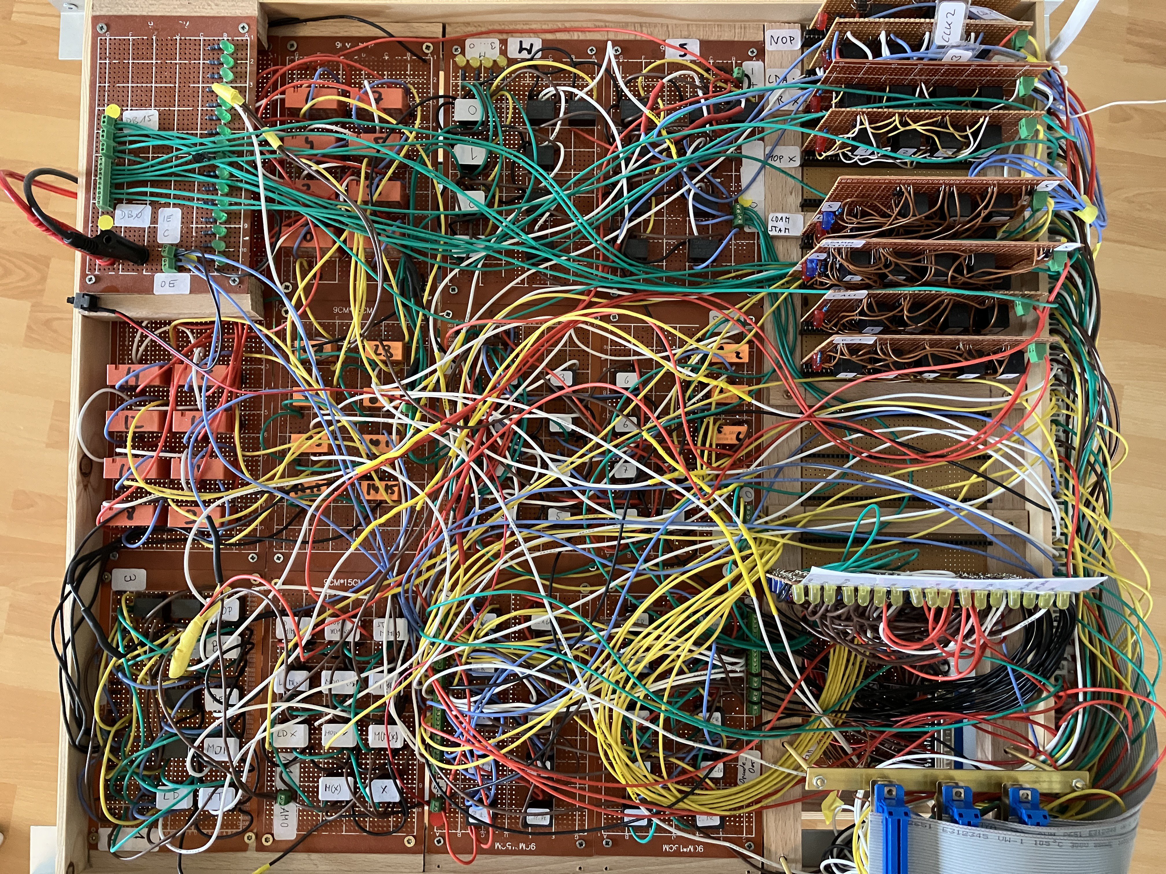

Here you see an actual picture of the complete system:

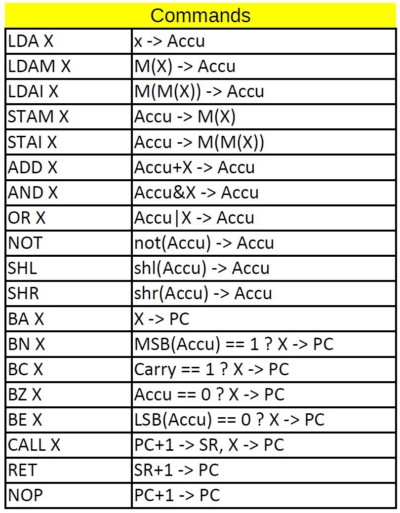

The following table shows the command set of the CPU:
The CPU is able to adress the memory using 3 different adressing modes. a) LD X is loading the Accu with the dataword stored in the adress after the opcode, b) LD M(X) is loading the Accu with the data stored in the memory adress stored after the opcode, and c) LD M(M(X)) is ... yes, indirect adressing. The dataword after the opcode contains the adress where the CPU finds the adress of the dataword that will be stored in the Accu. Is adressing mode c) really necessary? Maybe not. But it makes it easier.
And, as you can see, a CALL / RET set of operations is also avaliable. No, there is no stack realized, only one subroutine level is possible. The return adress is stored in the register SR.

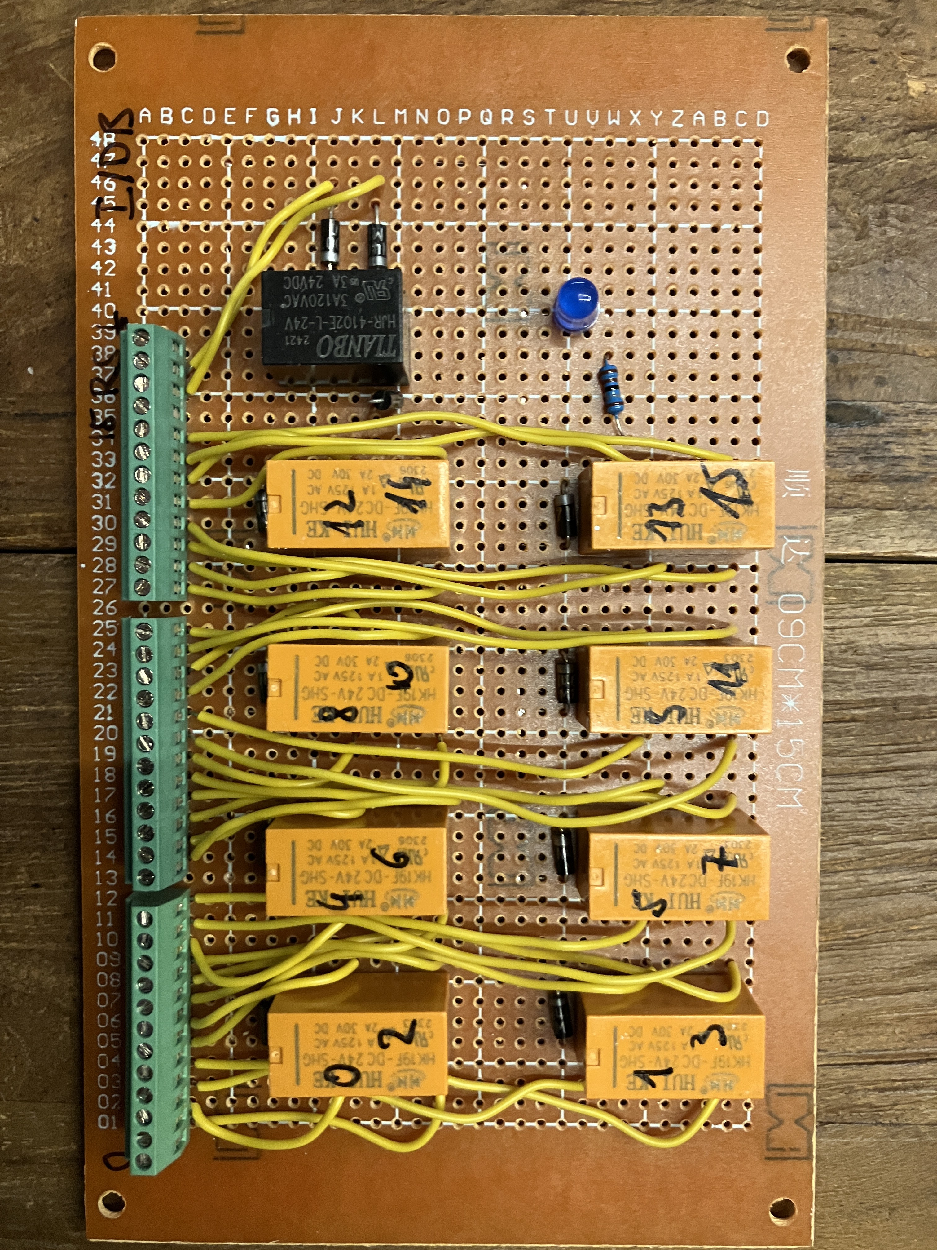

The relay element:

    So, here you see the complete ALU result register. It is a 16 bit register. The board with the 17 black relays is the storage board, 16 relays to store the 16 bits (the relays are holding themself active when switched on), one relay to switch off VCC to clear all 16 storage relays. The two other boards are used as an input enable board from the ALU or as an output enable board to the databus...

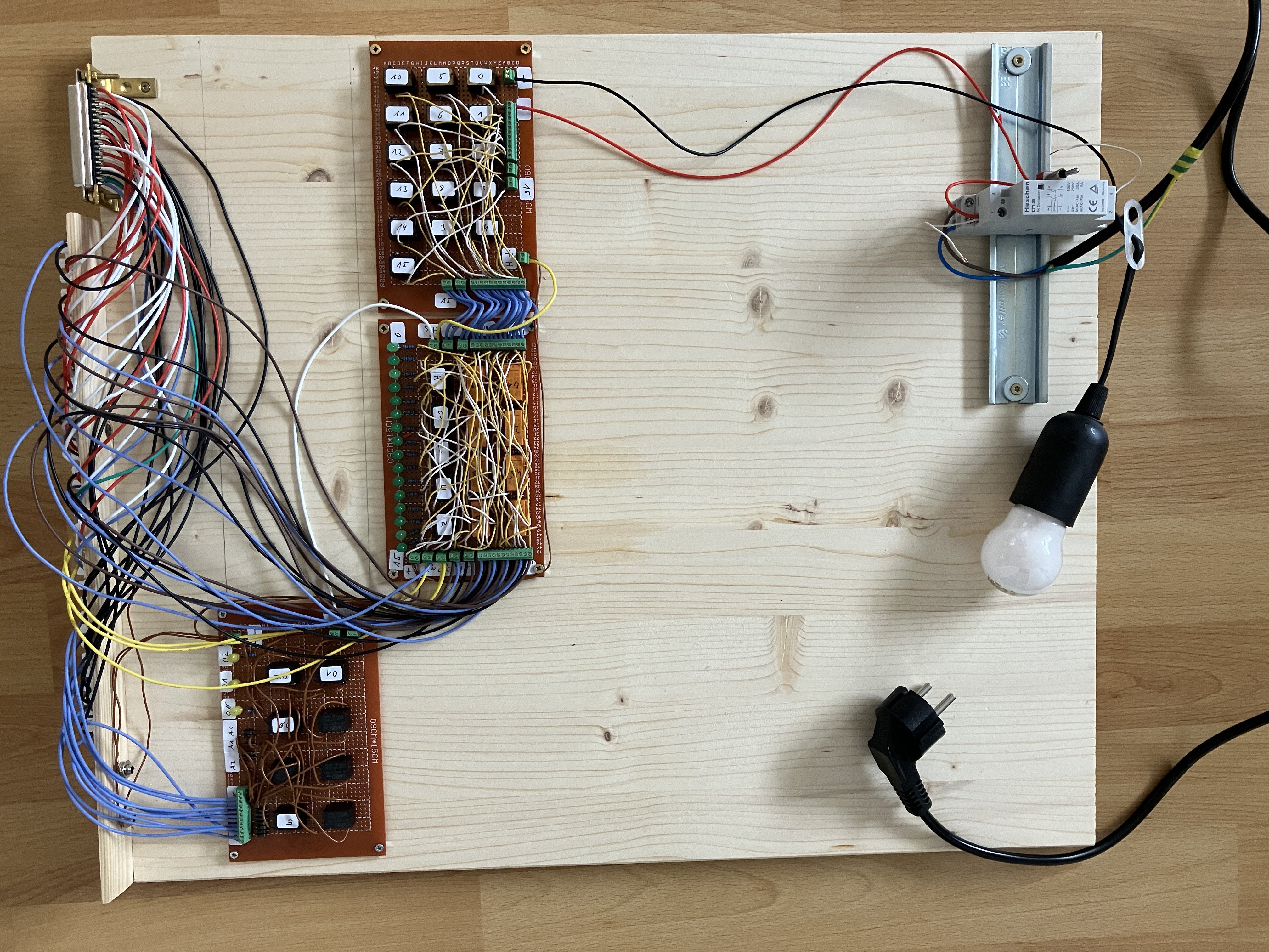

    So, what you see here is the complete adress-module of the relay CPU...the first of three plates is now complete:
    This module is able to hold a 10 bit program-counter, add +1 if necessary, read/write the program-counter to/from the databus, load a adress from the databus into a adress-register and write the program-counter or the adress-register into an adressbus-register...which is connected to the adressbus.

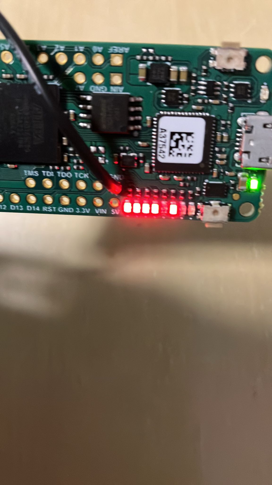

    So, I connected the first 8 ALU boards to implement a 8-bit ALU and tested it. The Shift Left/Right, AND, OR and NOT commands worked perfect. And in the following two pictures you see the calculation of 0x7F + 0x21 = 0xA0 (or: 127 + 33 = 160).
    The first picture shows 0x7F + 0x20 = 0x9F (1001 1111, you see the red LEDs).
    The second picture shows you 0x7F + 0x21 = 0xA0 (1010 0000).
