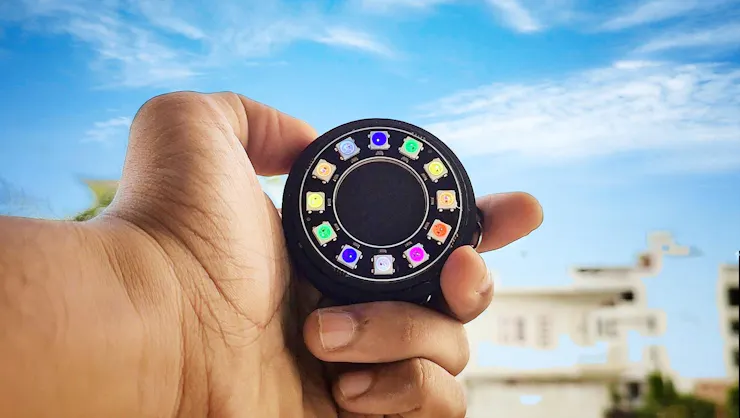

    How Game Works
    When the device is turned on, it will show all the colours. After this, all 12 LEDs will show the same colour and blink twice, which means this is your target colour.
    Press the push button when the target colour is on by one of the 12 LEDs; if you hit the right colour, the device will show the next colour, and the speed of the LED will be increased. In this way, LEDs increase the speed of rotation at each level. If the colour is wrong while pressing the push button, the game will be restarted.

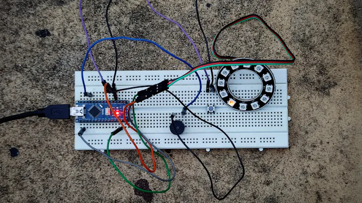

    Testing Firmware in Arduino Nano
    Firstly, I made the code for Arduino Nano because debugging Things and Connections is easier in Arduino Nano and Arduino Uno.
    As you can see in the image, I have connected All the connections on the breadboard. the buzzer, button, and LED ring After verifying all the algorithms in the code, I converted it for Attiny85.
    Both codes are given on my GitHub.

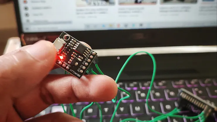

    ISP Connection of Attiny85
    I have not found the Attiny85 SMD version here, so I will desolder the Attiny85 from the Digispark board. Before desoldering the Attiny85, I decided to programme it on the Digispark board.
    But I am not going to use the Digispark bootloader because it has USB firmware, which takes a lot of memory, and there is only 4kb out of 8kb left to programme.
    So I connected the Attiny85 ISP pins to the Arduino Nano, and I used the Arduino Nano as an ISP programmer.
    If you want to know how to programme the Attiny85 with Arduino, Watch This Video.

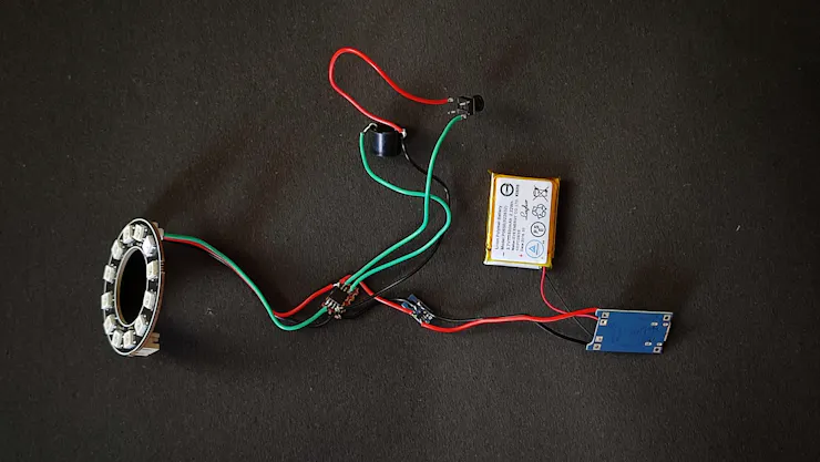

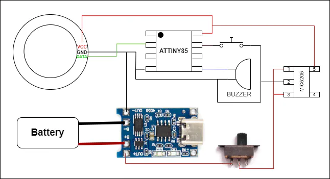

    Circuit Connections
    After Programming the Attiny85, we are ready to Connect the circuit.
    Download the circuit diagram from my GitHub and connect the circuit.
    I have removed the Attiny85 from the Digispark board and soldered it on a Zero PCB to make it stable.
    After connecting, test it to see if it is working properly or not.

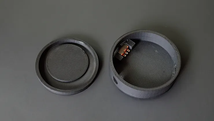

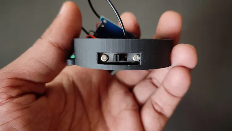

    Inserting Components in 3D Part
    After Testing the code, once you're satisfied, Let's Pack things in a 3D enclosure.
    First of all, Screw the Slide Switch into its place, as shown in the image. Glue the TP4056 Module, buzzer, and push button together.
    Insert the battery and test the circuit; if it is still working, go ahead.
    The 3D part has a circular part. Stick it inside the RGB ring, and the ring will go on the Hollow Circular Ring as shown in the image.

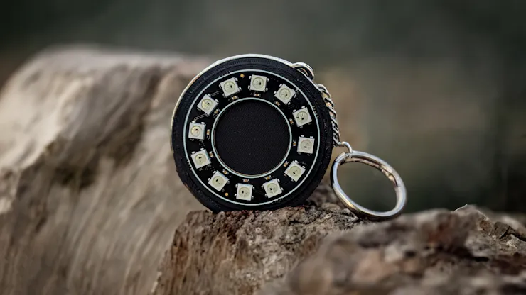

    Done
    GREAT JOB !!!!!
    we did it the HueFidget Fob - a LED Fidget Keychain is ready to Rock between friends and family.
