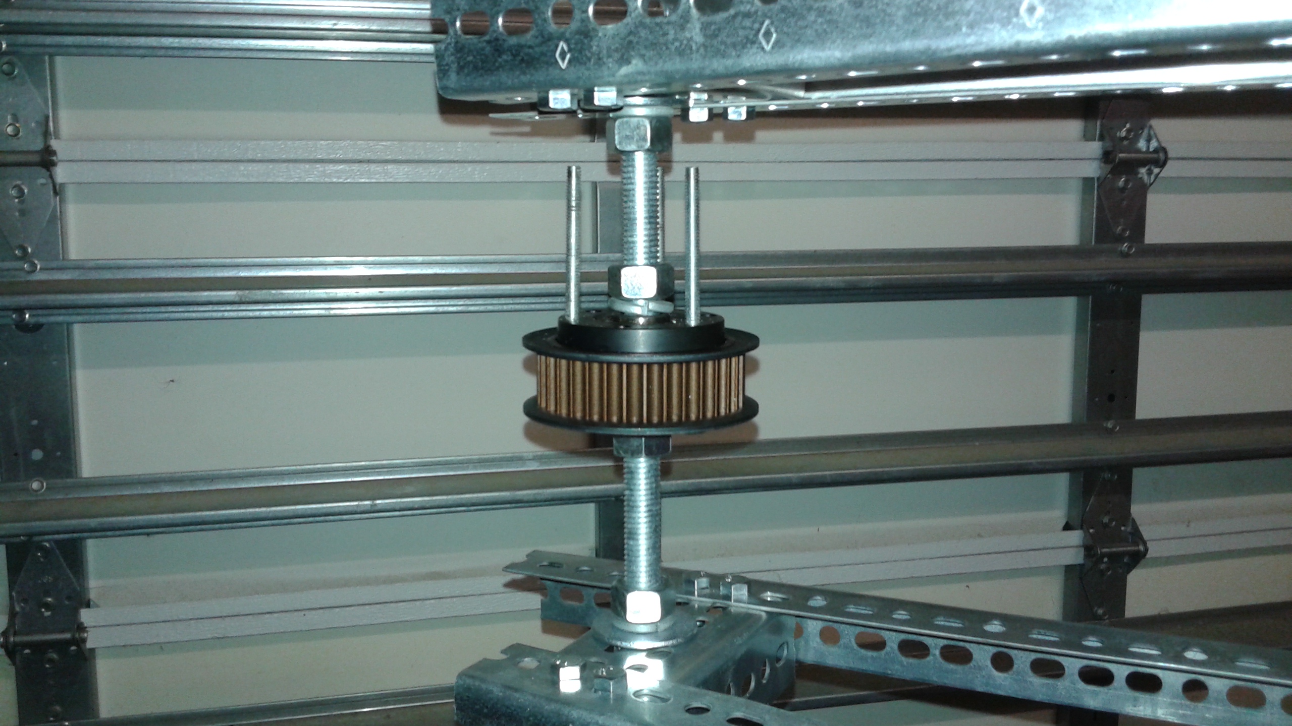

Drive System
The drive system uses High Torque Drive (HTD) belts.  These belts are made of neoprene rubber with fiberglass cords and are able to transfer more power per weight than roller chain and can also run at higher RPMs.  To eliminate aerodynamic torque, the drive system rotates two propellers clockwise (CW) and two counter-clockwise (CCW).  This is done by using two belts, one sided sided and the second double sided.  The direction of rotation is changed by placing the outside of the double sided belt against the driving pulley.

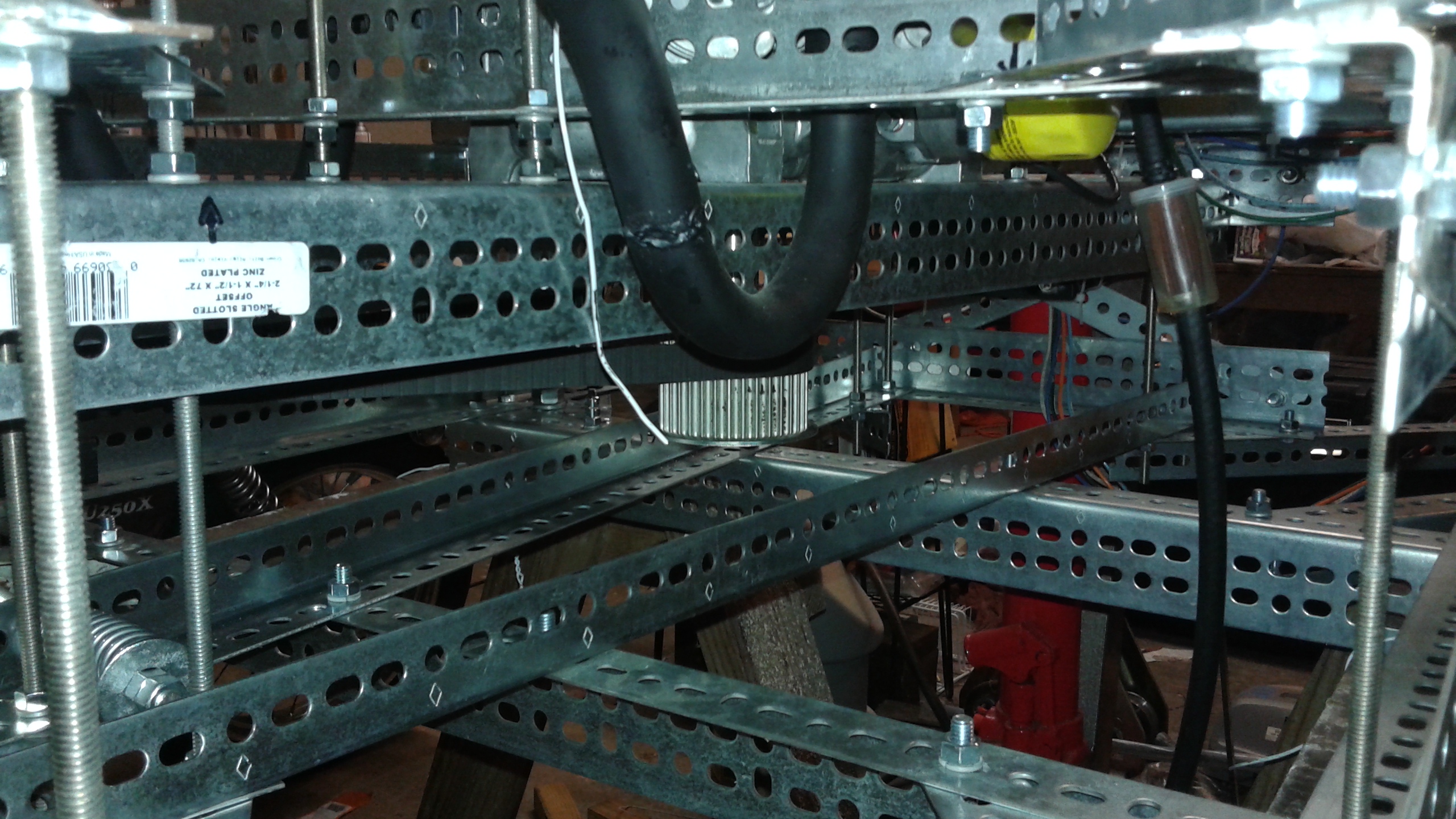

    So it took a while to get here because of the redesign of the belt tensioners, redoing the prop mounts and supports, etc. Last week I was in the process of making the final adjustments and alignments when I realized there was going to be an issue with the vehicle due to some of the changes I had made. One change I forgot to document was that I had flipped the propeller pulleys over. This is important because of the bushing attached to the pulley. By flipping the pulley over, it added a half inch of additional clearance between the propeller and the belts.
    What I didn't take into account is that this reduces the clearances above the prop. The prop would fit, but the prop tips will deflect upwards and I didn't want to risk destroying another propeller. There was lots of clearance beneath the pulley, but it was as low as it could go do to the center beams and engine shaft length. You can see this a little in the next photo.
    The solution I came up consisted of several parts. The first part was to replace the lower center beams which stood 2 3/4" tall with 1 1/2" tall beams. These aren't carrying the load of the engine like the ones above, I had just chosen to match these beams to the ones above them. This gave an additional 1 1/4" to move the belts downwards, but the pulley was already as low as it could go on the shaft. The next part was to lower the upper center beams with the engine attached. This was done by replacing the bolts one at a time with all-thread and then turning the nuts to slowly lower the assembly. The all threads and nuts act as stand offs. The engine was lowered 1" and the final result is shown below
    This modification also gets the cg lower which will hopefully make control that much easier.

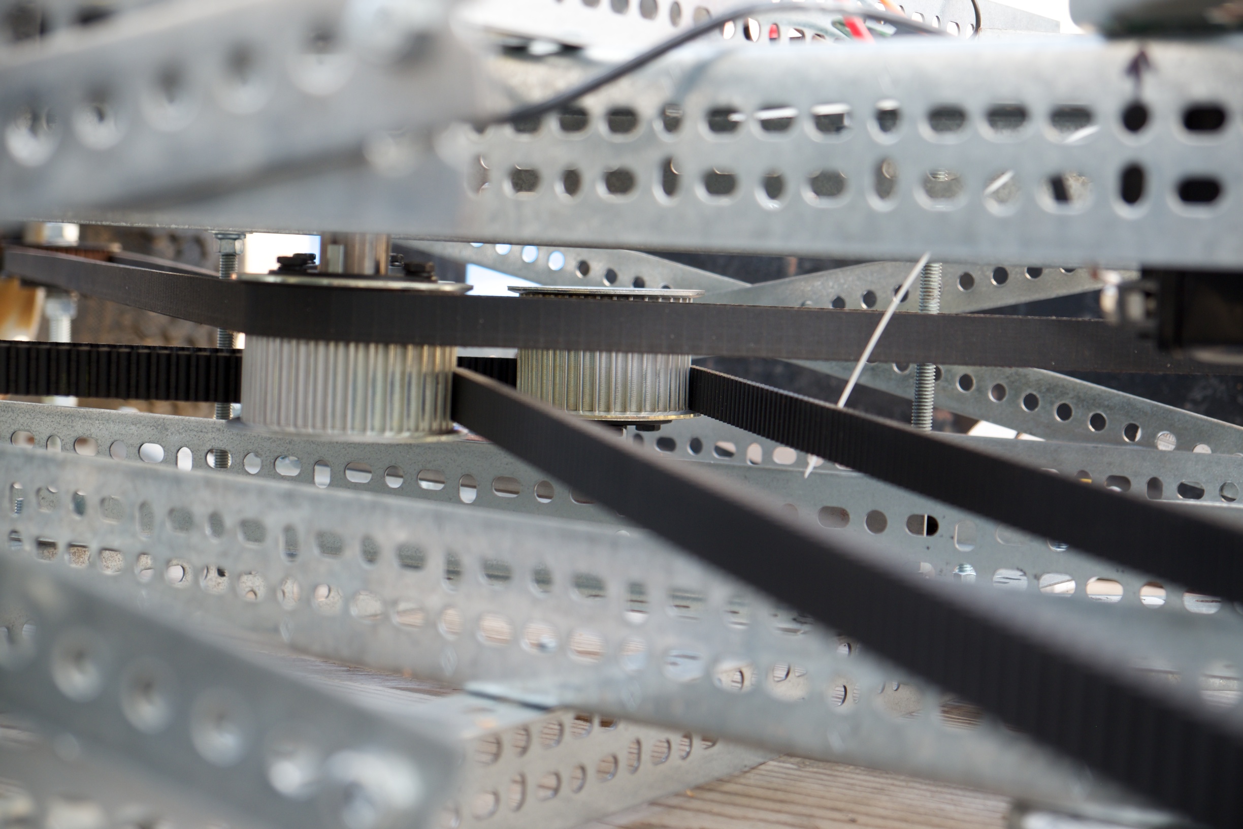

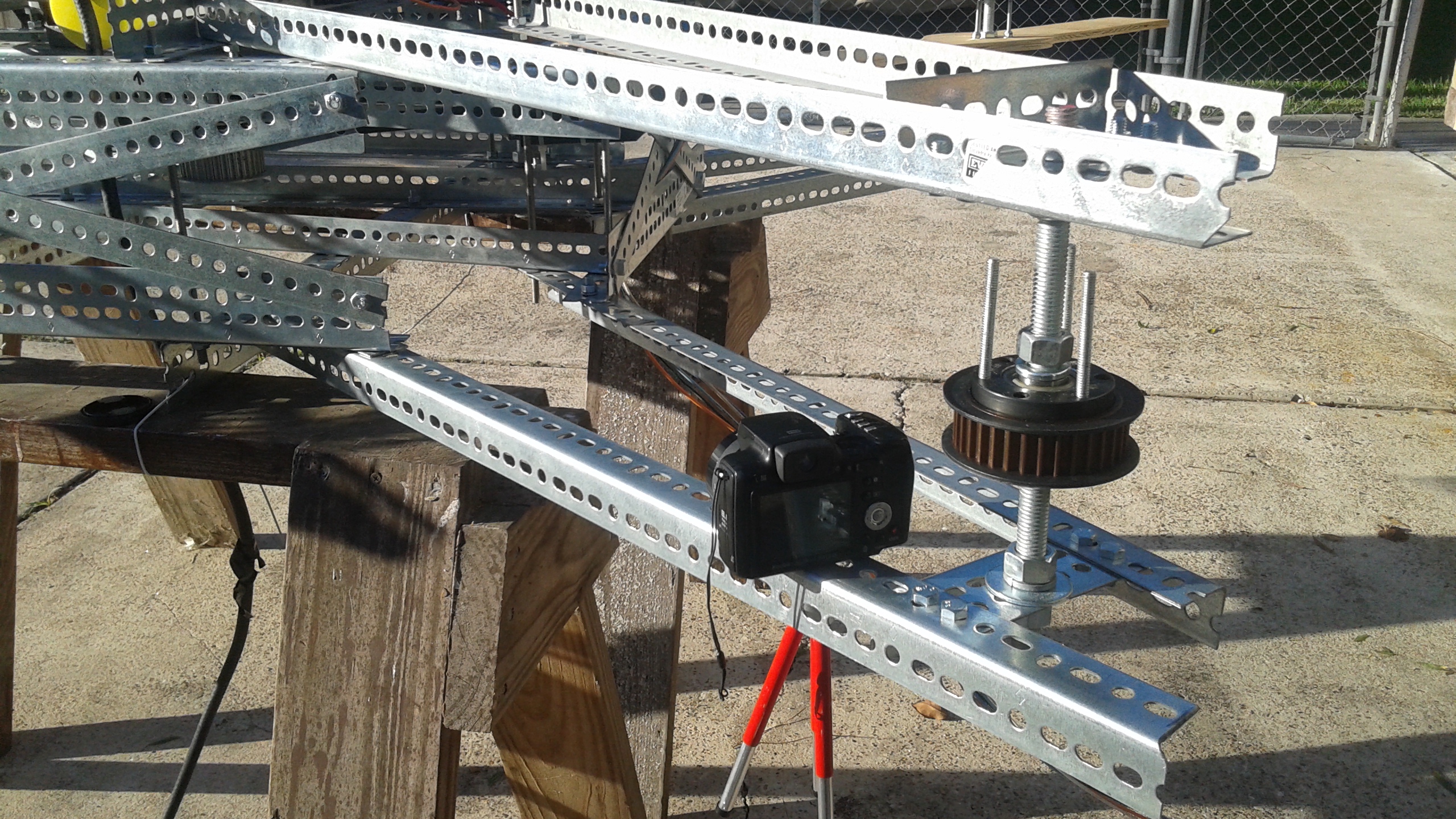

    Test 3 - Single Sided Belt only with Dummy Props, Starter Only
    This test was done on 10/6 and it went well. To get a better view of the belts, a second camera was used, attached to the frame. The belt didn't appear to oscillate.
    Below is where the second camera was mounted. I simply put the camera on the frame and screwed the mini tripod onto it through one of the slots.
    It shouldn't take too long to complete the belt guards and run the next test.

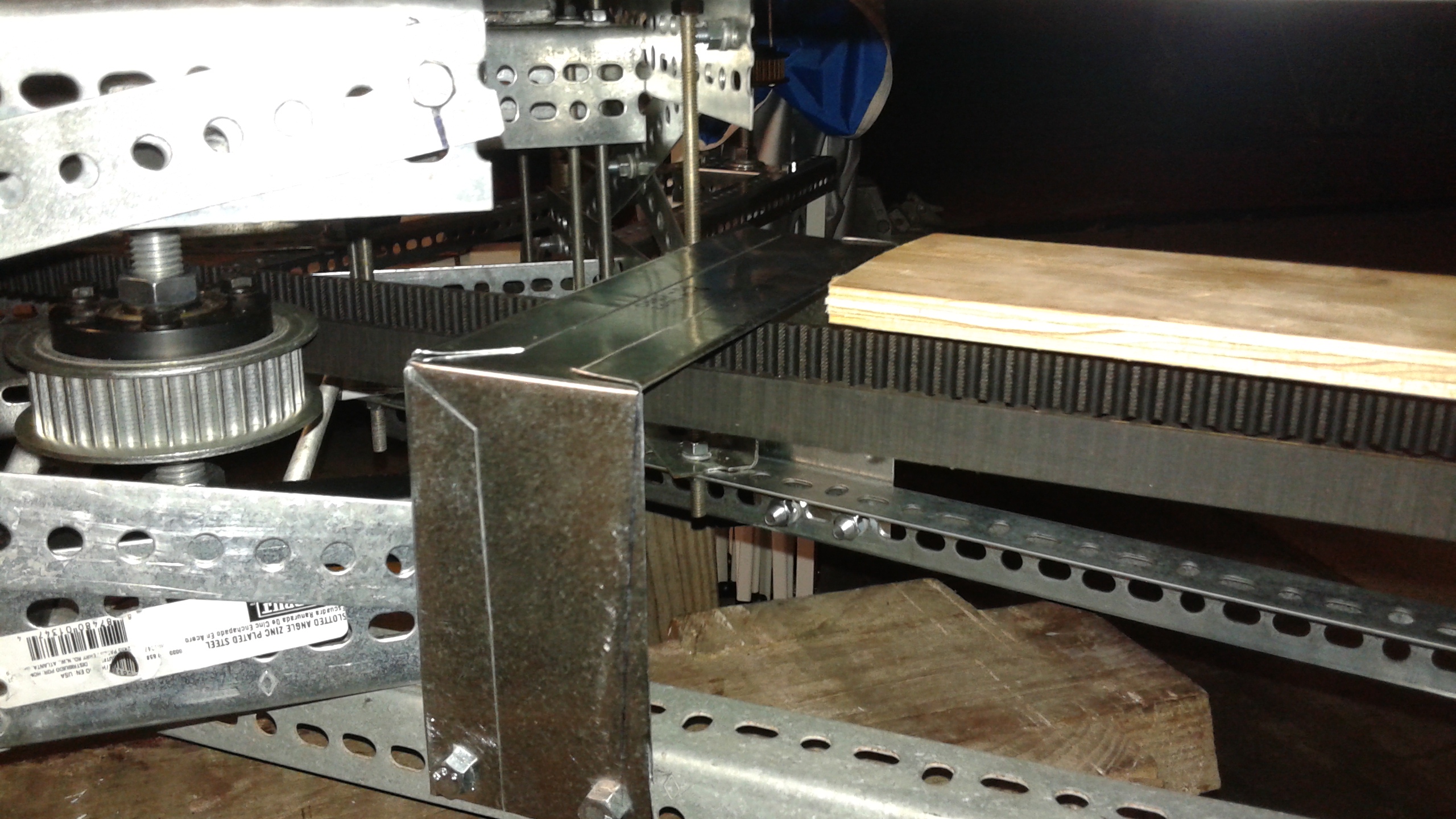

    Test 4 - Single Sided Belts only with Dummy Props and Belt Guards, Starter Only
    The last of the upgrades to address the issues from the previous round of testing are the belt guards. These are intended to keep the belt from being able to interfere with the propeller. They were constructed from a five inch wide strip of 24 gauge galvanized steel bent to shape. Last night (10/7) I completed making the first 2 and bolted them to the frame.
    On the upper surface, 1 one inch wide strip was folded over so that if the belt does hit the belt guard, there isn't a sharp edge that could cut the belt. The picture below shows the clearances. I had originally intended to have the belt guard in between the propeller and the belt around the tip, but with the lack of clearance, it seemed having it just...

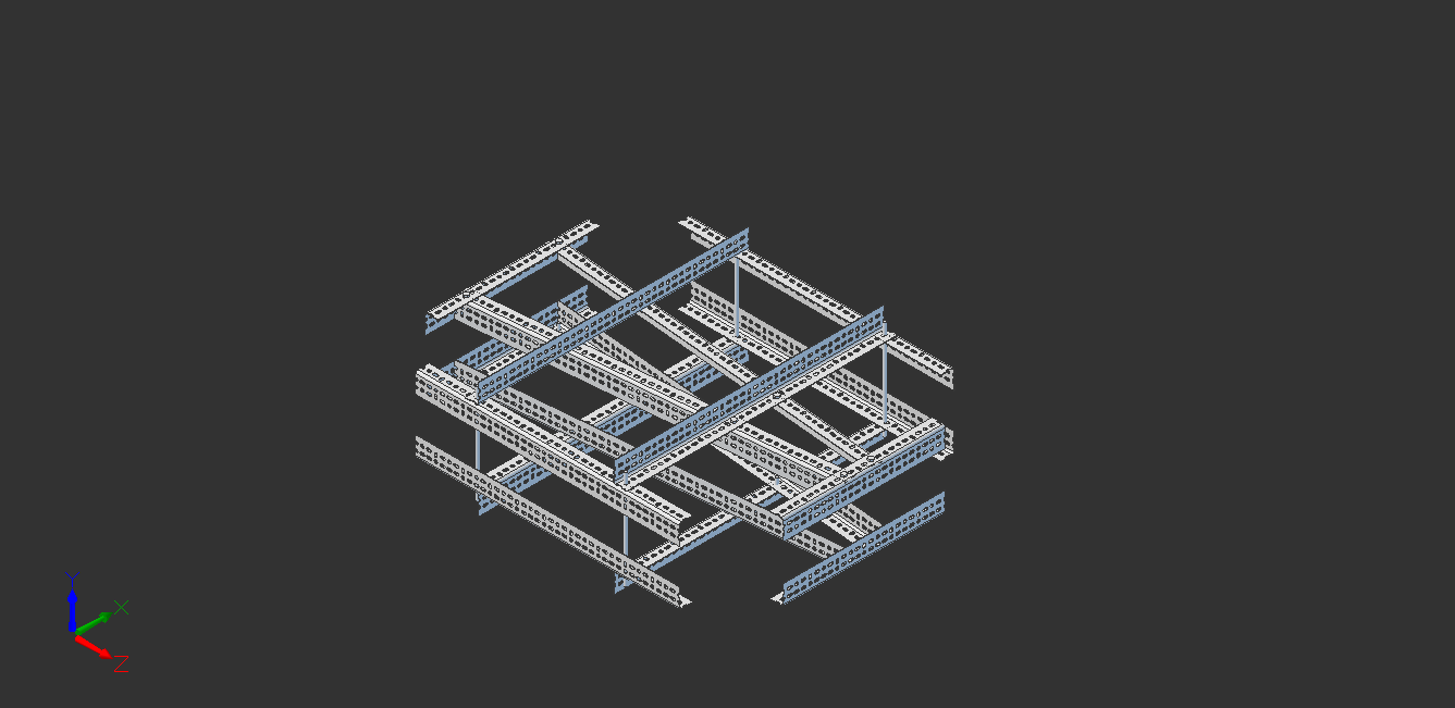

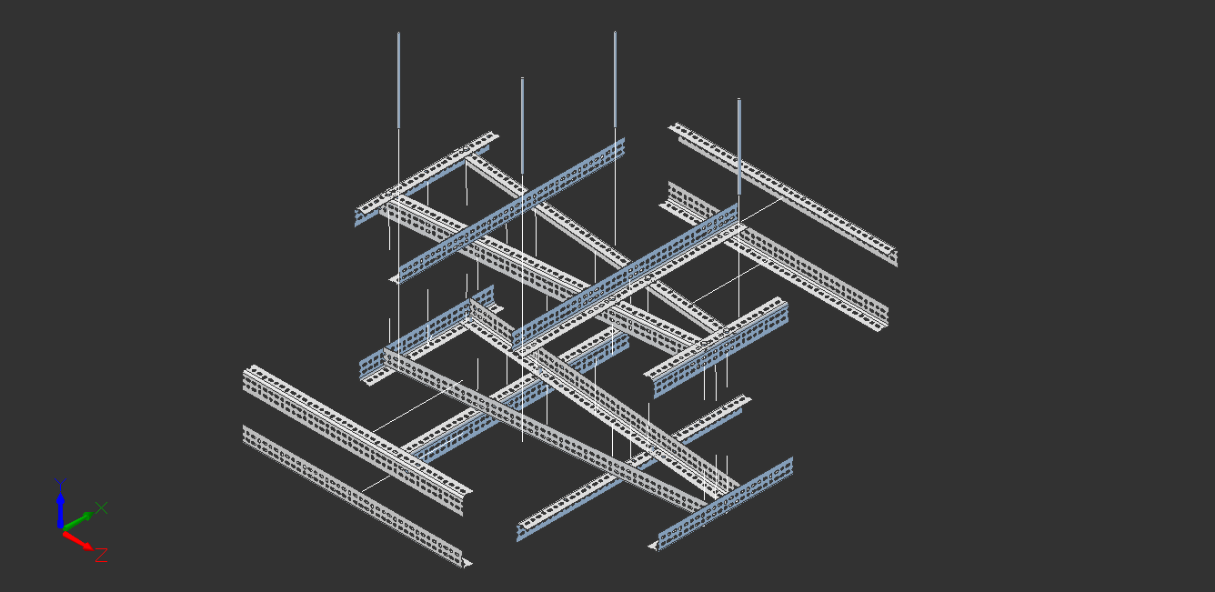

  • CAD
    15 days ago • 0 comments
    During some downtime I've been able to work further on the documentation and lately some of the CAD. I've been using Cubify Design to generate the CAD. I had tried out FreeCAD for a while, but it's still early in development. While Cubify isn't open source, it's a good balance between cost and capability.
    The github repository has the CAD that I've finished so far, mostly the frame pieces. If you have Cubify check out what's up there. Right now there is only one STEP file of the frame assembly, but more STEP files will be added as it's completed.
    Frame Assembled
    Frame Exploded View

Goliath is capable of supporting itself at the propellers. The saw horse are under the center to take up less room in the garage and allow the shop crane in and out.

John Burchim wrote a month ago null point
Peter,
using the Metal framing for your structure, do you have the ability to put an extra bend into one face of it for a second angle. It should make the overall structure much more rigid, without adding weight?
John
Are you sure? [yes] / [no]
Peter McCloud wrote a month ago null point
I have a sheet metal brake, that's in pieces. I could use it to add the bends. The current frame is intended for prototyping.
mr.nathan.richter wrote a month ago null point
wow, this is incredible. why did you choose to go with a belt drive over shaft drive?
Thanks! After researching belt, chains and drive shafts, I chose a belt system because it was light, could handle the RPM/torque I was targeting and able to handle shock loads well. If I use drive shafts I'd have to have a gear box at each propeller to change direction as well as a a larger gearbox at the engine to attach multiple shafts.

John Burchim wrote 2 months ago null point
Peter,
I noticed your framing flexed and that is with no load, you might need to add either tubing or reverse angle framing to reinforce your struts. have you considered using chains instead of belts as they tend to flex less. Also was wondering about your shaft sizes, your shafts should all be close to the same size for the torque they are receiving which should be similar.
I don't know if any of this is helpful but hope it works out for you either way.
John
I do need to fix some of the flex. I'm still debating on the best method that won't add too much more weight. The shafts for all the props are 3/4" all thread.
