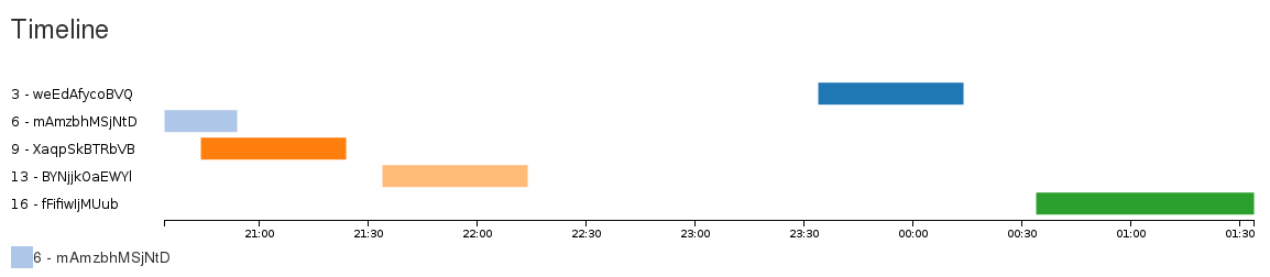

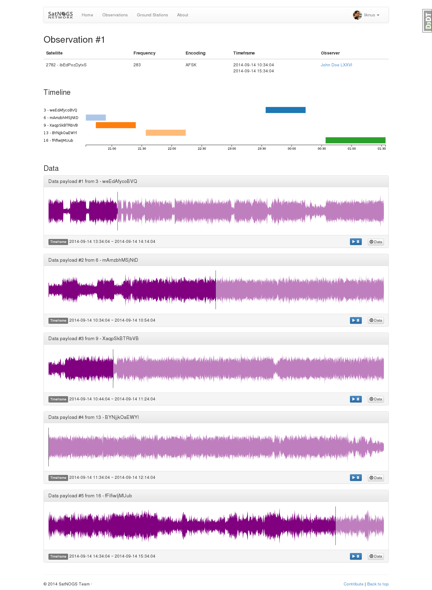

  • Observation page with data
    12 days ago • 0 comments
    Continuing the development of SatNOGS Network, we focused on enhancing the observation results page. Check out how it looks overall:
    What is new?
    Timeline
    The new timeline view gives a quick overview on the data that each ground station collected within the observation timeframe. On the left you can see the list of the Ground Stations that participated in the observation and on the right you can check the timeblocks each ground station got data. We used the nice d3-timeline js plugin for it.
    Data View
    Each data that is associated with an observation is displayed in a new panel-based section. The data we collect can be either text (decoded messages) or sound (available for further processing). We dealt with the hardest one first. We used Wavesurfer.js to visualize the waveform (HTML5, WebAudio and Canvas FTW!) and added the ability for playback directly in the browser. A download link is also available.
    The code for the implementation of the new views is already pushed in our repos. Soon we will be updating the dev instance with mock data so that you can check out the new functionality yourself.

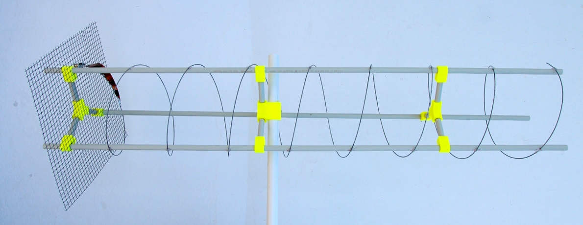

  • SatNOGS going Helix
    21 days ago • 0 comments

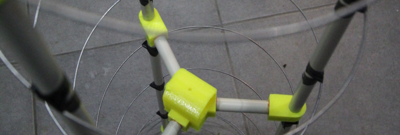

    An important part of the instrumentation of our ground station is the Antennas. Early on the SatNOGS team designed and constructed 2 Yagis for UHF and VHF bands. The UHF Yagi design was essentially a cross Yagi design trying to address the circular polarization issue. Based on the experimental operation of the ground station we were sure we can do something better.
    Satellites are tumbling and turning, thus if the transmission of the transponder is done in a single dimension polarization you better match this polarity to get the optimum gain. (if not you will loose 30dB) (check here for details). We decided that a Helical antenna would give SatNOGS a better chance for an optimal reception, so we needed to design, document and build one.
    There are a couple of theoretical models for Axial-mode Helical Antennas. Most notable are the Emerson one and the Kraus. We decided to go for Emerson, given our wavelengths, construction constrains and overall size. As we were going for UHF band 437Mhz seemed like a popular frequency for satellite communications and we centered around it. As for the circular polarization we designed a Left-Hand one (as we already had a Right-hand cross-Yagi design).
    Dimitris worked on a modular and extensible design that can be used on other bands too. 3D printed parts and off the self items is the classical recipe that we followed. The result is a sturdy and easy to construct antenna. Initial tests are showing improvements compared to our cross-yagi UHF which is a win!
    The design can be found here, bill of materials here and a detailed documentation on how to build here.
    Optimization of the antenna is crucial. We invested considerable amount of time towards that and there is always room for improvement in matching, constructions and details [1]. More NEC calculations will follow and we expect more fixes as we go.

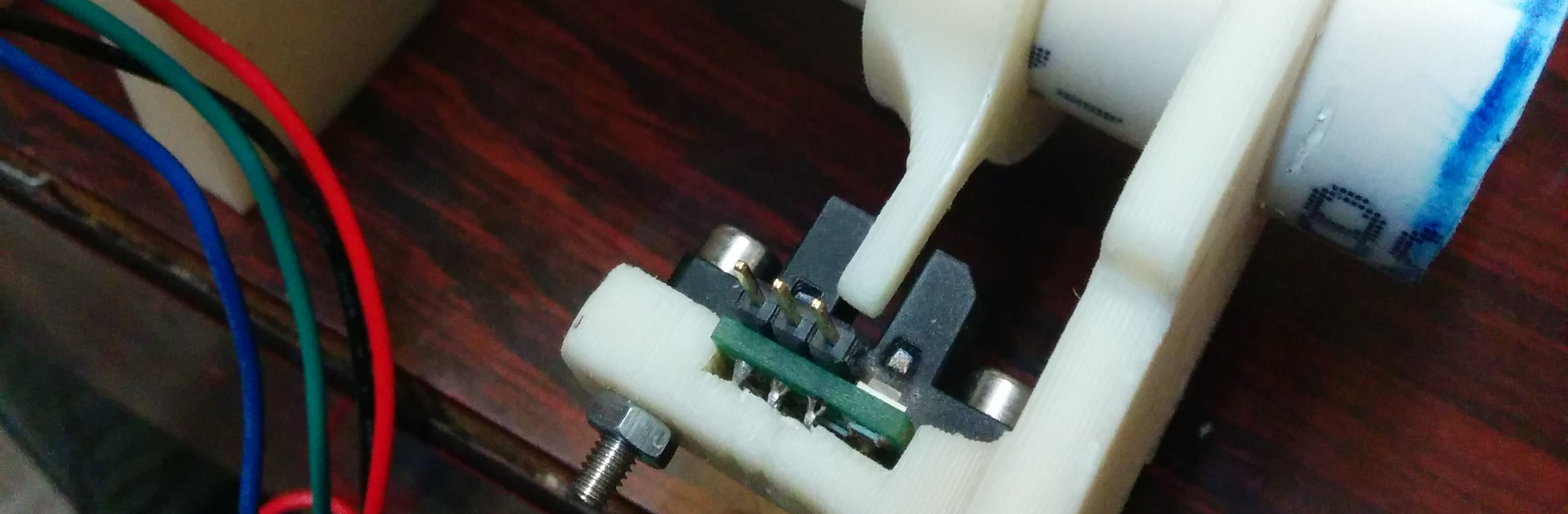

  • Axis homing tests
    Using the first version of satNOGS hardware we figured out that some times due to various reasons (software, mechanical or power malfunctions) the rotator might end up in an unknown position.
    At that point, the only way to resolve that situation was to manually reset the rotator to home position (pointing at the north with zero altitude). Therefore, since we wanted the rotator to operate without human supervision, we decided that an automatic homing system was crucial.
    At first thought we tried an IMU, which turned out to be too noisy and affected by the rest of the systems so we ended up with a pair of opto-swithes which are manually set at the first run.
    The mounts and activators of the switches are designed in a way that they remain modular and independent of the rest of the tracking hardware so that they can be fitted in previous or future versions.
    Our intention is to write two homing functions in the arduino code
    The first one, which is already written, is called when the arduino boots for the first time or after power loss. In this function, the rotator scans around the current location until it finds home position. Below you can see a video in action:
    The second one runs after every tracking job or on demand through the serial interface and just moves the tracker to the home position. This way, whenever a new traking job begins the user knows that the job starts from zero position.
    You can check the code in our repo, and the designs for the hardware too.
