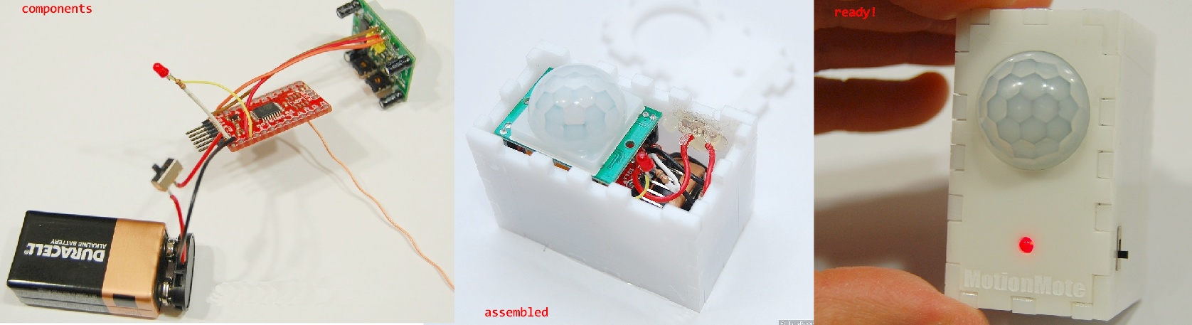

  • Motion via the MotionMote. Care to know when there's motion in your house when there shouldn't be any? Me too!

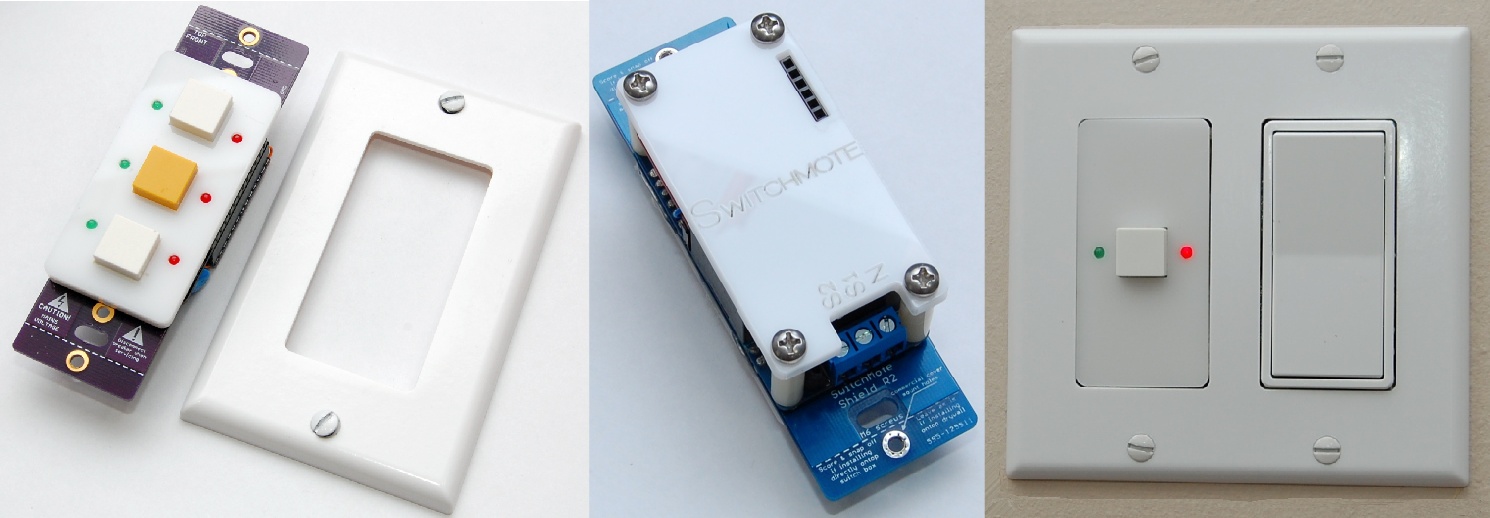

  • Lights via SwitchMote. Swap your current mechanical light switches with SwitchMotes and control your lights wirelessly in addition to the new push button. They work at 120-250V but are designed to fit US electrical boxes.

  • 1 × MotionMote and MailboxNotifier Itself a kit of several components, makes up a truly wireless low power motion sensor. https://lowpowerlab.com/motion
  • 1 × SwitchMote Kit Use a few of these to replace your traditional light switches and sync your lights or control them from the internet. https://lowpowerlab.com/SwitchMote
