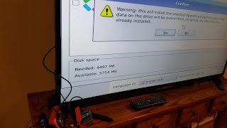

    The latest version of NOOBS was downloaded from Raspberrypi.org and copied to two 4Gb microSD cards. Spare Raspberry Pi Zeros were connected to a television, keyboard, and mouse. It was a typical installation which was made easier since the Raspberry Pi Zeros from the taggers wasn't necessary. The beauty of standard hardware was that it wasn't critical to use the exact computers during the install.
    NOOBS installation screen and two Raspberry Pi Zeros

    Adding the program to the Raspberry Pi Zeros should have been an easy task but the wrong OS was downloaded for the computers and I didn't want to learn the finer points of running all the necessary commands through a command prompt. An updated GUI OS will have to be put onto the memory cards.
    Running the Raspberry Pi for the first time

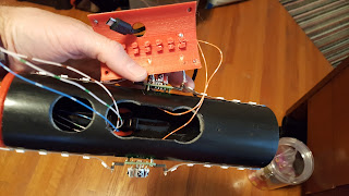

    A second tagger was assembled. A pre-wire butt stock and pre-wired forward array were added and all the wires were stripped. Wires to the reload button and trigger were connected and stripped. Everything was run to another control board with an unprogrammed Arduino. This tagger was wired with all the standard color wires.
    Tagger #2 control board
    Sensor modules were added to the sides of the tagger. The holes had to be drilled out since the available screws were too large. This broke one of the traces so that had to be repaired with some scrap wire. The next revision of the sensor boards should accommodate larger screws and the next time these boards are used, the correctly sized screws should be available.
    Sensor board mounted on tagger
    A short video was taken with a probe camera as it was pulled through the inside of the tagger. This doesn't prove anything or serve any purpose other than it was kind of neat to see inside the tagger while it was assembled. The video is approximately forty-one seconds long.
    Internal tagger video
    The assembled taggers were placed together for a quick photograph. With two taggers, it will be possible to conduct an actual game with real equipment.  The newly assembled tagger is near the top of the picture.
    Two wired and assembled taggers

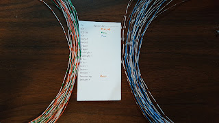

    A standard color code card was made in Google Sheets. This was a simple reference sheet to record which color wire went to each terminal. It was revised from the first edition which didn't have enough spaces for every wire and some other shortcomings. The picture shown below is the most standard arrangement of colors I can make but it will not be used on every tagger.
    Color code card with standard colors documented

    Wires attached to the light rings were too short in most of the cases. This was an error in judgment on my part from moving through the project too fast. The previous wires also had no consideration for color coding, another lapse in judgment.
    New wires were cut, this time they were measured against the tagger pipe to ensure they would be long enough. Enough wire was cut so that each tagger could have the same color coding.
    Wire and color code

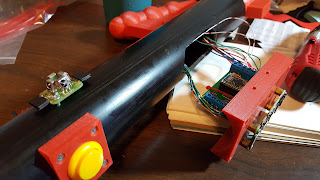

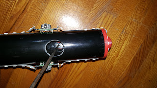

    The trigger switch was installed and while wires were being connected, it became apparent that the trigger and controller board would not fit together inside the pipe. Bummer.
     Switch in the controller space
    Parts from the short tagger were moved to a regular-sized tagger. A different switch plate was used since the new tagger was drilled with a small hole. The print was snug so the switch had to be twisted into place. Perhaps the goal should have been to make the adapter as a threaded nut instead of a plate which could be glued. A screwdriver was used to try to press the switch into place but it was not effective.
    Installing a switch, poorly

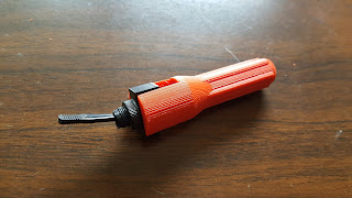

    The evening was spent creating a wrench (spanner) which could properly install the switch by twisting it. The majority of the device is a long handle with grips while the bottom should surround the switch snugly and allow it to be turned from outside the pipe.
    Switch wrench
    A print of the switch wrench was printed. It was printed on it side so the printer filament strands would reach from the handle to the tool. For a good explanation, watch this video by Christoph Laimer.
    Captive switch

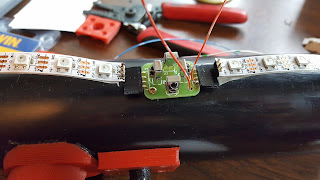

    A wire from the sensor board was soldered to the output pin for infrared signals. A sensor board was mounted to the tagger with two #2 (M1.5) screws at opposite corners. Each screw hole into the tagger was given a pilot hole. A third hole was drilled for the sensor wire to reach the inside of the tagger.
    Mounted and wired sensor board
    The board did not sit nicely against the round pipe. Tightening the screws drove the component leads into the pipe but it seemed sturdy. Since the light strips sat high off the pipe, it was difficult to attach them with the adhesive. Perhaps the next model of sensor board should have solder pads which can attach directly to the strips. It would also be possible to model a piece which would act as an adapter for the sensor board and pipe and even provide a ramp for the LED strips.
    Fastened sensor board
