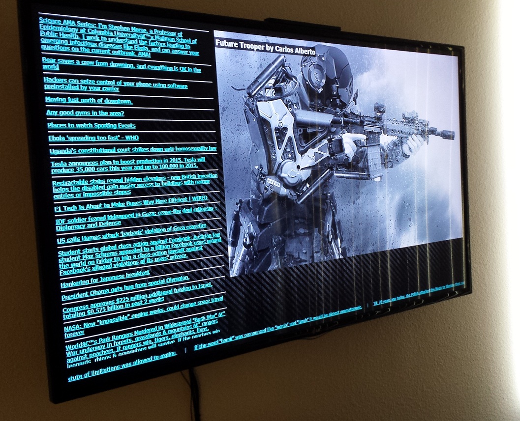

The central server talks with the nodes either over Wi-Fi or off-the-shelf RF interfaces. Most of the core software runs here. It contains:
A web interface and database (really an ASP.NET page with a static dictionary, but it works the same way)
A windows service that mediates all of the various communications
Speech recognition using SAPI and some microphones hidden behind the couch
It talks to two Arduinos over USB. Those handle the outlet switches, RF, and living room blinds.
An AutoHotkey (I know, right?) script that triggers the morning and evening routines.
Other nodes are the TVs, a couple old androids running the unity app, and a spark core that deals with detecting the switch state.

    In preparation for the final submission deadline tonight, I wanted to talk about some of the most recent changes I've made to the platform:
    First: I have re-factored the database to pass results back either as a simple string or as JSON, instead of as javascript. This made the code across the board much more legible, and let me make the daemon a lot more sophisticated without a ton of text parsing
    Second: I added TCP bulbs and the blind minder into the final build. The TCP integration is described in the GitHub repository, and the blind minder is in the build log.
    Third: I created an AutoHotkey script to run a proper good morning and good evening routine (along with some new dashboards to go with them). That should also be in the repo.
    Fourth: I cleaned up the interface look and feel to fit more with the modern aesthetic of the rest of the apartment. The Tron nods are more subtle now (except for in the mobile app), but I think the system looks better for it.
