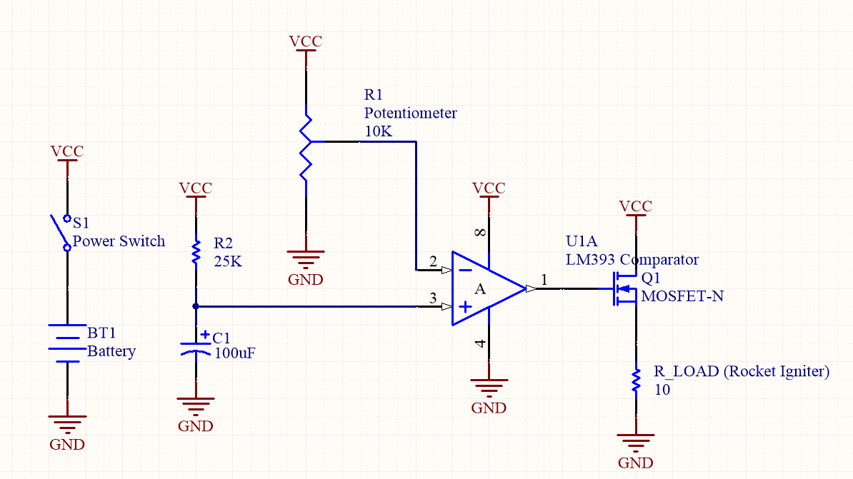

    Meanwhile while Neel is working on the rocket, I am working on some safety precautions. In order to keep us from getting electrocuted, I figured it would be advisable to be far away and in a safe place when the rocket launches. In order to do this, I whipped up a little RC timer that should give us a 5 minute count down before igniting the rocket fuse, letting us retreat to a safe location. This whole circuit is easy to make and will cost only ~$2, so I have no problem with it getting destroyed, assuming we actually do catch a lightning bolt.
    The circuit is very simple, but I figured I would post a schematic anyways, just in case anyone is curious:
    The idea is that we will hit the switch when we are ready to launch. We will have about 5 minutes (this time is adjustable with the potentiometer) and then the LM393 comparator will switch high, drive the mosfet and cause the rocket to ignite.

Eugene wrote 5 months ago null point
If I understand your timer circuit correctly, when the cap charges to the voltage that is set by the pot the output of the comparator should go "high" to turn on the n-channel fet. The LM393 is an open collector output and will not source current to turn on the fet. I would recommend adding a resistor from the gate to VCC.
