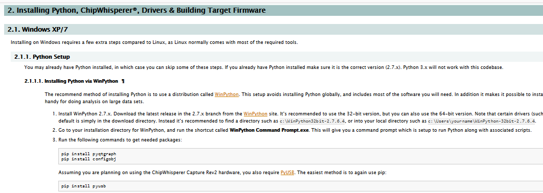

There are several main sources of documentation:
  1. Full Project Documentation: This is the major documentation, and includes both python API documentation, along with detailed instructions for installing python modules, using the hardware, etc. This documentation aims to be a polished resource.
  2. The Wiki: The wiki contains additional detail such as most recent releases, instructions for building hardware, BOMs, various small notes, and example traces. This aims to be a 'living' documentation so is subject to frequent changes, and has many short and simple pages such as PCB errata.
  3. Presentations & Whitepapers: There are a number of presentations I've previously given. The link to the left includes a few of the earlier Blackhat presentations, which have a long whitepaper too!
  4. Videos: I've got several hours of video tutorials. See the full list later on in the 'video' section of this document.
  5. The GIT Repository: Some people believe code is self-documenting. I've tried to help it along with docstrings and whatnot, but the GIT repository is the ultimate source for all things about this project.
