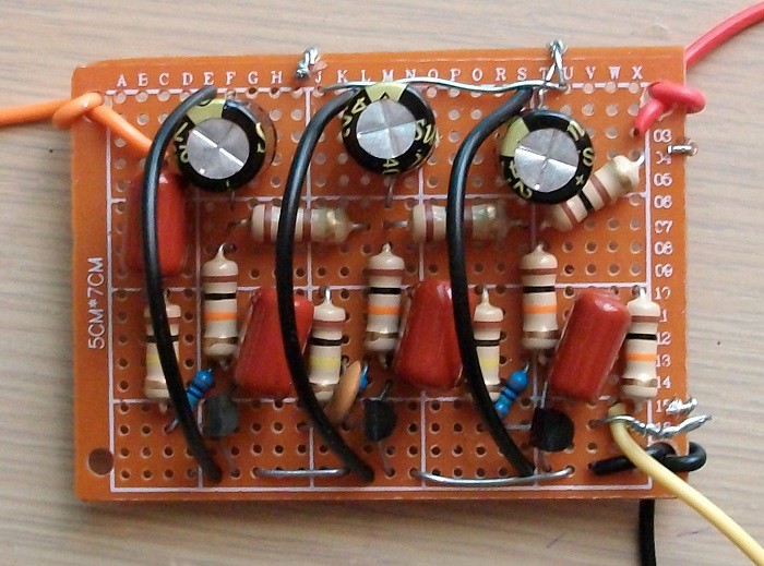

    I made this circuit with BC559 BJT (Bipolar Junction) PNP transistors.
    The only difference between BJT NPN and BJT PNP transistors is the direction of current conduction.
    You can use the following NPN transistors:
    - BC337, 2N2222, PN100
    PNP transistors:
    - BC327, 2N2907A
    I included a small orange ceramic capacitor (about 10 nF) for the second transistor amplifier to filter high-frequency noise.

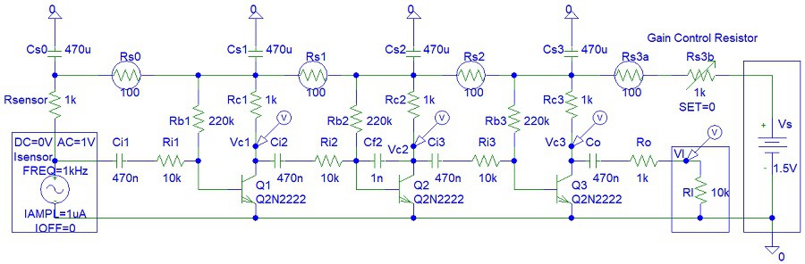

    Step 1: Design the Circuit
    I have drawn the circuits in PSpice simulation software student edition version 9.1:
    My circuit is useful for microphone and Line In amplification, will cost less money, and will last longer because I increased the resistor values to reduce the power dissipation.

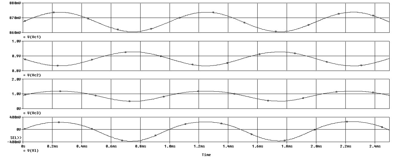

    Step 2: Simulations
    I used the old PSpice software to simulate the circuit.

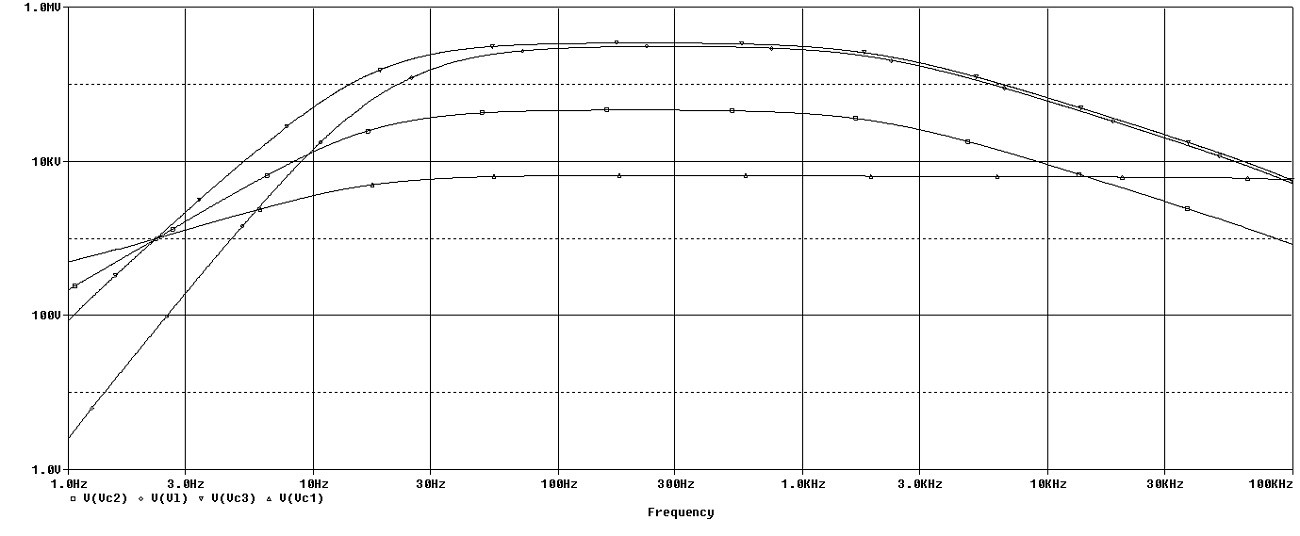

    Frequency domain simulations:

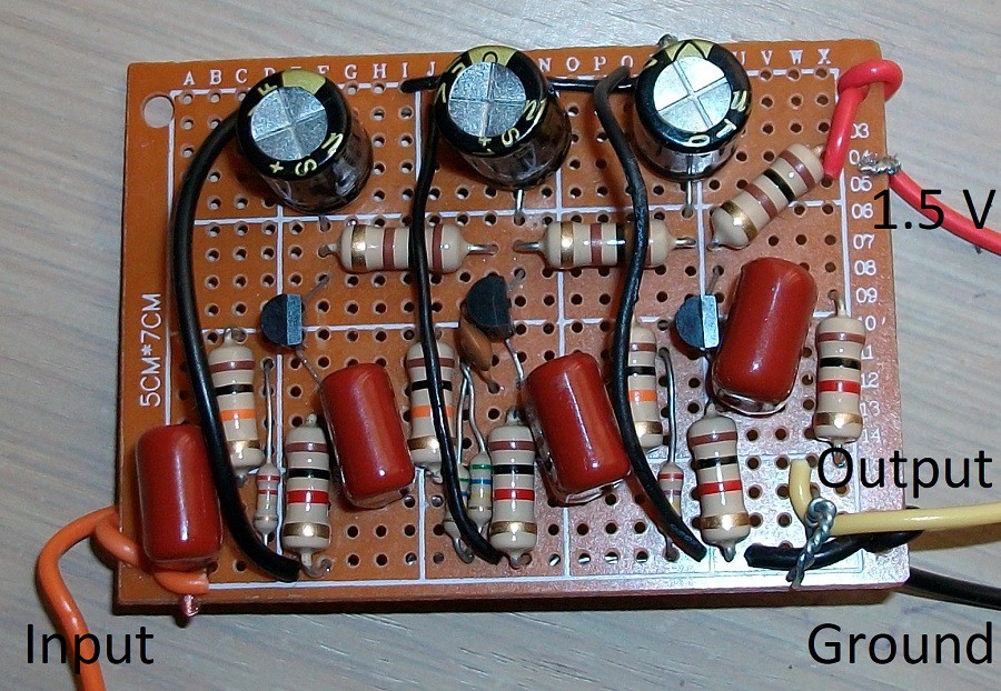

    This photo is showing my transistor amplifier made with BJT NPN transistors:
    I increased the Rc values to 10 kohms. I used a USB oscilloscope to test my circuit. Increasing the Rc values has increased the circuit gain but reduced the bandwidth to just 1 kHz due to transistor stray capacitance. I included a small orange ceramic capacitor (about 10 nF) for the second transistor amplifier to filter high-frequency noise.

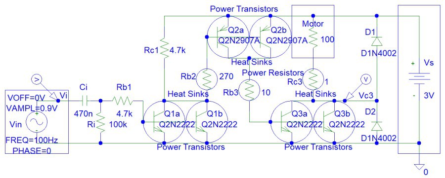

    I have drawn the circuit in PSpice student edition version 9.1 software:
    Calculate the maximum output current at worse case scenario. At worse case scenario transistor current gain, Beta = 20.
    Ib1 = (Vin - Vbe3) / Rb1 = (3 V - 0.7 V) / 4.7 kohm = 2.3 V / 4700 ohms = 489.3617 uA
    Ic1 = Ib1 * BetaMin = 489.3617 uA * 20 = 9.78723404 mA
    Ib2 approximately equals to Ic1 because very little current is flowing through Rc1 resistor.:
    Ic2 = Ic1 * BetaMin = 9.78723404 mA * 20 = 0.19574468085 A
    Ic3 = Ic2 * BetaMin = 0.19574468085 A * 20 = 3.91489361702 A
    Rc3 is 1 ohm and the transistor does not need to saturate. The maximum current is actually not 3.91489361702 A, but Vs / Rc3 = 3V / 1 ohm = 3 A < 3.91489361702 A (occurs when the motor is a short circuit if its movement is mechanically impeded or stopped), because the transistor saturates. However, you can achieve 3.91489361702 A output current if you raise the supply voltage to 4 V.
    Now we can calculate the other resistors.
    Rb2 = (Vin - Vbe2) / Ib2Max = (3 V - 0.7 V) / 9.78723404 mA
    = 2.3 V / 9.78723404 mA = 235 ohms < (Rb2 || Rc1) = (270 ohms || 4700 ohms)
    Rb3 = (Vin - Vbe3) / Ib3Max = (3 V - 0.7 V) / 0.19574468085 A
    = 2.3 V / 0.19574468085 A = 11.75 ohms approximately 10 ohms
    Rc1 and Ri resistors ensure that the circuit and the motor is OFF when the circuit is disconnected or when no input signal is applied.

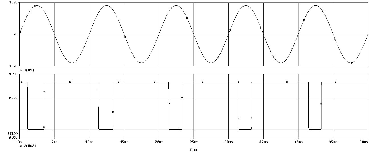

    Step 2: Simulations
    Simulation show high circuit gain:
    You can see that the output transistor (Q3a and Q3b pair) is still saturated even when the input signal is only 1 V. Thus the minimum input signal is 1 V.
