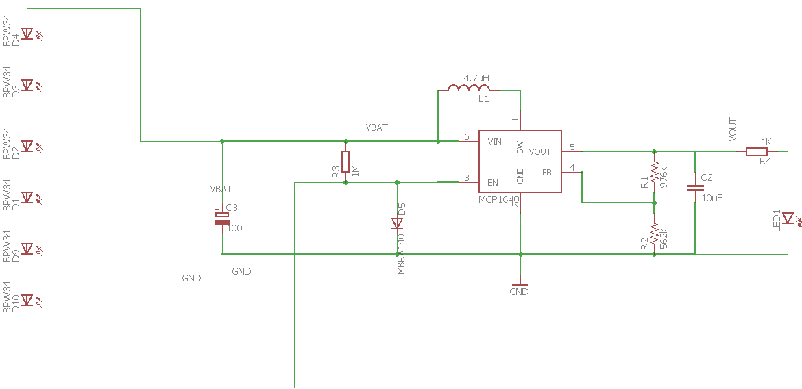

Features:
- 6x BPW34 photodiodes aka solar cell
(plastic diodes, more resistant to damage against glass solar cell)
- Up to 20F supercapacitor
(You can use bigger capacity but 20F is optimal for charge in one sunny day)
- 4 hours operation in night depends on intensity
- Auto night on
- Step up converter effective use all stored energy, discharge scap until 0.3V !!!!!!
- Output is activated in night
Supercapacitor is charged via Schottky diode,  this current also disable step up booster,
In night or if it lose power booster is automatically started and very effectively discharge
supercapacitor and convert almost all stored energy because can work until 0.3V

Bgwiz wrote 06/21/2022 at 22:26 point
In your Schematic I see a 10uF capacitor on the output but it is not listed in the BOM/Components.
You also have 4 resistors shown in the Schematic but only three in the BOM/Components.  Is R3 needed?
bobricius wrote 06/23/2022 at 21:49 point
yes
Bgwiz wrote 06/21/2022 at 21:35 point
I see that the MCP1640 comes in 4 flavors - MCP1640/B/C/D but neither the BOM(Components) nor the Schematic is clear as to which one it is.
The image with it showing has CJKK for the marking (great pictures!), but the MCP1640 datasheet only shows that package being marked with a Bxxx (Page 21).
Are you using the MCP1640T-I/CHY, MCP1640BT-I/CHY, MCP1640CT-I/CHY, or MCP1640DT-I/CHY?
bobricius wrote 06/23/2022 at 21:51 point
No idea, found in my old inventory last 5pcs. currently worldwide sold out. I go to redraw to MAX1724
zanzeoo wrote 06/19/2022 at 09:45 point
Sorry , but i'm a bit confuse about the theory of this schematics , i may be wrong but how can you charge a 10F in less than 24 hours with such current ?. According to the datasheet BPW34 source only 50µA ? . Can you explain more your theory . Because i found a total charge in 4days. Thanks
bobricius wrote 06/19/2022 at 21:35 point
short current from BPW34 is about 4mA, it can charge 20F in sunny day without problems.
zanzeoo wrote 08/04/2022 at 16:14 point
OK, can you tell me more about R3 , are you charging the cap throught it ? 1M ?
Is the cap is 100 or 10 Farad , How long last the led ?
zanzeoo wrote 08/04/2022 at 16:27 point
How does flow the current from the solar led , From K to A ?

Luís Carlos wrote 04/30/2022 at 21:09 point
A beauty PCB :)
Why D5?
bobricius wrote 04/30/2022 at 21:13 point
through D5 is capacitor charged and also disabling power supply booster
