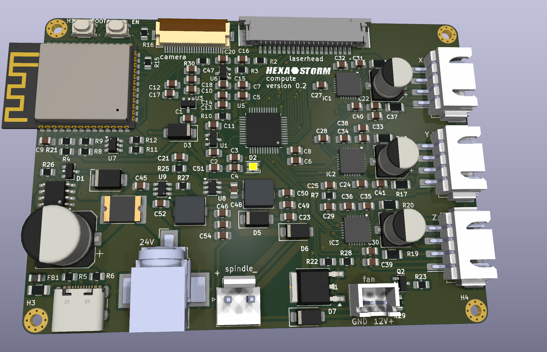

  • Main board design
    Hexastorm02/16/2024 at 10:31 0 comments
    I envision the development kit consists out of two components;  a laser head and a main board.
    This post sheds more light on the main board.
    The main board can be programmed and powered via USB C. These are two "regular" USB 2 connectors. The CH224K chip is used to request 12V from the power source. The main board uses a ESP32 S3 and connects to the laser head via USB C 3.1.
    This is not a regular USB C connector. In an ideal world, you could connect to the laser head with USB C using your laptop.
    I am working towards this, and therefore I am starting to support USB C 3.1. I will share more details on this in the future.
    The main board features three stepper drivers, to move the laser head. Angled pin headers are used to connect to the end stops and stepper motors. A micro SD card reader is present for additional storage. The ESP32 S3 already provides 32 MB storage, so this should not be needed. The black box is AK-NW-84 (100x67x22m) and can be found online.

  • ESP32 binary to interact with FPGA
    Hexastorm11/03/2023 at 16:30 0 comments
    I am able to make a binary on the ESP32 which can program the FPGA using Fomuflash and initialize the stepper motors via the TMCStepper library.
    The controller.py class of Hexastorm can be imported in Micropython.  Procedure to make binary is here.
  • Update
    Hexastorm10/20/2023 at 17:38 0 comments
    Most people here are probably waiting for an exposure with a PCB motor.
    I decided, however, to focus on finalizing the PCBs and porting the software to the ESP32.
    I created a main board.  The board is built around an ESP32-S3-WROOM-2. I use a USB C connector, but pull 12 volt from a different source.
    I removed the micro-SD card, I used in an earlier design. The ESP32-S3-WROOM-2 has 32 MB onboard memory which should suffice.   Steps for the stepper motor are generated via the FPGA from the laserhead.  The laserhead connector moved from 15 pins to 20 pins.
    The main board is shown below
