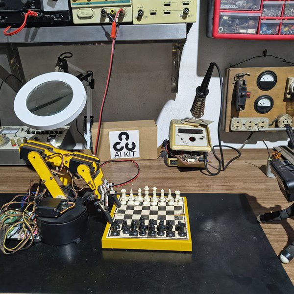

The Hardware Legacy
I am reusing my previous hardware platform. It's a proven "testbed":
- Structure: Laser-cut carbon fiber sheets. Lightweight and high rigidity to reduce inertia.
- Actuators: Futaba servos controlled via a PWM expansion shield.
- Controller: Raspberry Pi 3 (ARM architecture).
- Vision: Luxonis OAK-D stereo camera for spatial mapping.
