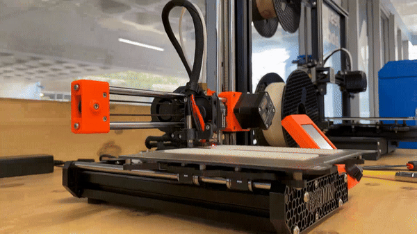

- Access to a 3D printer (if you don't have your own, check with your local library, or college. I used one at a makerspace at my University)
