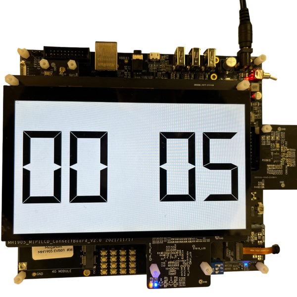

    3. Set the BOOT Switch
    The SP2301 Linux EVB is equipped with a BOOT mode selector switch that determines the startup source.
    Set the BOOT switch to SD boot mode. This instructs the board to load the Linux OS directly from the SD card during startup. There is no need to manually flash internal storage or run additional setup commands.
    4. Power On the Board
    • Connect the SP2301 Linux EVB to a stable power source using the DC input (9V to 36V).
    • The board will detect the firmware on the SD card and automatically boot into the Linux operating system.
    • Indicator LEDs will confirm power and activity status.
