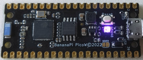

    3. Connect the development board to the computer via USB, and a disk named CIRCUITPY will appear on the file management page of this computer, which is the disk in CircuitPython mode. Double-click the Reset button on the development board to change it to a disk in UF2 mode. The following are the specific steps.
    1. Quickly press the Reset button once.
    2. Quickly press the Reset button again when the purple light is on.

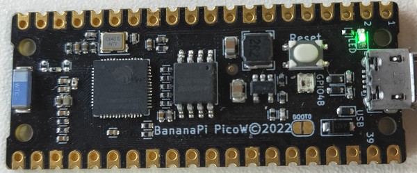

    3. The sign of a successful trigger is that the Colored light turns red after a moment to a long green light. If you don’t get this result, you can retry the first two steps.
    4. The disk name in UF2 mode is UF2BOOT, copy the .uf2 firmware downloaded in step 1 to this disk, the colored lights will flash orange during the process, do not disconnect or do anything with the board during this process.
    5. After the CircuitPython firmware update is complete, it will automatically reset, and a new CIRCUITPY disk will appear on the file management page of this computer. You can view the specific firmware version via the REPL.
