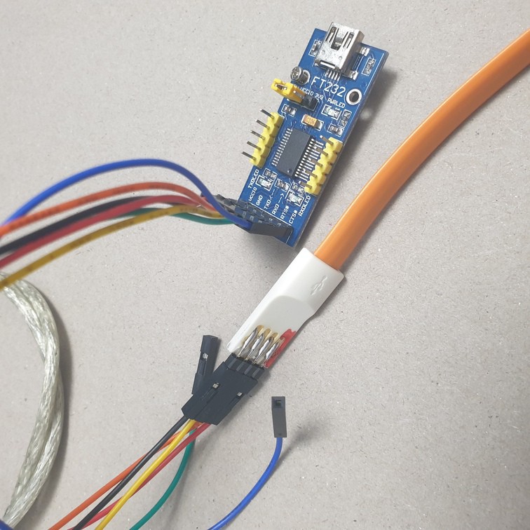

Here I found how to make a cable for programming my BF-T1:
Connect the radio to the PC through a FTDI board.
