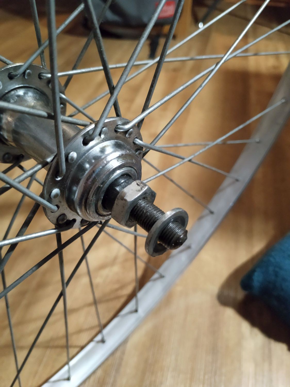

I found a nice used pair of wheels at a flea market, for a good price of 25€. It is a standard pair of 28"-wheels: The axle width are 100mm (front width) and 130mm (rear width). The wheels should be appropriate to almost any of 1980...2000s bicycles. The rear wheel has also the wanted thread for a 5- or 6-gear sprocket wheel cassette (cogset), a perfect match to METEOR and exactly what I've searching for as a replace for the heavy-weighting 3-gear Sturmey-Archer hub.
Front wheel from flea market, unmodified (wide nut)
Less funny was the realizing the wheels are not matching into METEORs frame. Its fork width was 90mm, the rear width 120mm only. I haven't noticed that before and no clue what to do now.

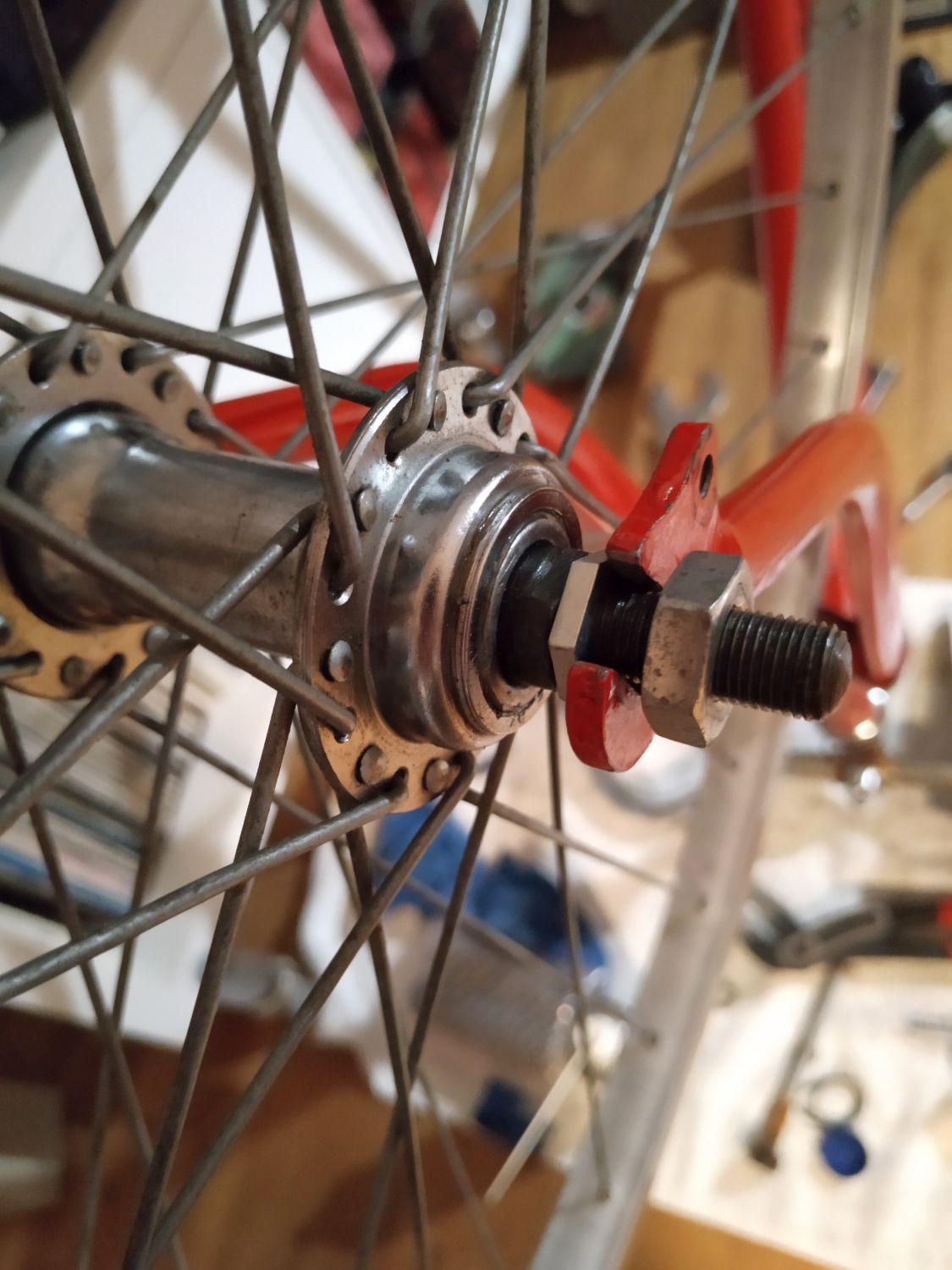

OK... the flea market wheels do have FG9,5 (Fahrradgewinde 9,5mm) = Bicycle thread 9,5mm) axles. Matching parts can be purchased at ebay, fortunately.
Rare narrow nut. 'Auslaufteil' means: No new manufacturing, remainder of stock
Front wheel, respacered, with special FG9.5 narrow nuts applied

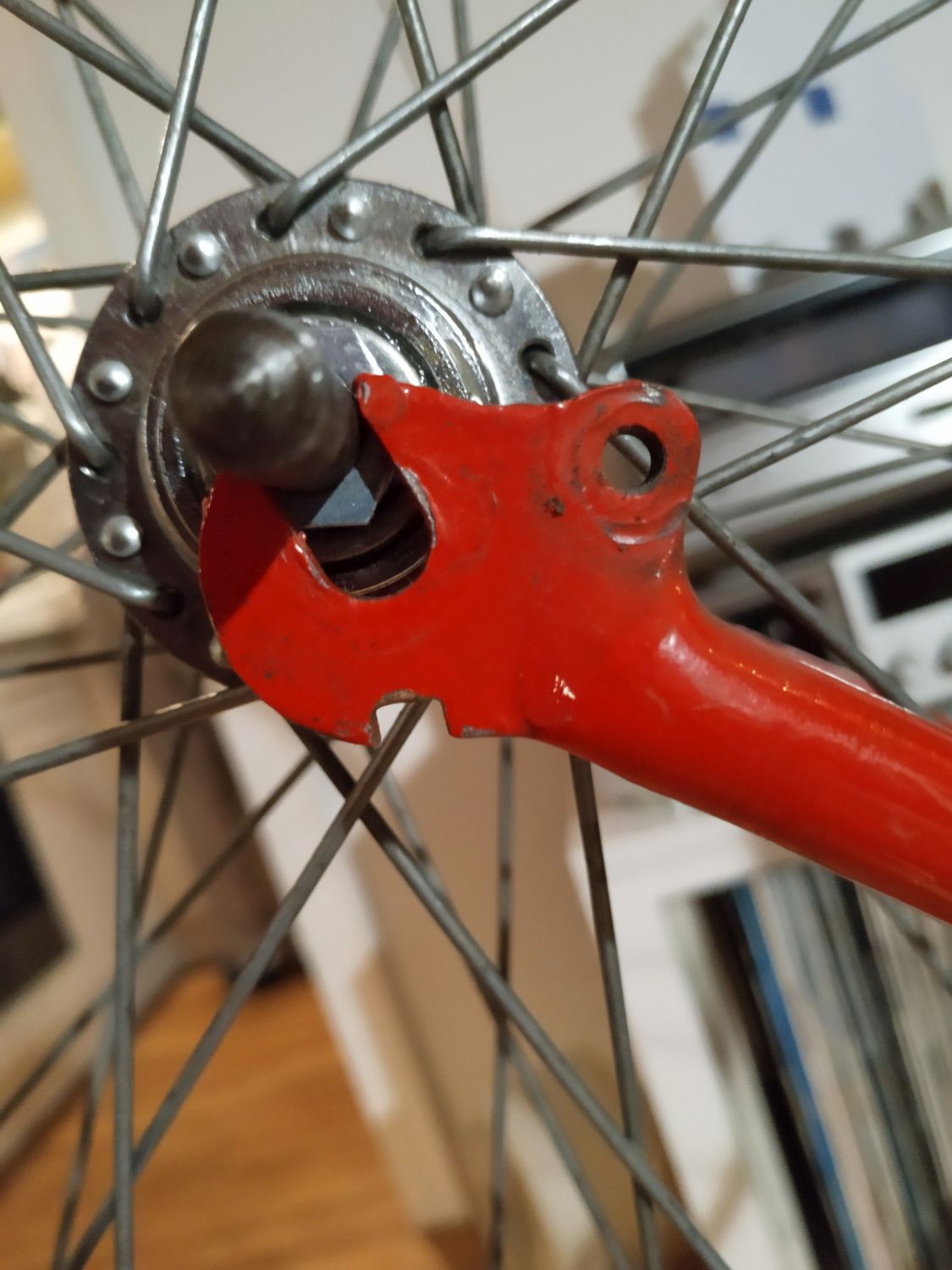

Result: The axle width is now mathing with the frame, but I had to file the front wheel axle clamp from 8.5mm to 9.5mm to fay:
Original clamp size was 8,5mm while axle diameter is 9,5mm...
Proper filing - done well    :-D
