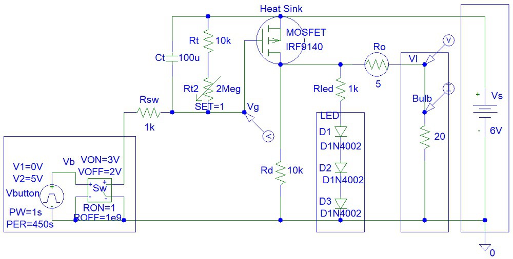

I drawn the circuit via old PSpice simulation software:
Calculate the time that the lights will be one after the button is released:
Time Constant = Ct*(Rt1 + Rt2)
= (100*10^-6)*(2,000,000+10,000)
= 201 seconds
This is a very approximate value because it depends on the specified value of the gate source voltage threshold that will turn ON or turn OFF the current flow. Lower gate source voltage ON threshold will keep the lights ON for longer. You can check the datasheets for minimum and maximum values.

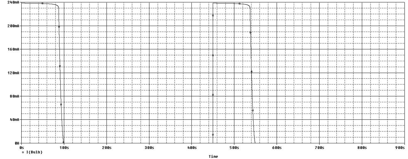

Step 2: Simulations

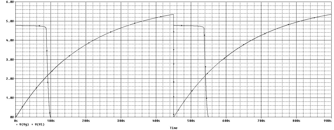

Voltage simulations:
When the transistor gate source voltage (Vs - Vg) falls below 4 V  (6 V - 2 V), the current stops flowing from source to drain. You can see that this period if 100 seconds and not 200 seconds because the transistor turns OFF before the first time constant:
Vg (First Time Constant) = (Vs - Vs*exp(-1))
= (Vs - 0.36787944117*Vs)
= 6 V * (1 - 0.36787944117)
= 3.79272335297 V > 2 V
Load (light bulb) current simulations:

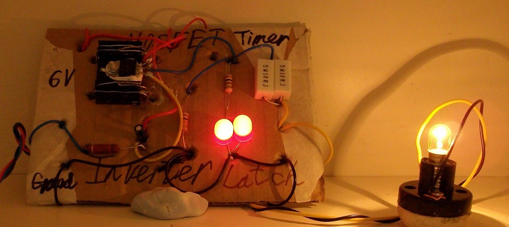

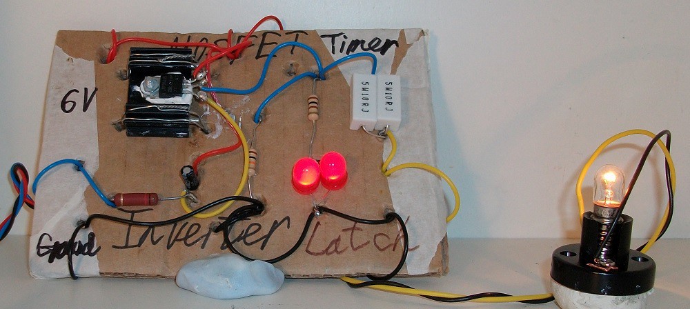

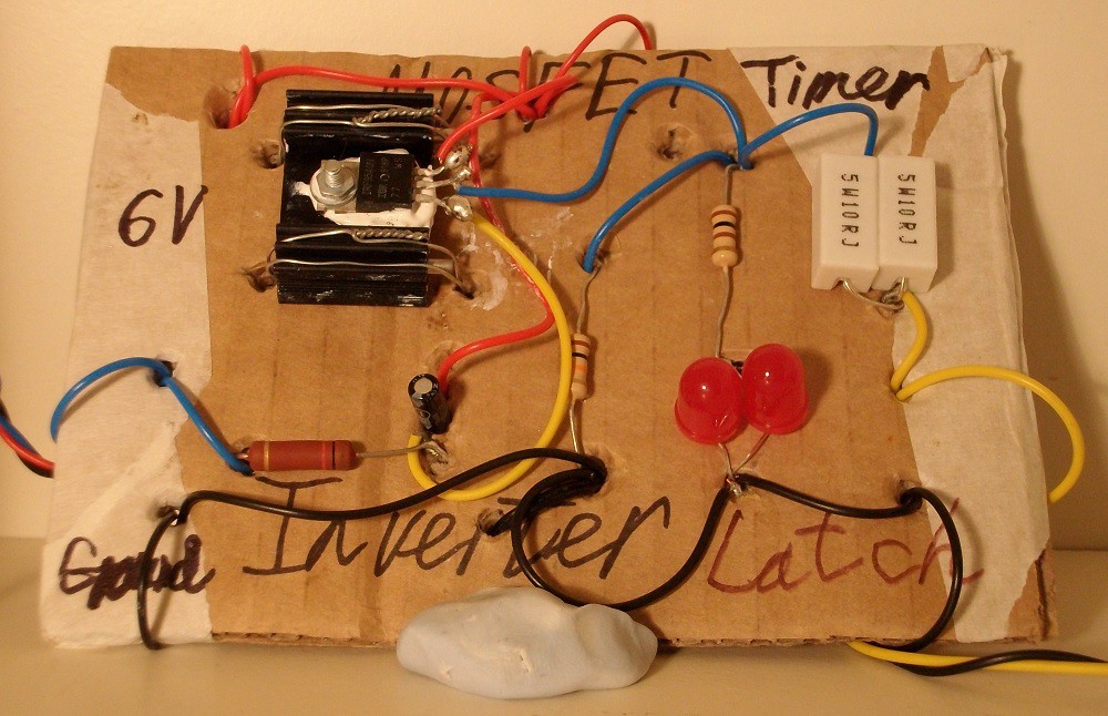

Step 3: Make the Circuit
I used a 47 uF capacitor instead of 100 uF capacitor. Do not use capacitors above 100 uF of the LED might take a long time to turn ON:
I also did not connect the timing resistors to keep the light ON longer. Because the input resistance of MOSFET is a few giga-ohms, the MOSFET will take a long time to discharge the capacitor and turn OFF the LEDs if Rt resistors are omitted.
Step 4: Attach 6 V Battery Holder
I attached a 6 V battery holder. The circuit might work with 4.5 V minimum because some MOSFETs do not need high gate voltages to turn ON.
Step 5: Testing
In the video I connected the blue wire to positive end of supply to discharge the capacitor and turn OFF the LED and light bulb.
