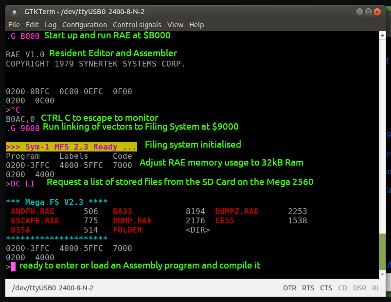

The above shows the entry into RAE from the Sym-1 monitor command. The monitor prompts with a simple ".", very modest!! Entry to the RAE begins at $B000, and the extension MegaFS code is triggered by a CTRL-C to the monitor and .G 9000. This links in three RAE Disk Commands, quietly embedded into the original RAE program as vector locations for future expansion to a disk based filing system. After all these folk were very forward thinking and designed versatile systems, so why not? None of the Apple II style detecting characters in the screen and keyboard streams to trigger its DOS commands. Changing these vectors after the main program was initialised allows them to be automatically redirected to use my extension code. (RAE commands generally only require the first two letters of a word, the rest is skipped over eg EN and ENTER are the same command, the TER is redundant).

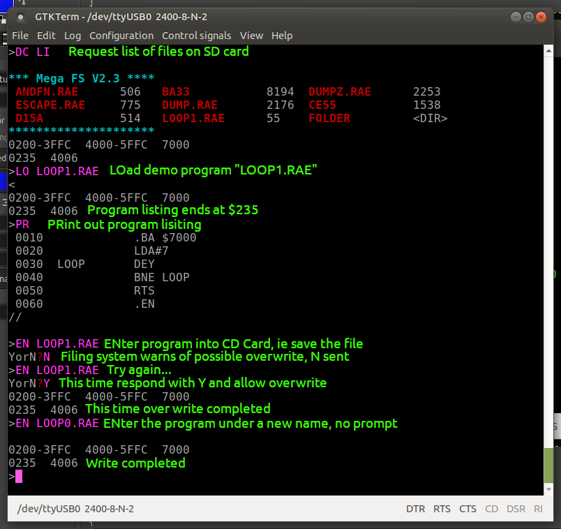

DC (Disk Command) : There are two variations to the DC command. The LI variation is shown above "DC LI" and it simply returns a listing of the file names and their sizes on the SD-Card. The Arduino SD library is used extensively in this design, and basically does all the heavy lifting in managing the files on the SD-Card. Amazing stuff!!! Folders are identified but are not accessible. The listing is formatted into three columns but not sorted in anyway.
Entering the EPROM at $9000 not only sets up the vectors into the extension code, but also resets the work spaces for RAE to better utilise the 32kB RAM. The Sym-1 could originally be expanded on-board by adding 4kB of RAM (eight of 2114s, 1k by 4 bits), and the ROM startup values of RAE reflect this, so need redefining when 32kB is available.
LO <filename>: This LOads a file from the SD-Card into the program space of the RAE. It loads just the program so that programs could be sequentially loaded and assembled if required later on ie merged.
EN <filename>: This ENters a file into the SD-Card directory, in other words "saves" a file.
The above graphic shows a program called LOOP1.RAE being LOaded. This tiny program begins a $200 and ends at $235, so the length is $36 bytes. The program is listed to the VDU with the PRint command. To illustrate the safety prompts, the file is then saved back under its original name, and a "YN?" prompt ensues to alert the user an overwrite is about to occur. Pressing "N" aborts the save, and as we can see, responding with a "Y" allows the overwrite to proceed. Finally, if the filename does not exist, the save proceeds without any prompting.
Now we will have a look at the second variation on a DC command, DE (shorthand for DELETE) to allow us to tidy up the files on the SD Card from time to time. (NB This Version 1.18 or 1.8, ie no coloured file names etc)
The above shows the state of the Directory (DC LI) before a file, there is a deliberate incorrect attempt at the filename Loop.RAE to demonstrate reporting of non-existing filenames. LOOP1.RAE is identified and the process of deletion begun but aborted with N, and retrying LOOP1.RAE is then finally deleted, with a response of Y. A directory listing is then shown with the file deleted. It also uses simple feedback if a user tries to delete a file that does not exist, "N/A!", and if they correctly identify the file, that it is indeed what they want to delete, with the prompt "Y/N?".

Here is an example of entering the monitor (a "." is the Monitor prompt), and shows going to RAE (G B000) and then exiting to run the linking program for the MFS system (G 9000). Then loading 8KB BASIC in under 2 seconds (L3 BA33), and running it (G C00). Purple characters are the keyboard entries and the lime green characters are my post edited explanations.
How sweet is that? I used Escape codes to give the colours in the MFS 2.3 header and the list of folder files.
