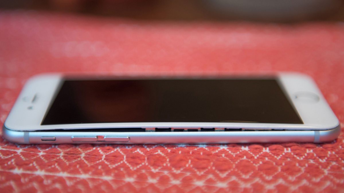

What can you do to identify a bulging battery? The best way to detect a swollen battery is to look at your device's exterior. For instance, if your laptop is beginning to show unnatural "curves" on the keyboard area. Your phone's aluminum frames loosen up and it isn't able to be placed in a uniform manner on the desk.
