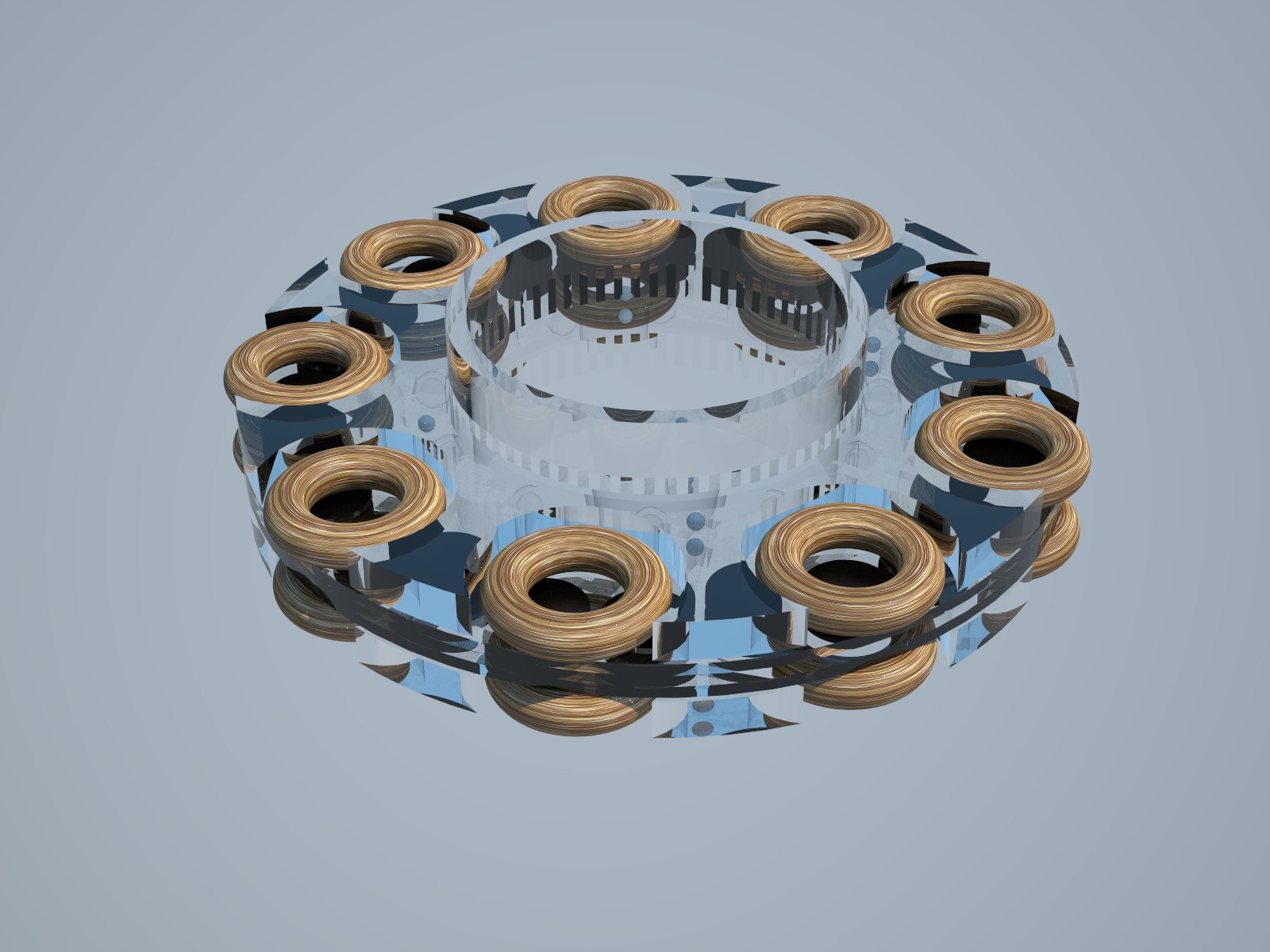

The main aim is to design a turbine that can be manufactured out of cutting plastic-sheets, easily assembled and low-cost (<250 euros) so anyone can laser or CNC cut their own. The pictures below show 3D renderings of our design idea of a single rotor and dual-stator (3-phase 9-coils each), made out of perspex (acrylic plastic).
Diameter of the design is such so the parts can be cut-out of A3 plastic sheets. This particular size makes the design suitable for constructing with the abundantly available CNC or laser cutters of A3 size.
Our design aim is to achieve simplicity in construction & assembly, beauty and an acceptable efficiency (output/cost) ratio. Further, due to the nature of this open-design project we aspire that this project will generate community driven revisions to improve the initial design. At this stage, we have finished designing a prototype and we are about to build it.
