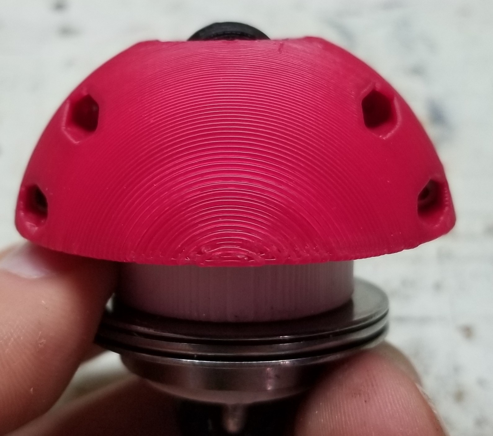

Next one of the hemisphere halves is slid on as shown below.
The other half is also slid on and then they are screwed together.
