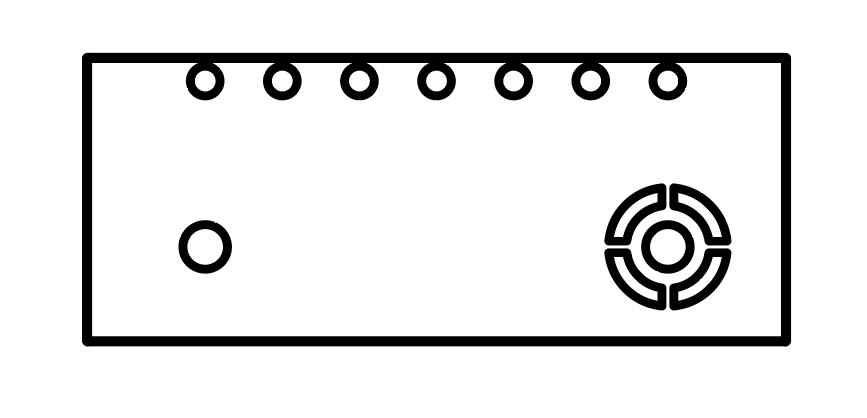

Once your housing, buttons, and screen positions are well modeled.  It is necessary to create a .DXF file that contains the outline for your overlay.  This outline will define the edge of the overlay and any cutouts or windows needed.  It will not include any of the artwork, labels, or colors.  In Fusion360, it is helpful to create a new sketch and then project the overlay edges, cutouts, and windows into it.  This sketch can then be exported as a .DXF file.
If a unique adhesive design will be used, the adhesive design needs to be exported as well.
Image below depicts a DXF for the KnuckleboneMini overlay. The adhesive design used the same DXF:

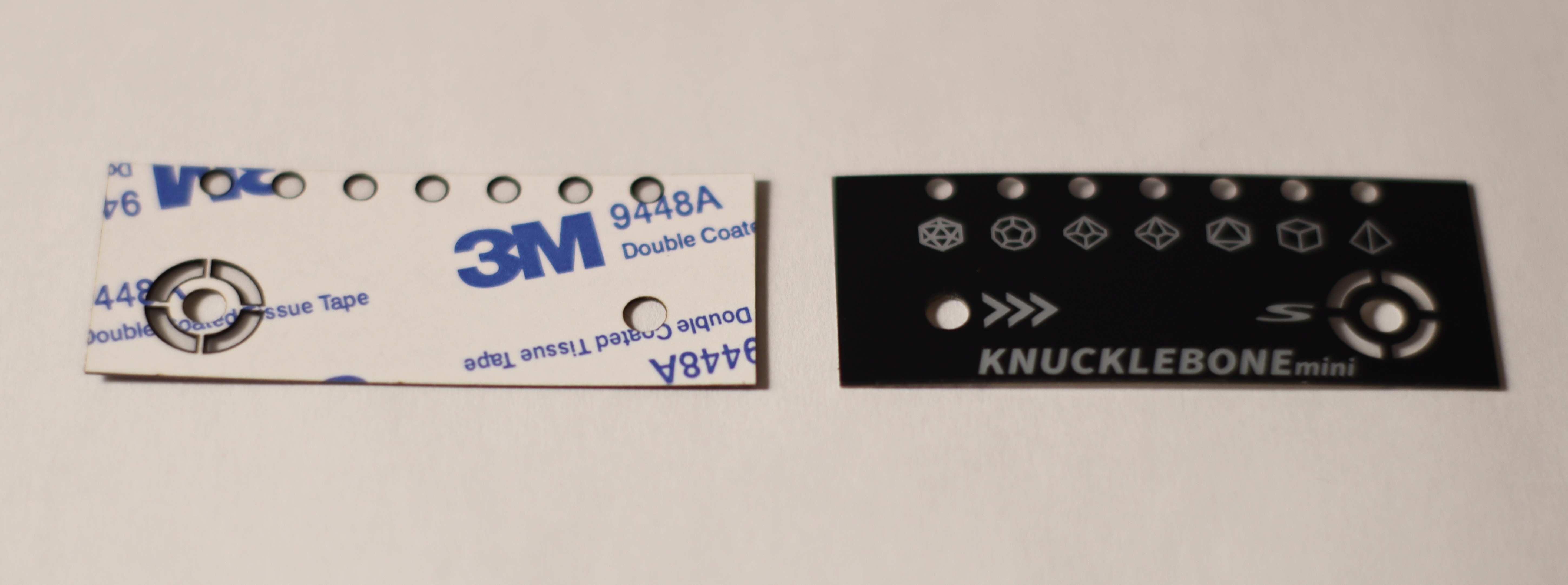

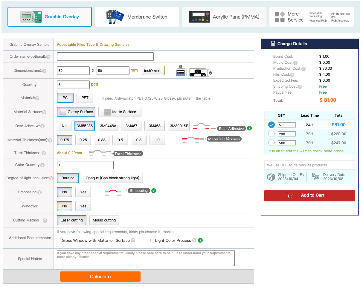

After finalizing the PDF or Adobe Illustrator file, an order can be placed with a graphic overlay manufacturer.  I recently used JRPanel.  They have an easy-to-use interface and will produce low-cost and low-quantity overlays.  At this point you will select the overlay material, material thickness, surface, adhesive, adhesive thickness, cutting method, quantity, and other details.  You will submit the PDF or Adobe Illustrator file, along with any other details.  Tradeoffs on price and product requirements will help you decide which options are appropriate for a specific project.  Once submitted, the manufacturer may review the design and request changes to be made before starting production.
At a manufacturer like JRPanel, the cost for 50mm x 50mm overlays at quantity 5 is about $80.  At quantity 200 it costs $220.  At quantity 500 it costs $247.  You can see that there are significant per unit cost savings as the quantity increases.
Image below depicts an example order configuration page from JRPanel:
Image below depicts a graphic overlay for the KnuckleboneMini designed for a Hammond Manufacturing off-the-shelf housing:
