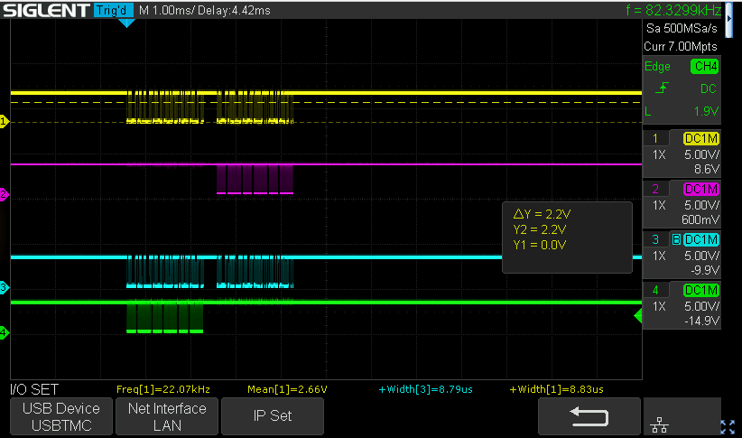

This was a short proof of concept to use the IO_MUX capability of the ESP32 to change online the PINs used for the I2C communication. Basically, the I2C hardware module can be connected to nearly every pin ofd the ESP32 and this switch can be done on the fly. I was not sure how good this work but a fast breadboard build and software sketch showed that it works like charme! See the picture and the code snippet below. Combining this with this nice hack to use only one SCL or SDA for multiple devices (link), this could be even more advantagous in several cases and save costs/space for an I2C multiplexer!
Picture of the breadboard setup:
The code snippet running on the ESP32:

P.S.: Here the results with a common SCL line and only two seperate SDA lines. Works comparable nice :-)
