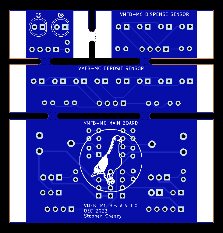

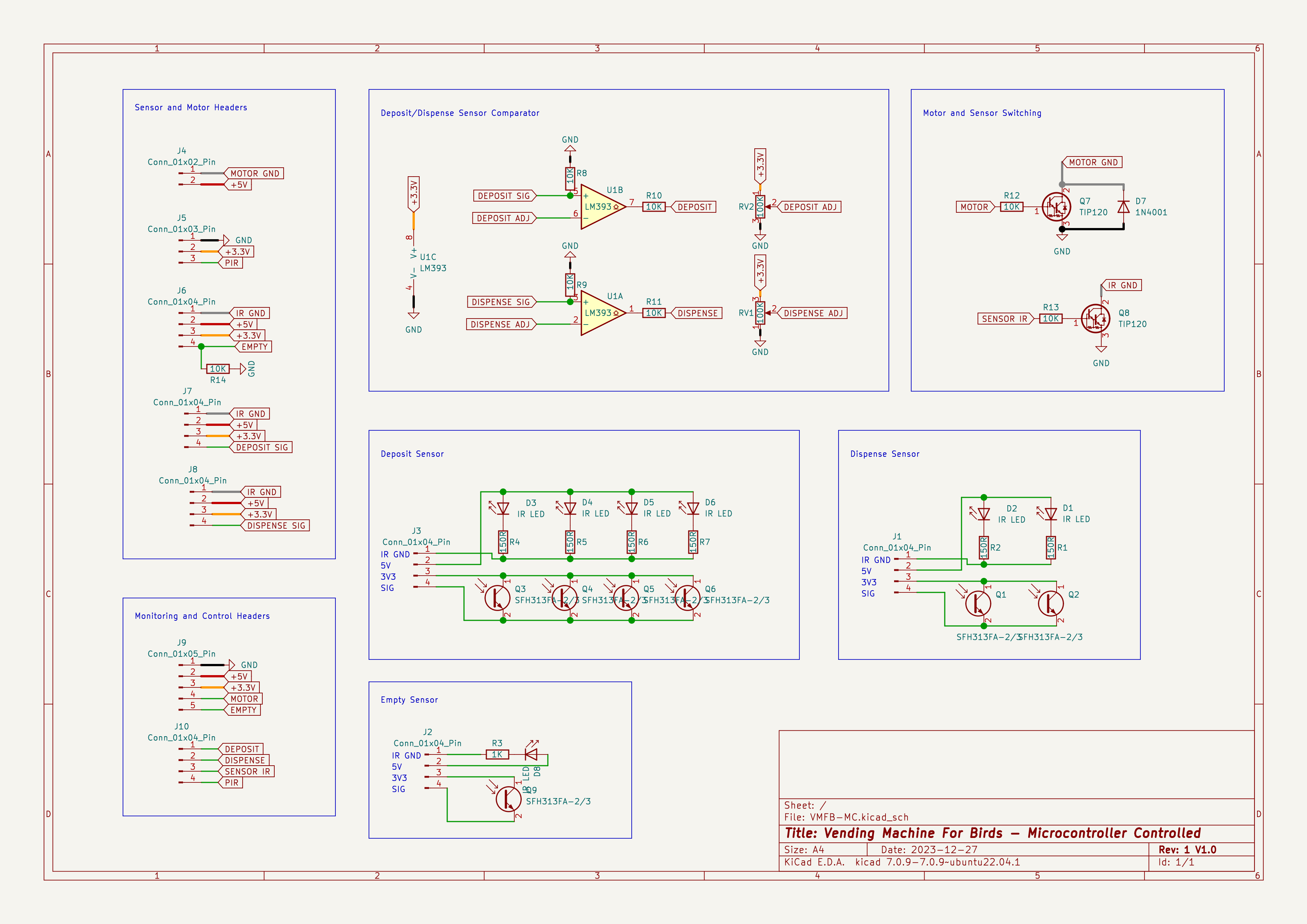

ELECTRONICS, SENSORS, AND POWER
The main board and sensors are analog, using a couple transistors, a diode, a couple pots and an LM358 dual op amp. The sensors are all made using IR phototransistors and IR LEDs. The PCB has headers broken out so you can monitor and control it with a microcontroller or SBC. It runs on 5VDC, consuming up to 800mA when sensors are on and the dispenser is running.
You can use pretty much any microcontroller or SBC. Preferably one that can use a camera module. I prototyped this on a RaspberryPi Zero W V1.1 with a 160-degree wide-angle camera. Together this consumes about 180mA. The main board and sensors use <5mA when idle, ~210mA when the sensors are on, and ~500 when the dispenser is running (this will depend on the motor you use)
PCB, BOM AND GERBERS
Kicad Files (Github): https://github.com/src1138/VMFB Gerbers, PCB and BOM (PCBWay): https://www.pcbway.com/project/shareproject/Vending_Machine_for_Birds_11f2a4da.html
Current Version is Rev. 1 Ver. 1.
Schematic
PCB Front
PCB Back
Board Dimensions: 65x68mm
The BOM is available in the Kicad files. You will also need an SBC or microcontroller to control it.
CRITICAL COMPONENTS
This project uses commodity components, and you can confidently use alternatives with similar specs. There are a few points to keep in mind.
- For the phototransistors, they should have a photocurrent of around 10mA. If they have a lower photocurrent, you should replace the 10K resistors on the non-inverting op amp imputs with a higher value. For instance, if your phototransistors have a photocurrent of ~1mA, use a 100K resistor intead.
- I used a Raspberry Pi Zero W v1.1 to control the vending machine. The shell and python files are available in the github repo with the Kicad files.

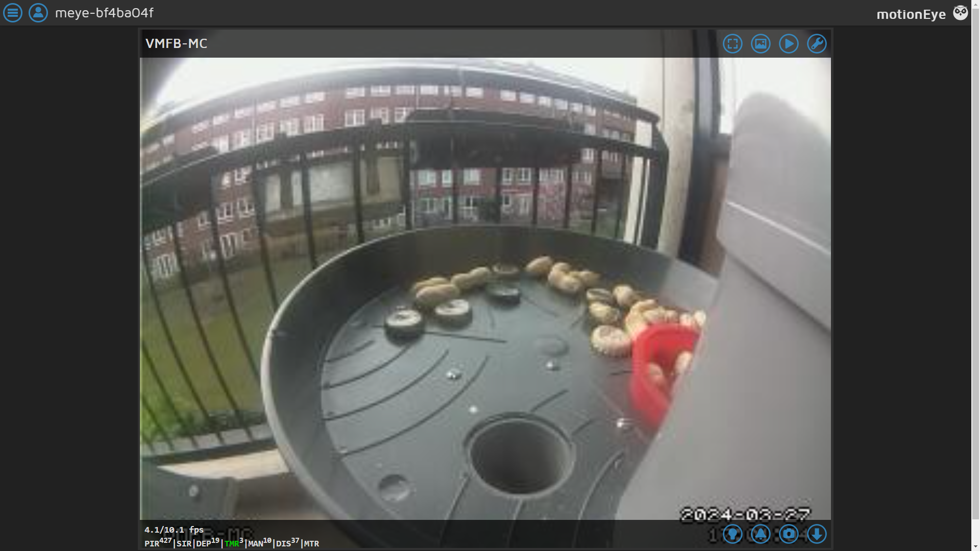

MONITORING
I have been using a Raspberry Pi Zero W with a wide-angle camera module running MotionEyeOS with my vending machine just to record videos with motion detection. Now I am using the GPIO pins to monitor and log events, trigger video recording based on sensor status, show status information on a video overlay, and enable manual record/stop for vide and dispensing of a peanut via the web interface. The python and shell scripts for this are on GitHub: https://github.com/src1138/VMFB-MC/tree/main/motioneye_scripts

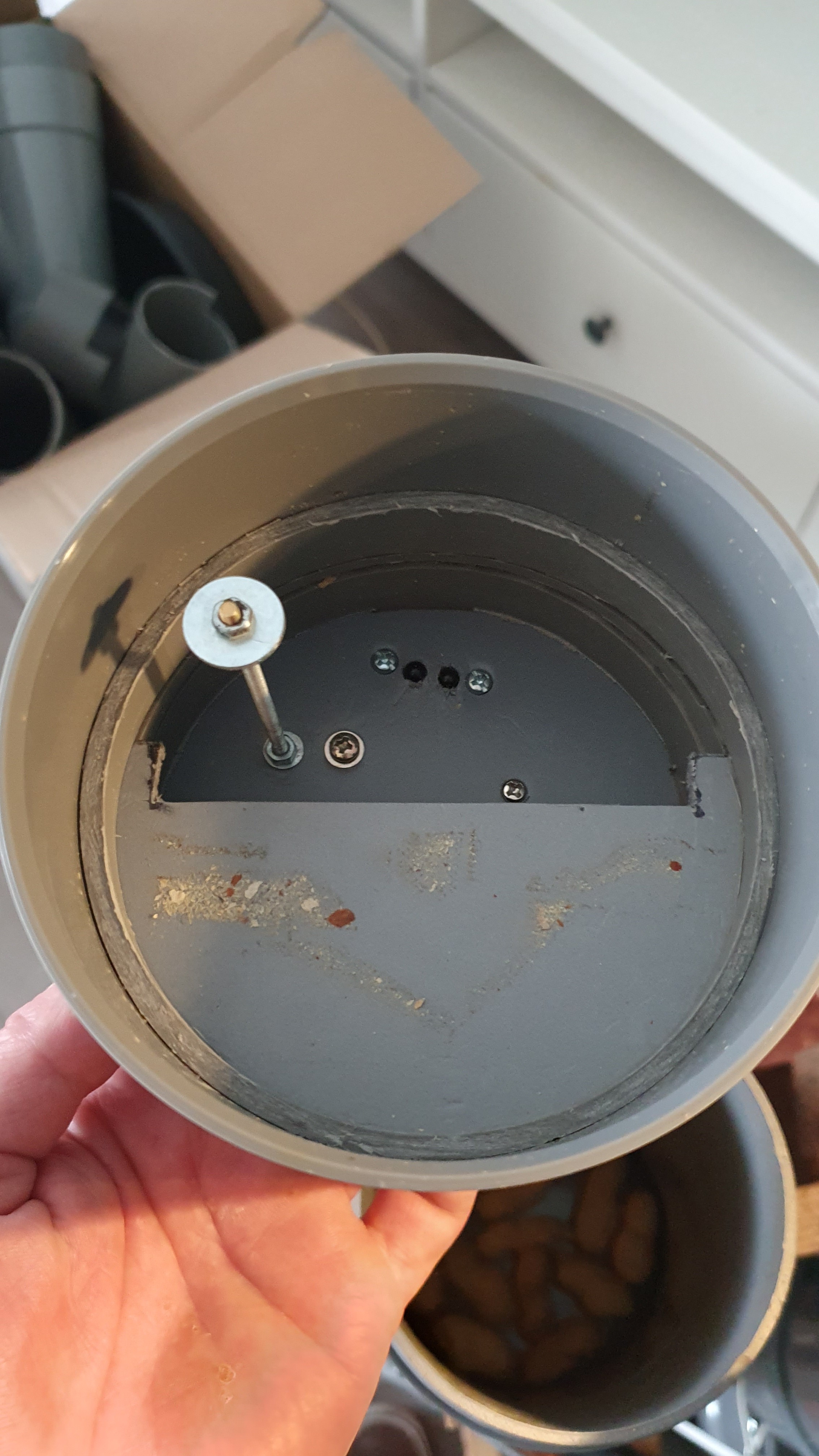

DISPENSER

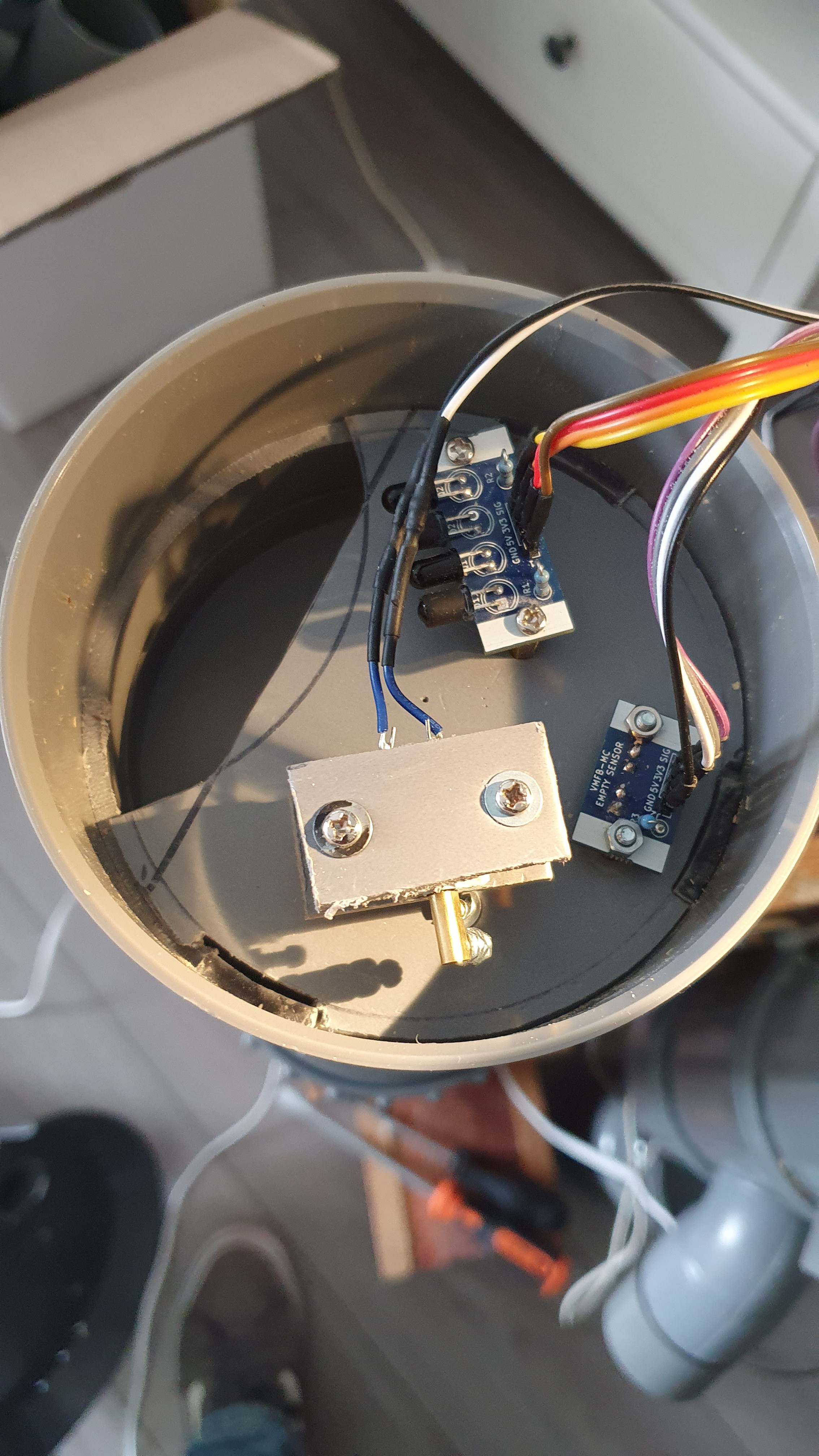

Dispenser: one-layer vibration platform made from 3mm PVC sheet and M3 brass standoffs. I used a small ~3VDC motor attached to the dispenser with brass standoffs and 3mm screws to attach the sensors. The one peeking through the bottom next to the debridging arm is the empty sensor. The one looking across the opening on the bottom is the dispense sensor.
The dispenser typically dispenses a peanut or two within 3 seconds. Since it is a vibration dispenser, the enclosure should be level and mounted securely to insure relaible dispensing.
Here are some detail pics of the PVC pipe-based container and dispenser in a previous iteration of thie project. I cut away part of the coupler that holds it together to better show the assemblly.
Hopper and Dispenser![]() | Top screw end cap removed![]() | Top baffle and 5mm pipe slice removed![]() |
Lower baffle and 10mm pipe slice removed | coupling and 18mm pipe slice removed | dispenser assembly side view |
The dispenser drops peanuts into a funnel leading to the dispense chute. There is about 10cm between the two, making it difficult for rodents small enough to get into the machine to get to the food. A little mineral oil in the dispense chute won't harm the birds and will make it extra difficult for rats, mice and squirrels. PVC is tough enough to keep larger rodents from gnawing or breaking thier way in.
