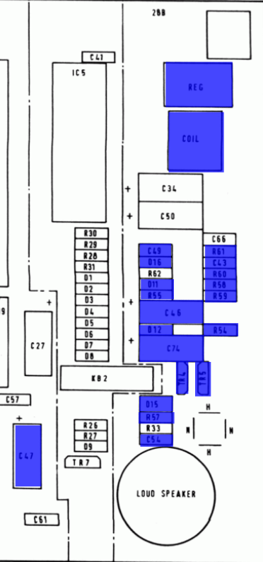

I received this 48K spectrum from a friend, in a mostly working state. It needed to have the membrane replaced as well as one of the 32K ram chips. Through the process of rework the DC-DC converter circuit began to fail. I believe as a result of being run at a high level for a long period of time, from an unregulated 9v supply that may have drifted slightly.
On initial inspection, I determined the 4116's must have failed as TR4 / TR5 kept blowing. I replaced them (t4 and t5) and removed the ram chips, to no avail as the transistors kept failing even with the ram chips removed. The next on the list to check was all the capacitors, I verified none were open or dead short with good ESR values ( all electrolytic were replaced first thing - and the board worked for a few hours at least). I suspected the coil was bad. At this point I started to deep dive into the circuit and read through two separate circuit descriptions trying to determine:
- why this circuit fails so much.
- why this was the most modified part of the circuit throughout the revisions.
- can this be improved uppon.
I asked my father, who was an EE from the 60's all the way to the 90's to take a look at the inverter / DC-DC circuits across the several revisions as he's vastly better at looking at analog circuits than I am. Together we determined that the DC-DC mods specifically address regulation and clamping issues in the previous versions of the circuit. While these improve supply output and manage transient voltages which feed sensitive ram chips it does not address what is conspicuously missing from ALL revisions of the 48k DC-DC circuit; 4116 bring up timing.
The 4116's and by in large the transistors inside the DC-DC circuit fail because the supply does not adhere to this note in the 4116 Datasheet:
Simply put - There is no timing mechanism beyond the R/C delay inside the circuit itself, which grants exclusively that VBB (-5v) is applied first, and removed last. Furthermore, when power is removed to turn off the system if the ground path is eliminated by disconnecting the cord completely or isolating the ground line in an improperly wired switch. There is no way to assure any sort of state on power down.
So - specifically when the 4116's fail, and they usually will, the DC-DC circuit is often damaged by an over current condition on the digital 12v rail.

So then, how did I go about modifying my 48K for 12v? -- Below are the steps I took to make this modification. I tried where I could to use existing through holes and vias, and to keep to the silkscreen footprint where possible.

UPGRADE THE REGULATOR AND CLEAR THE COIL PADS ON THE BOARD
- Replace the linear regulator and heat-sync with a switching regulator drop in replacement such as Traco Power TSR-1-2450, or equivalent. Take care to match the pin out of the LM7805 with the replacement part. When you are done you will not need the heat-sync.
- Remove the charging coil completely and clear at the very least the pads on the right.
- be careful to not damage traces on both sides of the board, highly recommend using suction and watch temperature and dwell time.
- don't be surprised if there is a small bit of glue actually under the coil here. I found some on mine.
- it is very difficult to cut this part off the board to prior to de soldering without damaging the board. avoid this method with the charge coil to prevent damaging the PCB, pads or traces.
- Bridge the right hand pads, the top corner next to the regulator and the pad in the bottom corner below (skipping the middle pin) to bring 12v directly through the 12v rail - you will want to use a larger conductor like a off clipped leg of a DO-41 Diode (this is approximately .77 mm diameter +/- .7 mm)
- done correctly you will have continuity through the outside sheath of the DC jack, and the positive pin of C50 (left side).
REMOVE AND RECONFIGURE THE DC-DC CIRCUIT
- Remove all the Highlighted components in the DC-DC circuit you can use
flush cut to clip the components from the top of the board. (except the coil which needs to be de-soldered ) - Clear the component holes for C49, C74, D12, D15, R54, and R55.
- Use forceps / tweezers to pull the legs out from top or bottom while heating with soldering iron.
- clear the through hole using a good solder wick like MG Chemicals Superwick or Gootwick.
- watch heat level and dwell time to assure this is inside the limits of connected circuits, do not apply force with the tip of the iron as the top traces are soft, and may de-laminate if too much force or heat is applied.

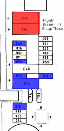

- Test R62 - this should be 15 ohms. if not, replace with a 15 - 22 ohm 1/4 watt resistor. mine was dead, shorted straight across.
- Consider replacing C50, and C34 these are directly under the heat sync for a long time and will likely be dried out and not functioning, at this point these are still very integrated into other circuits on the board so in-circuit testing will not be precise. C50 should also be at the very least a 15v capacitor, 25v preferred. You may also wish to replace C44 and C45 (these are the 12v rail's filter capacitors).
- Replace C49 with a BZX55C12 ( 12v 1/2 Watt Zener Diode) to clamp the 12v supply line to 12v; this as a precaution - this should already be done inside the supply.
- optionally place a small piece of polyimide tape down under the diode to prevent the legs from shorting to the vias and traces in this location
- align the cathode (the side with the line) with the left pad of the footprint.
- this clamps the voltage to 12v. and will withstand currents up to 1/2 watt.
- the 4116's and the video amp total current should not exceed 300mA
- the supply regulation will need hold the voltage at 12v - so this diode is a precaution in the event a short transient occurs when plugging or unplugging the power connector, or switch transients in the case an inline switch is used (see design note below).
- Replace D12 (optional) and D15 (required) with 1N5817 Schottky Rectifier Diode.
- D12 is only needed if the optional 4116 charge pump mod is used
- D15, and D12 should follow the footprint on the board for cathode alignment.
- D12 is a smaller DO-35 footprint (though its large for that footprint range). it may be very difficult to install the larger DO-41 diode in this place. If needed, D12 in the mod is value oversized - replace with a .5A-.25A Schottkey diode in the DO-35 footprint (this will require research to assure the voltages of the circuit are met, in both directions across the diode.)
Optional Steps:
- (*OPTIONAL*) If using 4116 optional charge pump mod (see below) - install a short, red, 24 gauge solid core wire to the positive pad (left) of C74, and a red 30 gauge wire to the right pad of R55.
- (*OPTIONAL*) if using 4116 optional charge pump mod(see below) - install a short, black, solid core wire to the right pad or R54 - (this is also a good place to grab ground from if you need to tie the pad between the top H and right N jumpers -- for the EEPROM mod. )
