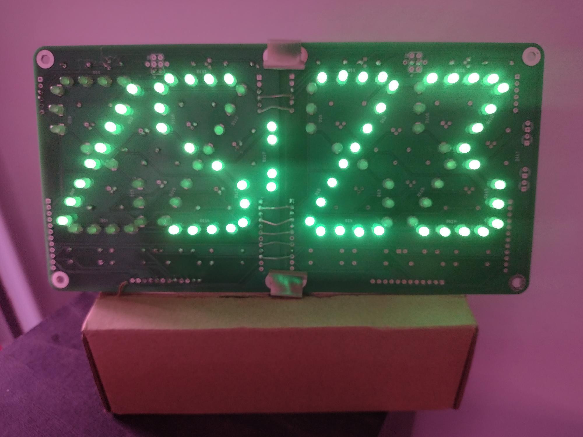

I flashed this to the chip and measured the pin voltages again, and got more plausible values. Ok, I'll take the win for this skirmish and test it again after I have connected up the display board.
Update 2025-03-22, round 2:
Well, I didn't quite totally win the last skirmish. It turned out that the voltages were not as expected as I had hastily measured them with a multimeter and thought that a voltage in the middle of the 0 to 5 V range indicated pulsing. A probe with a DSO showed that this wasn't the case.
So the fault lay somewhere in the MCU specific initialisation code since the rest of the code is generic and works on the 8051 family MCUs.
I first tried getting the simulator under MPLAB-X working, but it seems there is no debug model for the AT90S8515 any more, it's too old.
So it was back to scrutinising the code carefully. I'll cut to the chase and show you the diff, then explain.

The first two changes are simply to set the output ports to high level which is not the power on default so that I know ports_init() is working.
The next 2 line change is because I was using the wrong timer compare register, it should be A. B doesn't have reset to 0 on match so isn't suitable.
The remainder of the diffs are because I had wrongly assumed that the symbols CTC1 and so forth from the include files were bitmasks. They are actually bit positions in the byte hence the edits to (1 << CTC1) and so forth.
With the new image flashed onto the MCU, I can now see the correct waveforms on the digit and segment select lines.
Update 2025-04-09:
Connected up the board to a display and it works great:
The sources are at Github.
