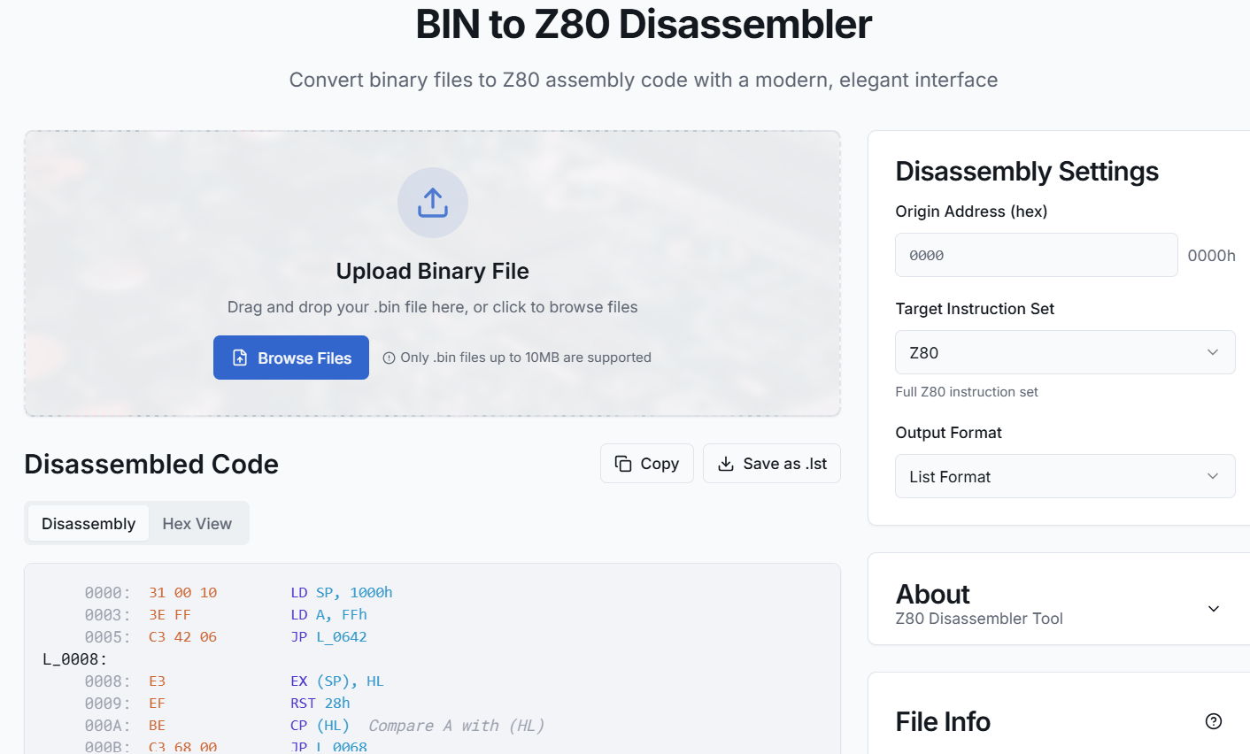

The disassembler
- Link to source code (I deliberately refrained from any "human" touch-ups, all changes are made by the lovable-dev[bot])
- Link to working app
Features:
- Required input:
- binary file (.bin extension) which is a sequence of bytes one would typically use to burn into an EPROM, or dump code memory etc. For test purposes, I used the "Tiny Basic" binary (same code for which I have written a CPU and "single-board computer" in VHDL)
- Optional inputs:
- offset address added to the binary byte counter / pointer (e.g. if you have a binary which is supposed to work from address != 0000 - remember code for Intel 8080 and its derivatives is not relocatable)
- Targeted CPU instruction set (Z80, Intel 8080, 8085)
- Output format (.lst shows addresses and instruction bytes in hex format along with disassembled code, .asm only the latter, so it is more ready to be re-assembled again)
- Output:
- Hex view (along with ASCII characters on the side when in range 0x20 .. 0x7E), including option to download in Intel HEX file format.
- Disassembly view. This allows viewing either as .lst or .asm with possibility to copy and/or download it as file. Flavors:
- Z80 - uses Z80 type mnemonics, "escape" op-codes (0xCB - bit, 0xDD - IX, 0xFD - IY) are not (yet) implemented (not to mention the undocumented ones)
- Intel 8080 and 8085 - attempted to use Intel mnemonics, but a bit of hit or miss so far (needs to be refined). Same for RIM and SIM 8085-only instructions

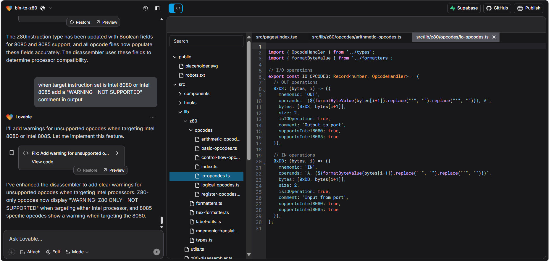

Development process
Loveable has a simple but very effective web-based IDE (integrated development environment). The process is interactive dialog with the system, and after each prompt result can be observed either in the code, or sandboxed app. Input can be made richer by attaching file with relevant data, and response contains link to code change and "echo" of the command as it was interpreted by the system. It is smart enough to figure out if the change is a "new feature", "refactor", or "fix", and code change produced will reflect that too. Each prompt that is results in code change is effectively a github commit, and this granularity allows tracking and reverting every change.
It took about 20 or so prompts to have an app that was able to disassemble the Tiny Basic, and this could be achieved in few hours (it took me few days as I kept running out of daily quota). However, exact tweaking required lots of "chatting", to the point one is tempted to just dig in and "correct" the code manually (which is also possible and good github integration makes it "round-trippable").
Closely examining code and app behavior after each command is interesting exercise, and it gives insight into how the system "thinks". Observing the patters it is taking allows crafting more efficient commands in the chat pane, and therefore results that align with intent of the developer. Below are some example.

| (feature) In disassembly settings, add a dropdown named "Target instruction set" with 3 options: Z80, Intel 8080, Intel 8085. Default is Z80. | feat: Add instruction set selection · zpekic/bin-to-z80@426349f | Really done perfectly. Added the control, ensured that the value is unique (and not same like the display value, ensuring easier future localization, set the right default. |
| (feature) If the target instruction set dropdown is Intel 8080 or Intel 8085 use Intel assembly mnemonics as explained in https://pastraiser.com/cpu/i8080/i8080_opcodes.html, not Zilog ones. | Refactor: Support Intel 8080/8085 mnemonics · zpekic/bin-to-z80@b04234d | This one was very fascinating to see. The AI system did this exactly the way perhaps a junior developer would do it - clunky but somewhat workable. Instead of going back to the design of instruction lookup table (and extending it with data specific to Intel processors), it introduced a "string translation" lookup from Z80 to Intel mnemonics. Along the way, it "hallucinated" a few instructions for 8080 which do not really exist, for example it "invented" the DCR B / JNZ sequence. Another problem with this approach is that it actually mixes up the mnemonics: EX HL, (SP) becomes XTHL HL, (SP) instead of just XTHL. // Map Z80 mnemonics to Intel 8080/8085 mnemonics
