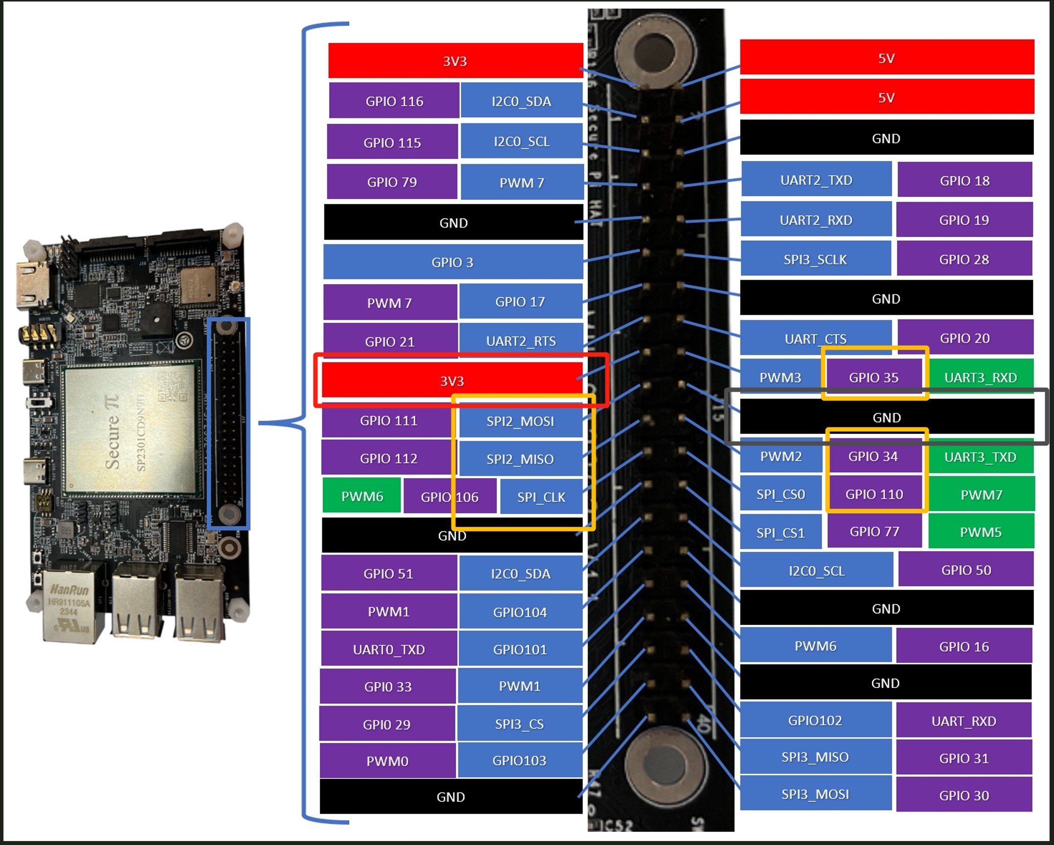

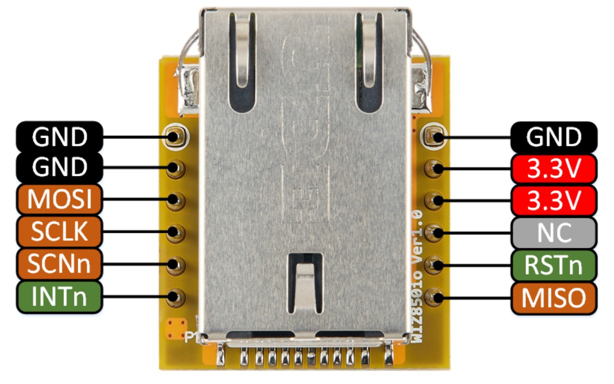

To connect the WIZ850io module to the SP2302 via SPI, please wire the following pins:
Function | SP2302 Extended 40 Pins | WIZ850io Pin |
MISO | SPI2_MISO | MISO |
MOSI | SPI2_MOSI | MOSI |
SCLK | SPI_CLK | SCLK |
CS (Chip Select) | SPI_CS0 | SCNn |
RESET | GPIO35 | RSTn |
Interrupt | GPIO34 | INTn |
GND | GND | GND |
VCC (3.3V) | 3V3 | 3.3V |
Note: Please fill in the actual SP2302 pin assignments in the table above based on your board’s layout or pinout documentation.

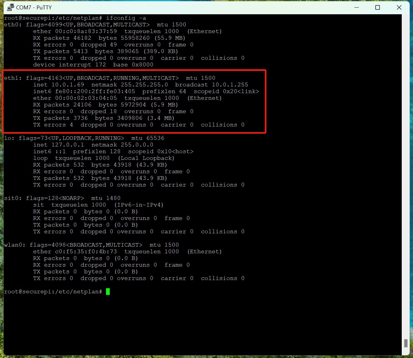

2 Verify Second Ethernet Interface (eth1
Check for the presence of eth1
bash ifconfig -a
You should see both eth0
(native) and eth1
(W5500 via SPI).
If eth1
is not listed, ensure SPI is enabled, the wiring is correct, and the chip is receiving power.

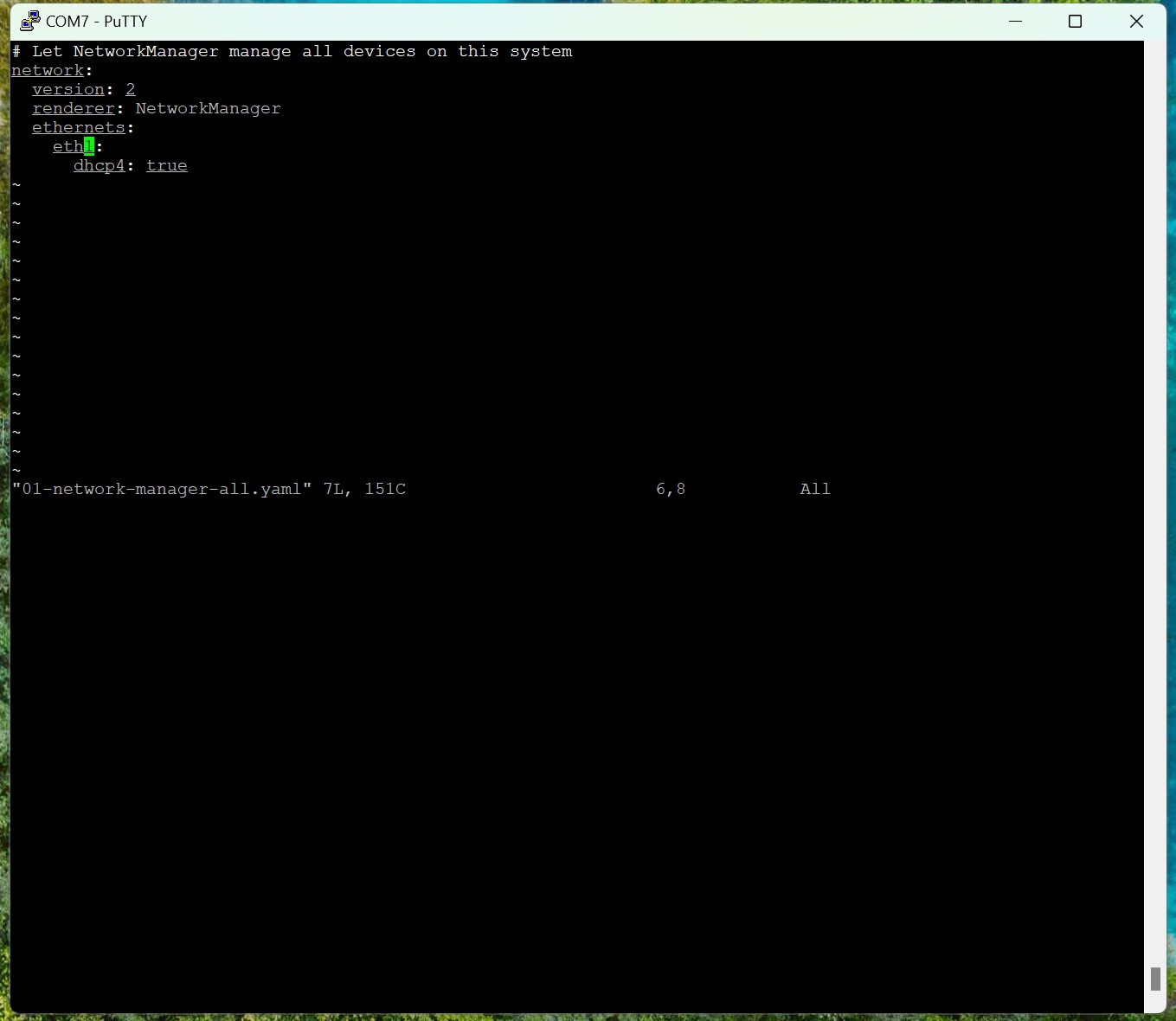

3 Configure netplan
to Use DHCP on W5500 (eth1
Edit or create a netplan configuration:
bash vi 01-network-manager-all.yaml
Paste the following:
network: version: 2 renderer: NetworkManager ethernets: eth1: dhcp4: true

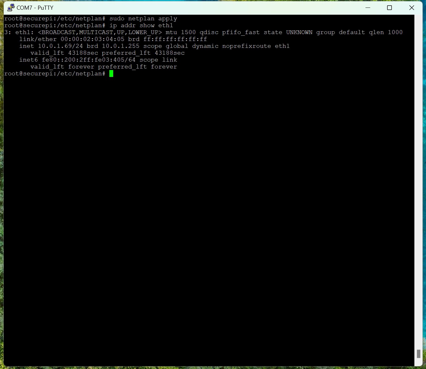

Apply the configuration:
bash sudo netplan apply
Wait a few seconds, then check for an IP address:
bash ip addr show eth1
