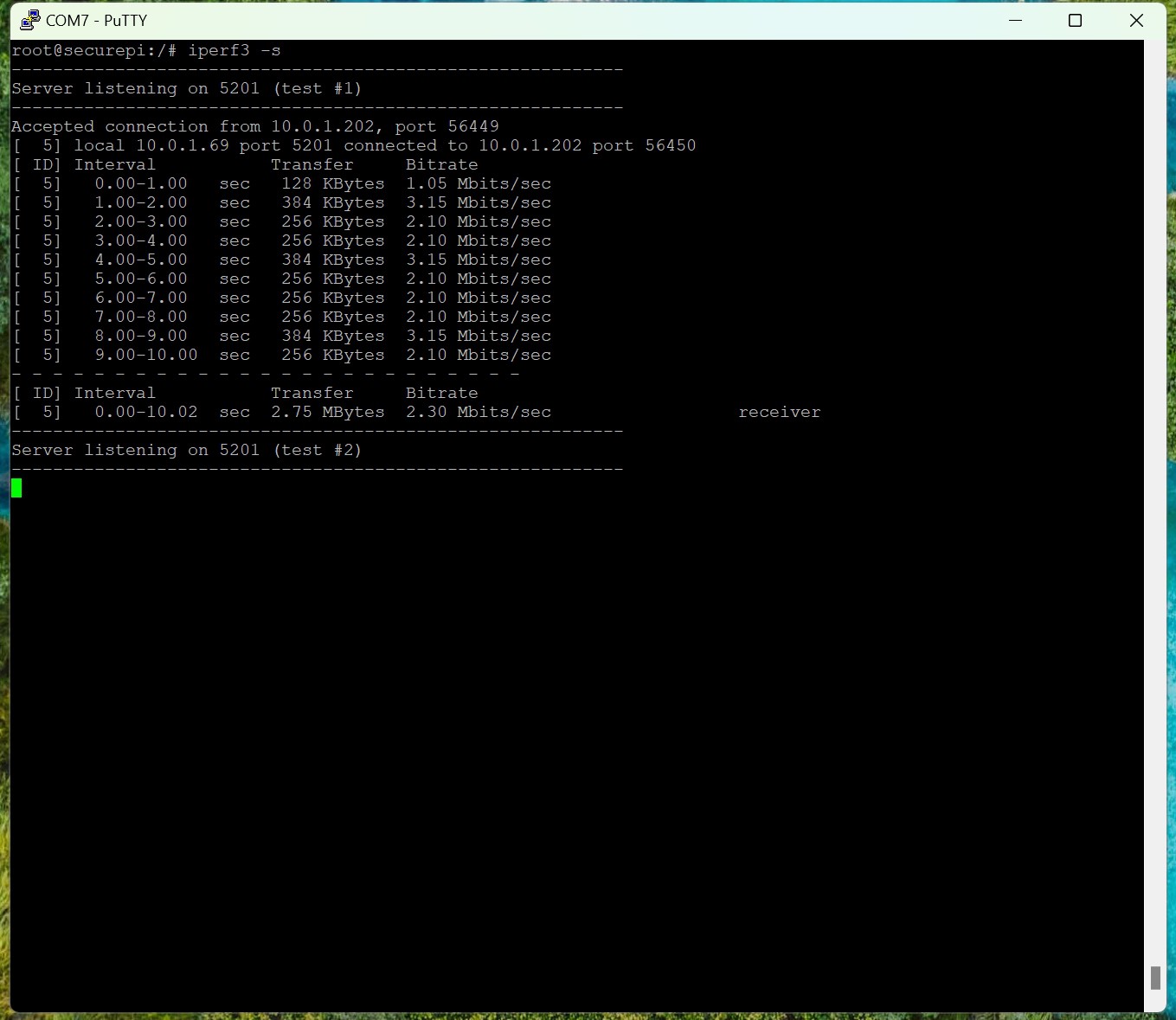

Run it as a server:
bash iperf3 -s
Leave this terminal open — it waits for incoming tests.

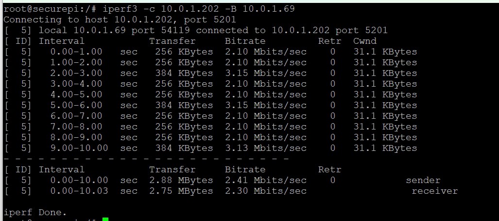

Step 4: Test from SP2302 Client (W5500 via eth1
4.1 Ensure eth1
has a valid IP
bash ip addr show eth1
If not, apply your netplan or assign a static IP.
4.2 Run iperf test via eth1
bash iperf3 -c <PC_IP> -B <SP2302_eth1_IP>
For example:
bash iperf3 -c 192.168.1.100 -B 192.168.1.50
Testing Output:
bash
iperf3 -c 10.0.1.202 -B 10.0.1.69

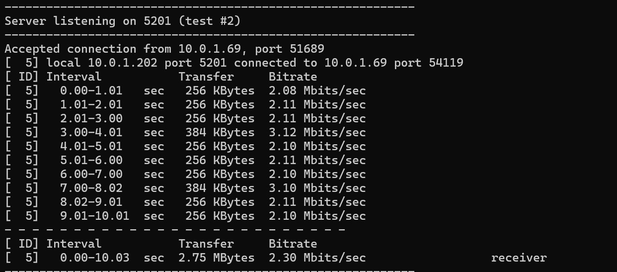

From PC:
From SP2302:

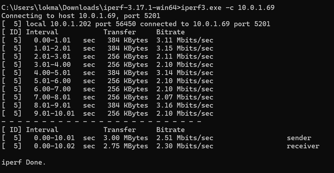

Step 5: Optional - Reverse Direction Test
From PC:
bash iperf3 -c 192.168.1.50
Testing Output:
bash
iperf3 -c 10.0.1.69
From PC:
From SP2302:
This checks inbound performance to the SP2302 over W5500.
