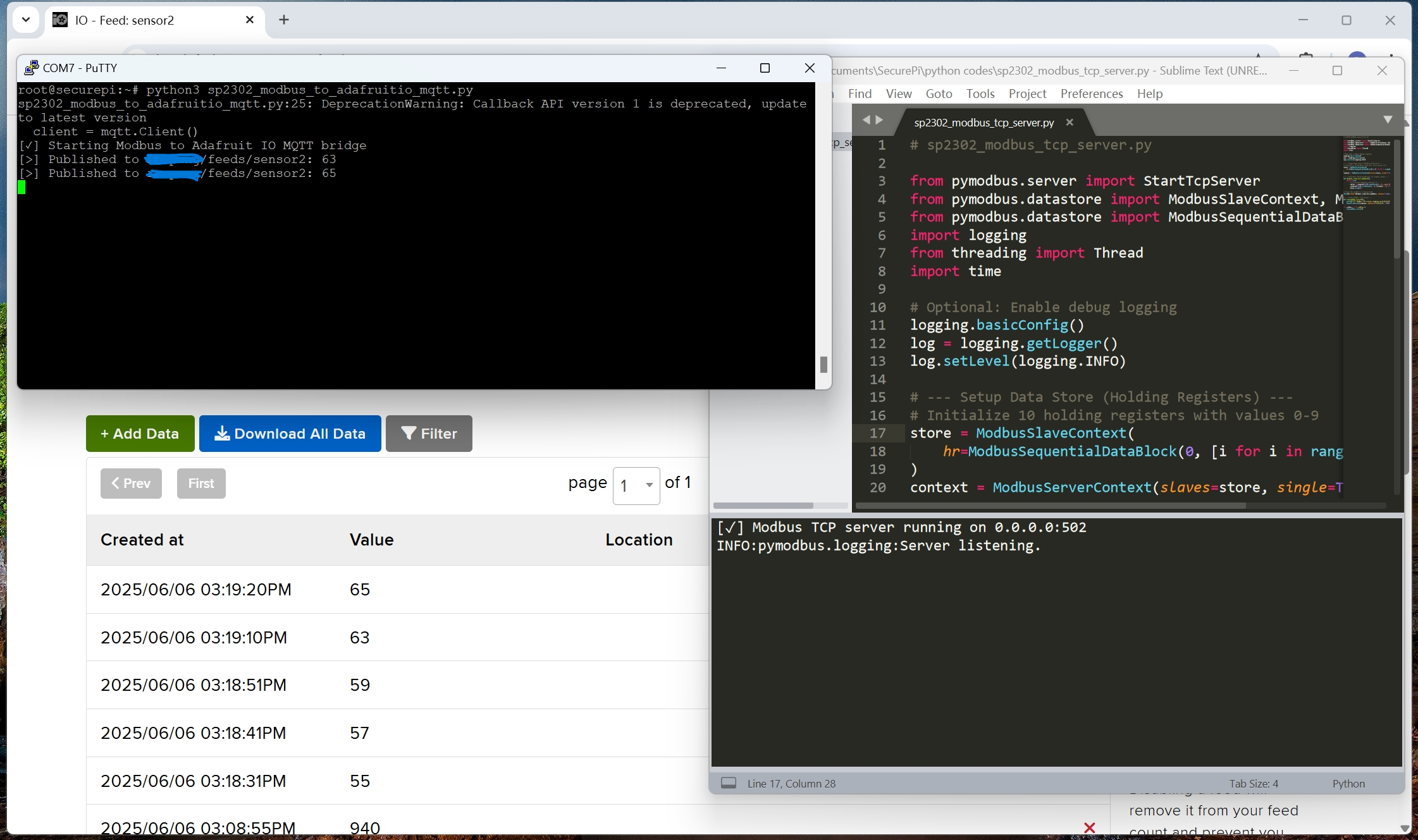

Demo: Modbus TCP to MQTT Gateway (Field-to-Cloud)
This example reads a simulated Modbus register from a device on `eth1`, and sends it to **Adafruit IO** using MQTT over `eth0`.
Install Required Packages
bash pip3 install pymodbus paho-mqtt
Python Demo Code
python # iot_gateway_demo.py import time import paho.mqtt.client as mqtt from pymodbus.client.sync import ModbusTcpClient # --- Modbus TCP Config (eth1 interface) --- MODBUS_IP = '192.168.2.100' MODBUS_PORT = 502 UNIT_ID = 1 # --- Adafruit IO MQTT Config (eth0 interface) --- AIO_USER = 'your_adafruit_username' AIO_KEY = 'your_aio_key' AIO_FEED = 'sensor1' BROKER = 'io.adafruit.com' TOPIC = f"{AIO_USER}/feeds/{AIO_FEED}" ETH0_IP = '192.168.1.50' # Bind MQTT to this IP # Setup MQTT mqtt_client = mqtt.Client() mqtt_client.username_pw_set(AIO_USER, AIO_KEY) mqtt_client.bind_address = ETH0_IP mqtt_client.connect(BROKER, 1883, 60) mqtt_client.loop_start() def read_modbus(): client = ModbusTcpClient(MODBUS_IP, port=MODBUS_PORT) if not client.connect(): print("[X] Modbus connect failed") return None result = client.read_holding_registers(0, 1, unit=UNIT_ID) client.close() if not result.isError(): return result.registers[0] return None def main(): print("[✓] Gateway running (Modbus ➜ MQTT)") while True: val = read_modbus() if val is not None: mqtt_client.publish(TOPIC, val) print(f"[>] Published to cloud: {val}") time.sleep(5) if __name__ == "__main__": main()
Test Scenario
- SP2302 talks to a Modbus TCP device at
192.168.2.100
viaeth1
- Data is read every 5 seconds
- Value is sent to Adafruit IO over
eth0
via MQTT
Result
