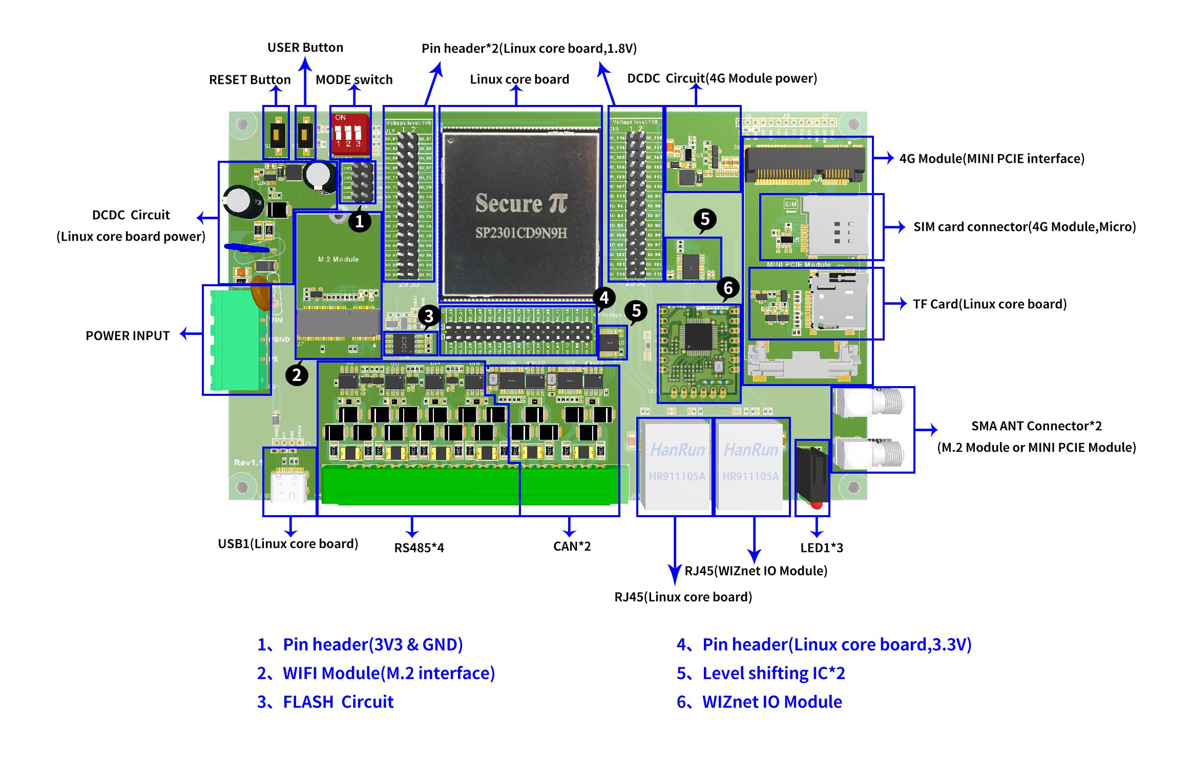

The SP2301 Linux EVB from WIZnet is an industrial-grade embedded Linux development board designed for industrial IoT and edge computing applications. A key feature of this board is its dual-port Ethernet capability, achieved by combining:
The native SP2301 Ethernet interface for control signals
An expansion Ethernet port via W5100S-io / W5500-io for data communication
This architecture ensures physical separation between control and data flows, providing greater system stability and security.
With SecurePi firmware and Linux kernel drivers that already support WIZnet W5100S / W5500 chipsets, users can easily enable dual-port Ethernet communication. This guide outlines how to install the firmware using the SD card and BOOT switch, without needing Linux command-line operations.

3. Set the BOOT Switch
The SP2301 Linux EVB is equipped with a BOOT mode selector switch that determines the startup source.
Set the BOOT switch to SD boot mode. This instructs the board to load the Linux OS directly from the SD card during startup. There is no need to manually flash internal storage or run additional setup commands.
