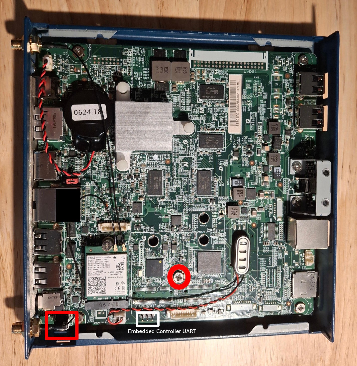

The unit is AOpen Chromebox Commercial, board name NINJA. The WP screw is the one in the middle. The recovery button is on the back.

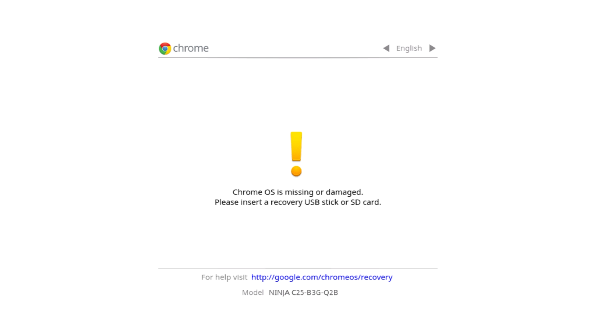

I was able to confirm the model by entering recovery mode.

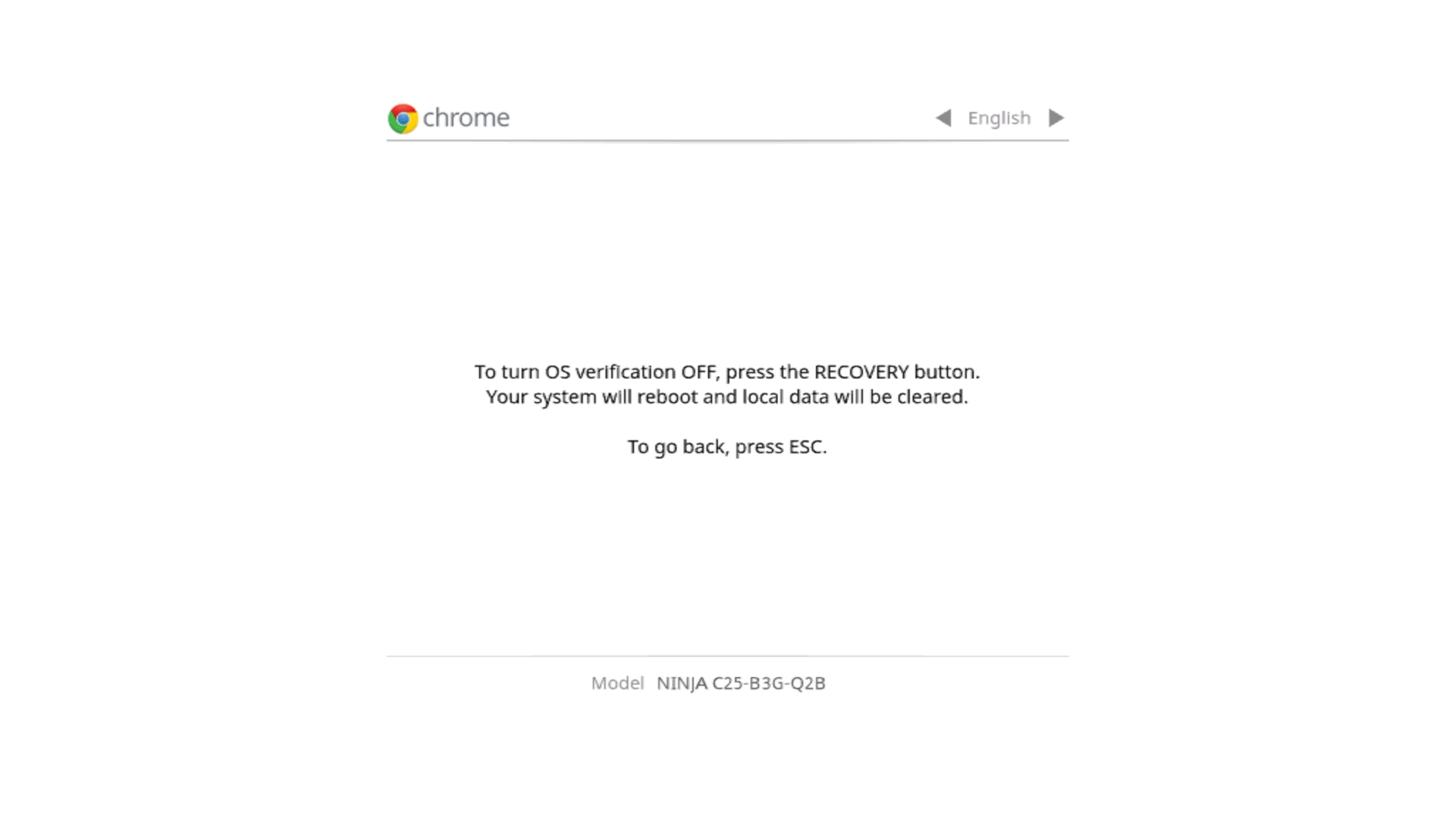

I followed the instruction to enter developer mode by disabling OS Verification.

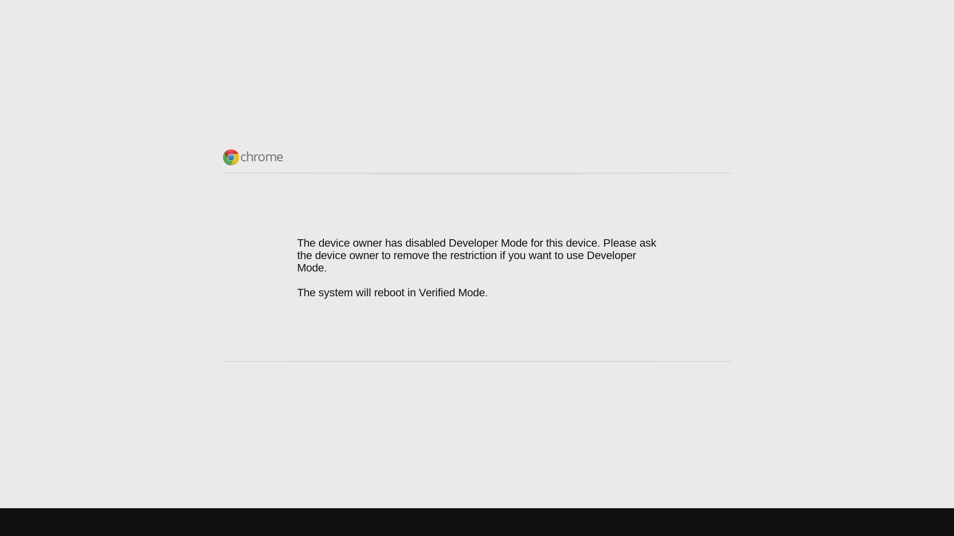

With OS Verification Disabled, I booted the device but developer mode was restricted.
The device owner has disabled Developer Mode for this Device.

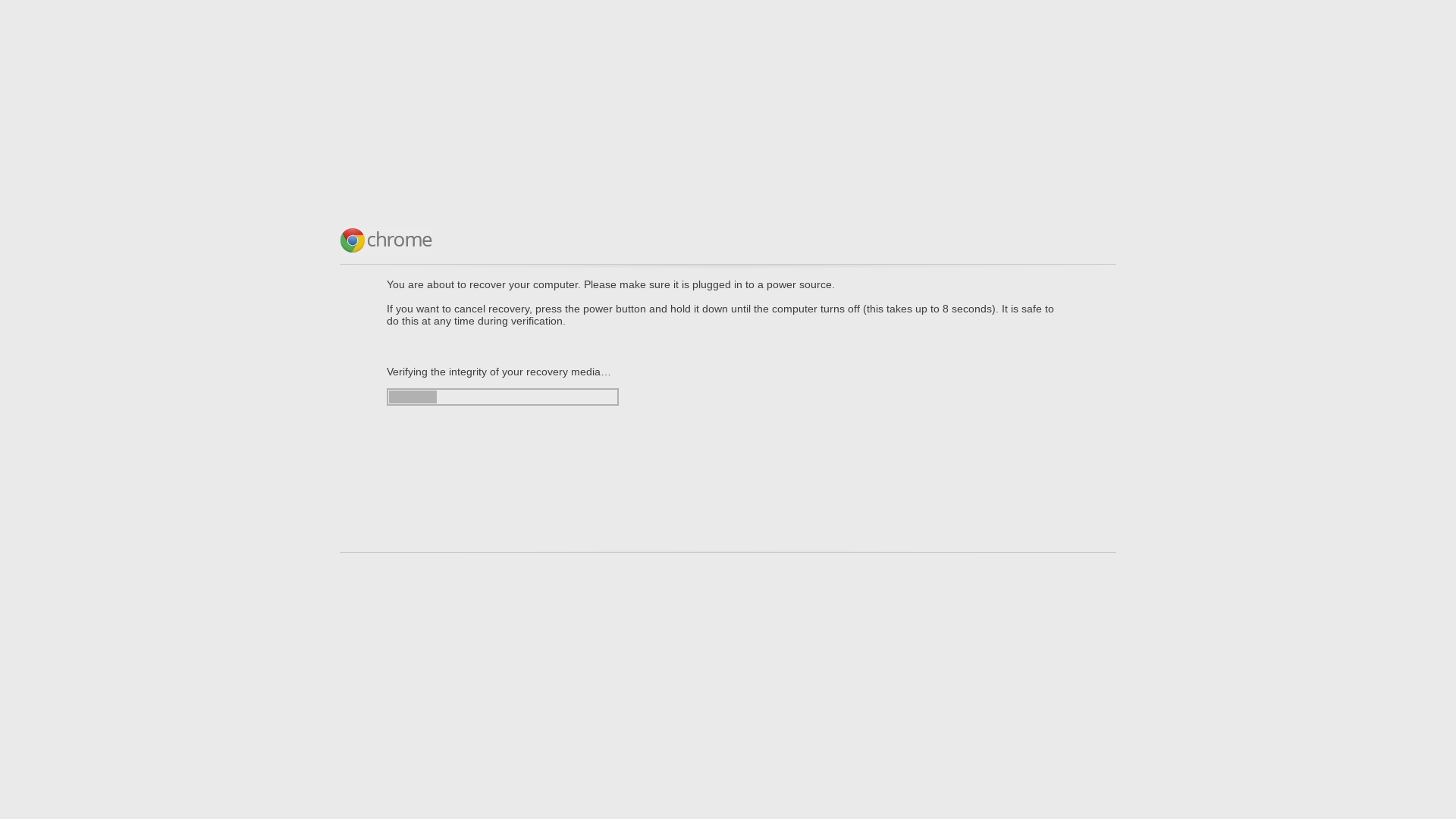

Before continuing with account setup, I performed a system restore. I made a recovery drive from Linux.
With the system restored, I login on the chromebox. The system run ok, however unit is EOL, the browser is out of date and does not more recent feature (No Chrome Extension, No Google Meet, ... ). Not a big loss to change the OS to Linux.

I went thru the steps to enable developer mode once more. This time it worked. I guess login in the unit clear some things.

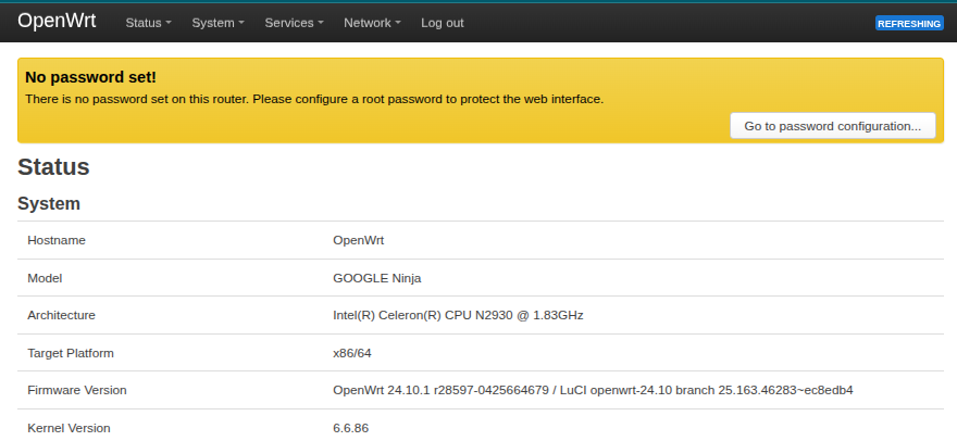

I was able to run Ubuntu (a bit heavy) and OpenWRT (Like a charm).
