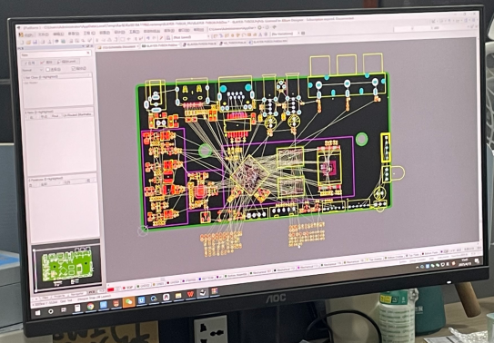

Step 2 – Converting the Schematic to PCB Layout
After your schematic is complete, it’s time to convert it into a physical PCB layout. This involves placing your components on a digital board and routing the traces that will connect them. Keep the layout as compact as possible while ensuring there’s enough space for each component to fit properly. A good layout will not only ensure electrical functionality but also allow for easy routing of traces. Positioning components near each other based on their function helps minimize trace lengths and potential signal interference.
Step 3 – Routing the PCB
Routing refers to drawing the paths (traces) that electrically connect the components. You can route the traces manually or use the software’s auto-routing feature. However, manual routing is preferred in more complex designs as it allows for better control. Ensure the traces are wide enough to carry current without overheating, and keep the high-speed signal traces as short as possible to reduce signal loss or interference.

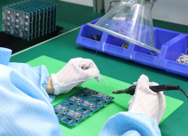

The PCB Assembly Process: A Step-by-Step Guide
Step 1 – Preparing the PCB
Before assembly, clean the PCB to remove any dust or oils that might interfere with soldering. You can use isopropyl alcohol and a lint-free cloth to gently clean the board. Also, inspect the PCB for any visual defects, like scratches or missing pads.
Step 2 – Placing the Components
Start placing the components on the PCB, following the layout you designed. Use tweezers for small components, ensuring they are oriented correctly (e.g., capacitors and diodes must be placed in the right direction). For through-hole components, insert the leads through the holes, and for surface-mount components, apply solder paste and place the parts on the pads.
Step 3 – Soldering the Components
- Through-Hole Soldering: For through-hole components, insert the leads into the board, bend them on the other side, and then solder them in place. Be sure to use a steady hand and avoid applying too much heat, which can damage the components.
- Surface-Mount Soldering: For SMT components, use solder paste to adhere components to the board. Then, use a reflow oven or hot air gun to melt the solder paste and secure the parts.
Step 4 – Inspecting and Testing the PCB
After soldering, carefully inspect the board for any soldering mistakes, such as cold solder joints or bridges between pins. You can use a magnifying glass to examine the joints closely. Then, test the board using a multimeter to check for continuity, ensuring no components are misconnected.
Step 5 – Troubleshooting Common Assembly Issues
If you encounter issues such as a cold solder joint (where the solder didn’t melt correctly), reflow the joint with the soldering iron. If there’s a short circuit, use desoldering braid or a vacuum pump to remove excess solder and correct the problem.
