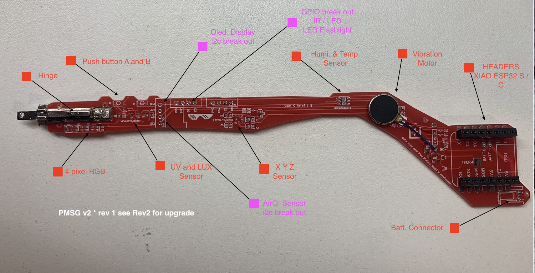

PMSG turns any pair of eyewear or cool pair of without sunglasses into modular smart glasses customisable, open-design and ultra-accessible. It’s a wearable face computing platform powered by Seeed Studio XIAO MCUs or similar xiao headers with BLE, Wi-Fi, LoRa and optional sensors. Easy add ons via grove ports
By PMSG
Key Features
- 🕶️ Modular & DIY: Swap arms and add sensors or displays with Grove-compatible connectors.
- 📡 Connectivity: BLE, Wi-Fi, LoRa and USB-C for notifications, data and power.
- ⚙️ Open: Hardware designs + firmware you can build or modify.
- 📲 Mobile Interactions: Connect to phones for BLE notifications and custom apps.

Test Xiao MCU for best functions:
Add custom sensors vUsing Grove ports, you can quickly add sensors without complex wiring " Camera* - Display * and more " *special flat cable needed for high end stuff

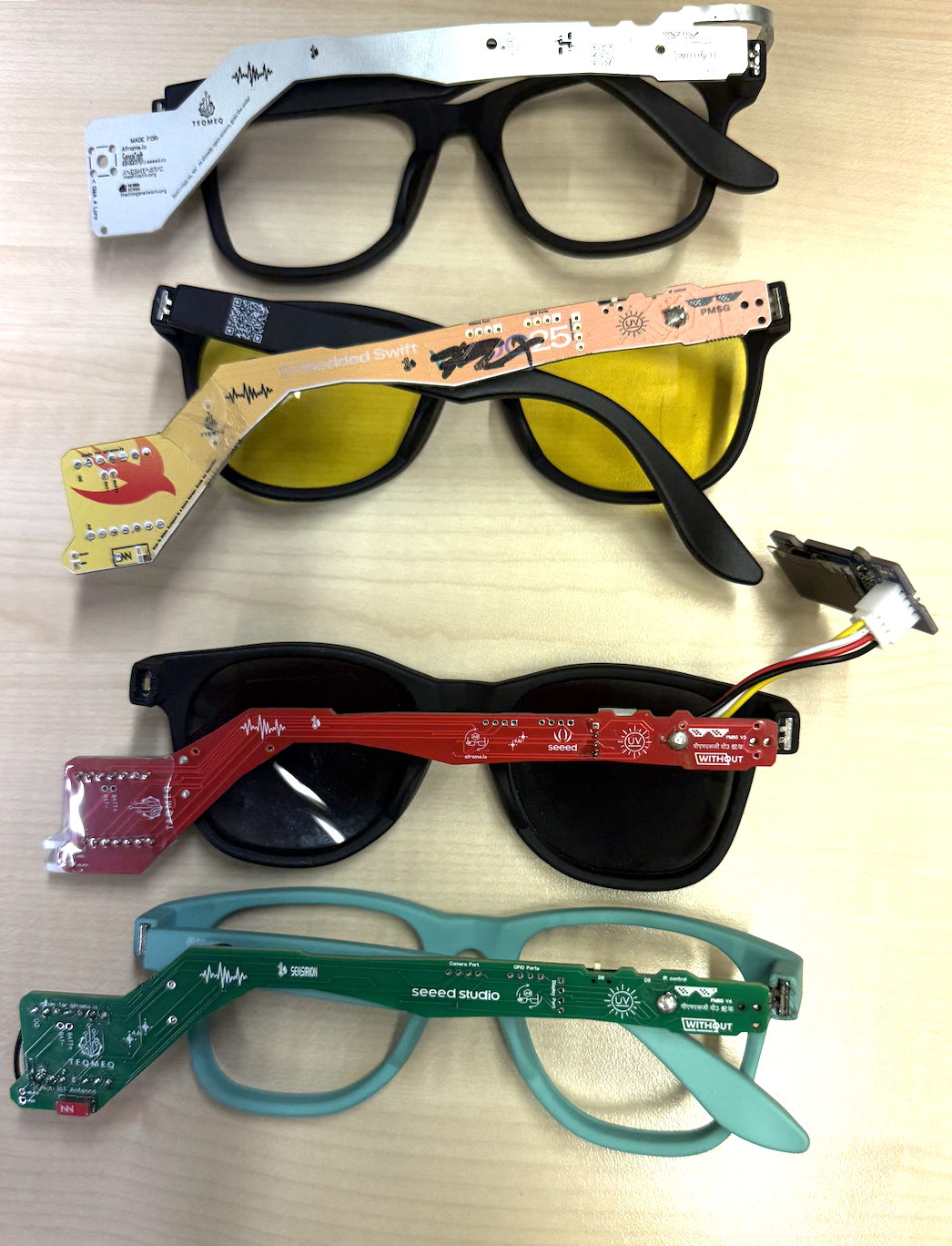

Type of PMSG models 2024/2025
We love pushing boundaries in wearable tech. For our PMSG Smart Glasses, we’re experimenting with replacing parts of traditional PCB epoxy with aluminium inspired by Without® — to make our hardware more recyclable, skin-friendly, and comfortable to wear.
This aluminium PCBA experiment is just one of many steps in our mission to make wearable electronics smarter, more sustainable, and more human-centric.
