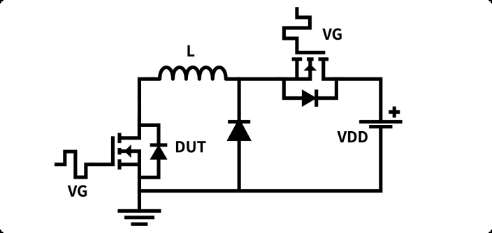

Testing Principles and Evaluation Methods for EAS
EAS testing is typically conducted using an inductive load switching circuit. The fundamental principle is as follows: The gate signal controls the MOSFET to turn on, charging a series-connected inductor. When the MOSFET turns off, the stored energy in the inductor is released through the device, forcing the drain-source voltage VDS to rise and potentially exceed its breakdown voltage BV_DSS, triggering an avalanche state. Testing continues until device failure, and the energy consumed is calculated based on parameters such as the current before failure.
A typical test method involves setting the bus voltage V_DD, applying a pulse voltage (e.g., 10V) between the gate and source to turn on the device, and then turning off the device once the inductor current rises to a specific value I_AS. The release of inductive energy triggers avalanche breakdown. EAS is then determined through measurement or calculation. It is important to note that accurate EAS calculations should utilize the actual BV_DSS value measured during testing, rather than relying directly on the nominal value specified in the datasheet. Furthermore, testing conditions may vary between manufacturers. Therefore, the EAS capability of different devices cannot be directly compared based solely on the values listed in their specifications.

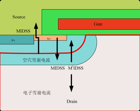

EAS Failure Modes and Mechanisms
When avalanche energy exceeds the device's limits, destructive failure occurs, primarily through two modes.
The first is parasitic diode avalanche burnout. A body diode (parasitic diode) exists within the MOSFET. When the device turns off and the inductive load continues to flow, the parasitic diode experiences reverse voltage. If voltage spikes cause it to enter an avalanche breakdown state, the high current and voltage generate significant heat within the chip. Without timely dissipation, the device will burn out due to overheating.
The second type is parasitic bipolar junction transistor (BJT) turn-on. Within the MOSFET structure, there also exists a parasitic NPN transistor formed by the source, P-base region, and N-drift region. Under normal conditions, it remains in the off state. When the parasitic diode undergoes avalanche breakdown, the current flowing through the lateral resistance RB of the P-base region increases. This may cause the voltage drop across RB to exceed the turn-on voltage (VBE) of the parasitic BJT, thereby turning it on. Once the parasitic BJT turns on, it forms a high-current path, causing the MOSFET to fail in a short-circuit condition. To suppress this failure mode, modern MOSFET designs focus on minimizing the RB resistance. Currently, most EAS failure cases still primarily involve overheating due to avalanche breakdown of the parasitic diode.
EAS burnout points often concentrate near the gate pad (PAD). This occurs because cells closer to the gate exhibit smaller parasitic parameters and faster turn-off speeds. During avalanche events, these areas experience stress and breakdown before other regions.
