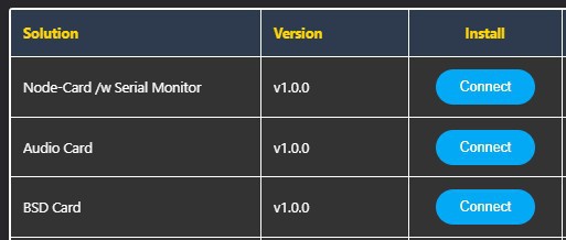

Firmware Delivery Became Predictable
The documentation site does more than describe firmware—it delivers it. Each supported device/variant has a documentation entry that presents an install action, so firmware is loaded over USB directly from the documentation page. This removed the Arduino-IDE workflow from the end-user path and made deployment repeatable across devices and updates.
Once variants were deliberate artifacts produced from a single source, firmware delivery could be simplified.
The Arduino IDE and CLI remain in use, but only as developer tools to produce known firmware images. End users never interact with source code, libraries, or build systems.
Instead:
documentation links point to specific firmware variants
devices are connected via USB
firmware is loaded as a single, repeatable action
This eliminated many common error classes in example-driven workflows and shifted responsibility to where it could be managed once.
