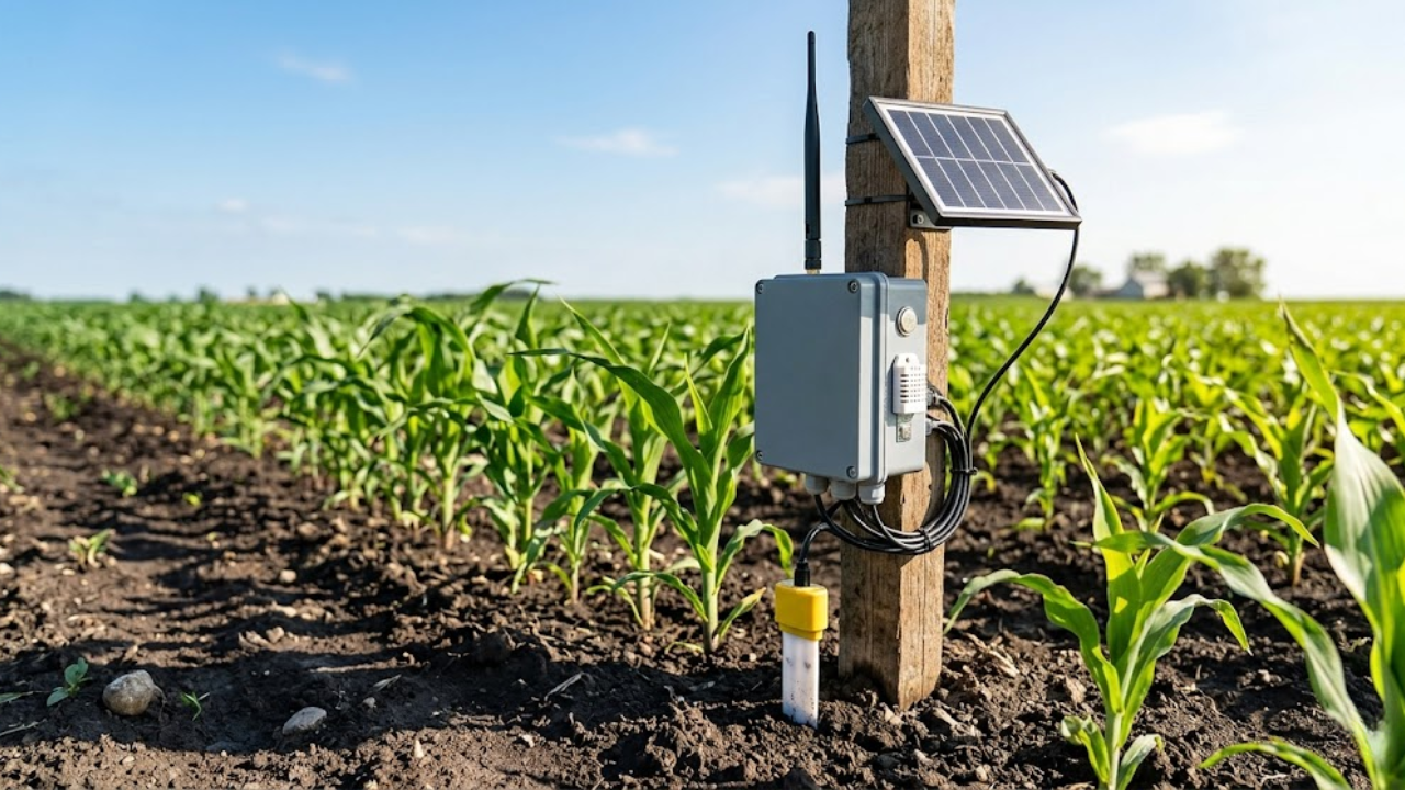

The node is designed around the ESP32-LoRa development board, which integrates the MCU and radio on a single PCB. The sensor suite includes a capacitive soil moisture sensor (to avoid the corrosion issues of resistive versions), a DHT22 for ambient temperature and humidity, and a BMP280 for barometric pressure.
Data is collected every 15 minutes. To conserve energy, the ESP32 utilizes its Deep Sleep mode, drawing only a few microamps between transmissions. The data is sent to a central gateway (such as a Dragino or a DIY Raspberry Pi gateway), which سپس pushes the information to an MQTT broker or a dashboard like ThingsBoard.

One of the primary hurdles in remote sensing is power management. While the ESP32 is powerful, its Wi-Fi and Bluetooth stacks are energy-hungry. By disabling these radios and using the LoRa PHY layer exclusively, we significantly extend battery life. This project utilizes an external MOSFET to "gate" the power to the sensors, ensuring they are only powered during the 2-second measurement window.
