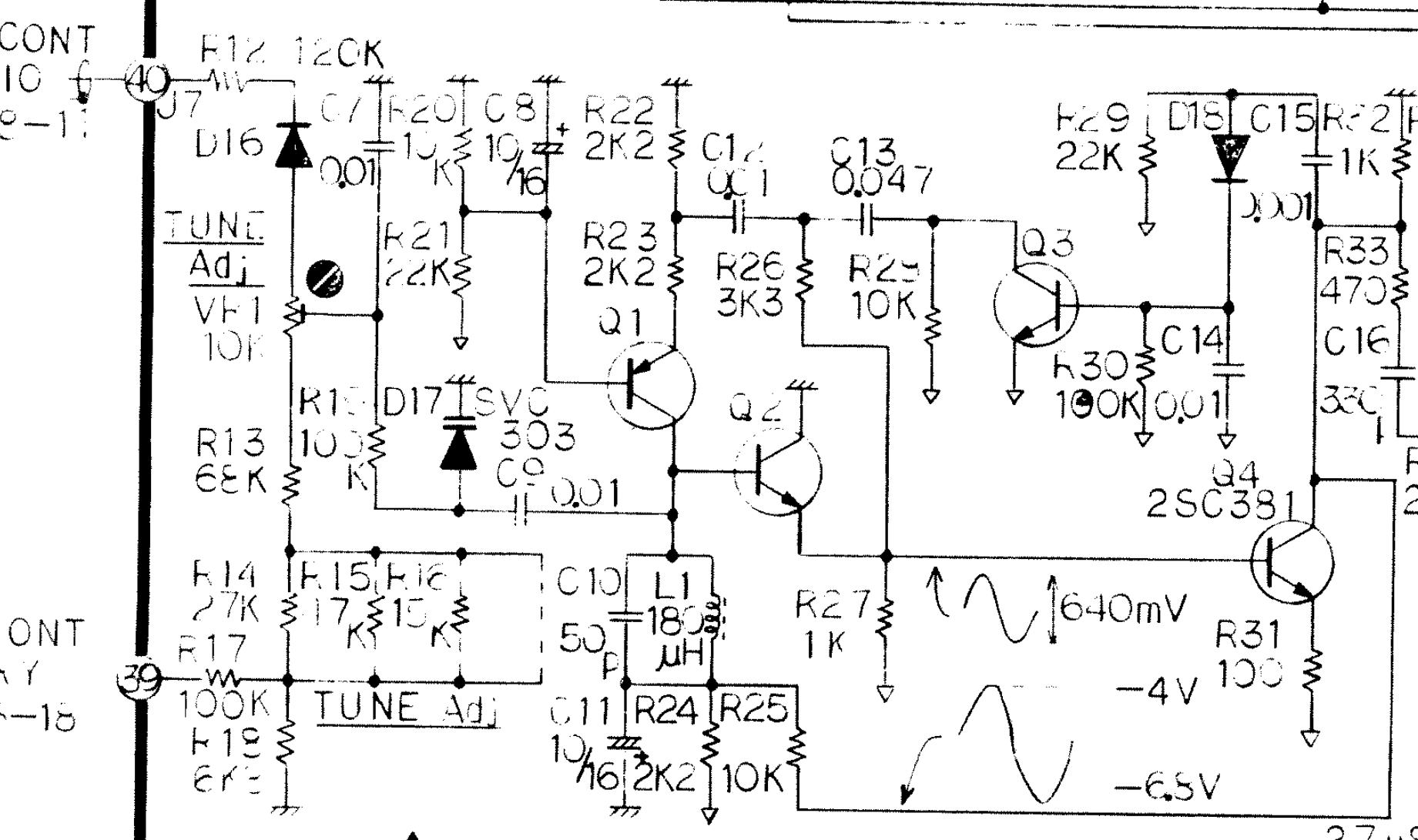

This is a circuit I've been studying this week. It's the master oscillator from the Roland RS-505 Paraphonic synthesiser, which generates a 2MHz square wave from a DC voltage. This master clock is ultimately used to derive the frequencies of all 49 keys on the RS-505's keyboard using clock division performed by counter ICs.
Despite being based around an LC tank rather than a crystal, it supposedly achieves excellent frequency stability thanks to the negative feedback from transistor Q3 (among other things). The need for this kind of circuit instead of a fixed-frequency crystal oscillator, which would require significantly fewer components, is to allow modulation of the clock frequency using a DC bias and the varactor diode - this is how the synth produces vibrato.
An interesting quirk with this circuit is that it uses Vcc = 0V and Vee = -12V, such that the highest supply potential is ground (rather than the traditional Vcc=12V and Vee=0V). Roland says that this is to improve oscillator stability from the power supply, as capacitive and inductive effects are reduced when the positive supply rail is at the same potential as the surroundings. Of course, this entire circuit would still work with Vcc=12V and Vee=0V because potential is relative, and the circuit is probably easier to analyse in this way. Really interesting design decision by Roland, it'll be interesting to see how much of an impact this has on the oscillators I build.
