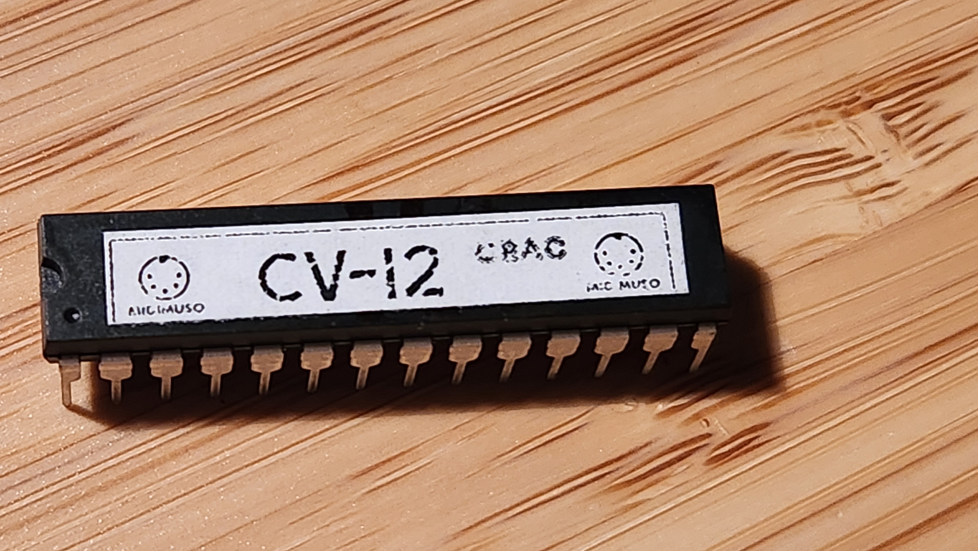

CV-12 ORAC chip from Midimuso (£17.49 as part of a kit containing a PCB and other components)
The CV-12 is a remarkable chip, which is capable of converting digital MIDI signals into a CV (control voltage) and a trigger (a short pulse that tells an envelope generator / amplifier when a MIDI Note On event is detected).
Many MIDI to CV/Trig converters are very expensive, with good ones costing around £100 each. These are intended more for the Eurorack market rather than for ground-up electronics builds, so don't really fit my requirements or budget.
What makes the CV-12 special is that it is capable of polyphonic MIDI to CV conversion, meaning it is capable of outputting many control voltages (corresponding to many different notes) at once. This means it becomes possible to play chords from the get-go. It's also fully configurable with various mode changes. Polyphony can be sacrificed for additional MIDI parameters like note pressure and pitch bend, and even VCF parameters like cutoff / resonance. Considering what this thing can do, £17 is an absolute bargain.

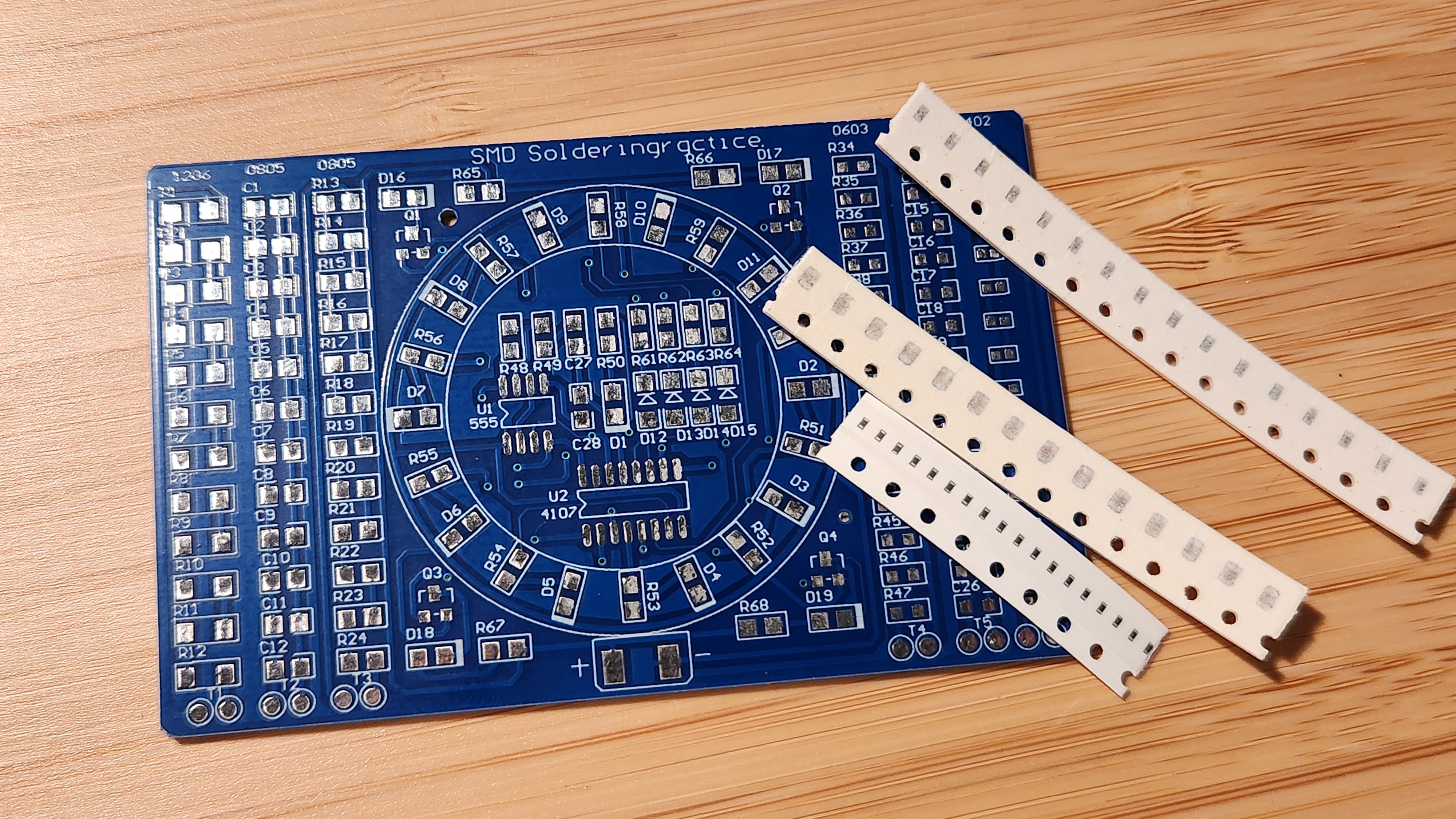

SMD soldering practice kit, £0.75 from AliExpress
I also bought an SMD soldering practice kit, if not for learning how to solder SMD components for this project then just for a bit of fun. This consists of a small, and a variety of SMD resistors, capacitors and chips in different sizes to practice with.
I don't think I quite realised just how small SMD components really are - whilst the 1206 and 0805 size look manageable to solder with my iron, the smallest 0402 size ones are absolutely tiny.
