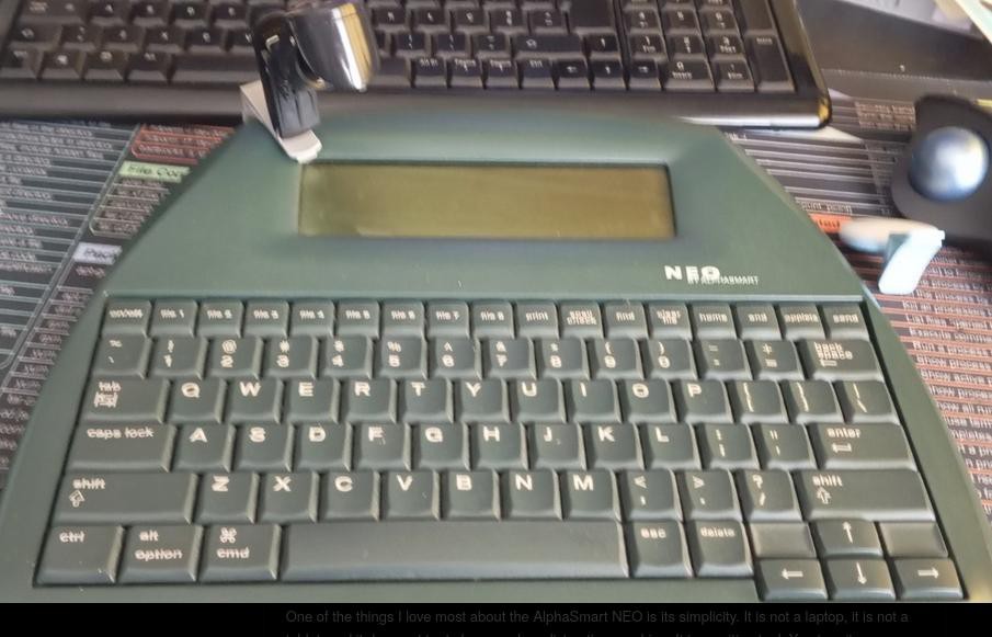

So I designed and 3D printed a small light support for my AlphaSmart NEO and you can literally clip any light on it.
The goal was very simple I wanted to use a small clip-on LED light with the NEO without damaging the machine or modifying the case, and without losing the clean, distraction-free feeling that makes the AlphaSmart so useful

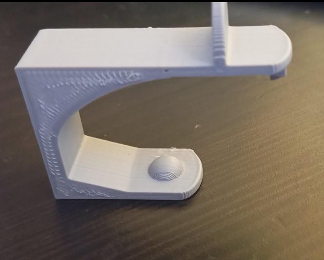

The most important part of the design is how the support is secured to the AlphaSmart NEO.
Because I wanted to avoid any permanent modification, the support had to use the existing shape of the device. The back of the AlphaSmart and the area around the screen became the natural anchoring points. In other words, the support works because it is shaped to clip onto the NEO itself and as you can see on the image it secures on the screw hole.
This is I think what made the design useful, it does not depend on glue, screws, magnets, or changes to the original case. It is a mechanical fit.
The second important part is stability. The AlphaSmart is a writing device, so the support must not move every time you type. It needs to feel secure, especially once the small LED light is clipped onto it.
Only after solving the attachment problem does the light angle become important. The light must illuminate the screen without creating too much glare. If the lamp points directly at the screen, it can create a bright reflection. If it points too high, it may not illuminate the LCD properly. The support therefore needs to hold the lamp in a position where the LED can be aimed carefully.
The clip-on lamp also adds a little weight, so the printed part must be strong enough to handle the pressure from the clip while still holding firmly to the AlphaSmart.

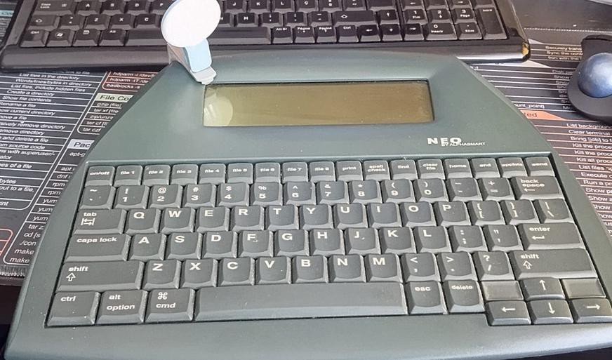

The support sits on the top-left or top-right area of the AlphaSmart NEO, it clips into place by holding onto the back of the AlphaSmart and using the screen area as part of the support. This is the key element of the design, it stays in place without modifying the device.
When the small LED lamp is clipped onto the support the light can be directed toward the display. This makes the screen easier to read at night without needing to light the whole room.
The result is simple but effective. The AlphaSmart remains exactly what it should be: a focused writing machine. The support only adds what is missing — a little light.

With the support in place, the AlphaSmart NEO becomes much easier to use in a dark room.
The light is focused on the screen, not the whole desk. This keeps the writing environment calm and minimal. It is perfect for late-night notes, journaling, drafting articles, or working on a book when the house is quiet.
