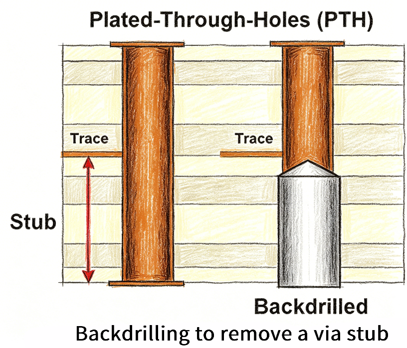

PCB back drilling, also known as via stub removal, is a targeted drilling process performed after the standard via has been fabricated. Its goal is to remove the unused portion of a plated through-hole (PTH) that extends beyond the layers the signal actively connects. This leftover portion is the stub, which if left intact, can reflect high-speed signals back toward the source.
A standard via in a multi-layer board might traverse six or more layers, but a particular signal may only require connectivity between layers two and four. The portion extending into layers five and six does not contribute to functionality and becomes a stub. Back drilling selectively removes this excess copper, leaving a clean, stub-free path between the necessary layers.

Back drilling is a controlled manufacturing step, typically performed after PCB lamination and standard via plating. The process involves precision drilling to remove only the unwanted stub portion while preserving the functional via. The procedure can be summarized as follows:
Design Layer Analysis
Engineers determine the exact depth to which each via needs to be removed. CAD tools or SI simulations guide this decision.
Drill Selection
Specialized micro-drills or laser-based drills are selected based on via diameter, board thickness, and material type. For example, a 0.2 mm via might use a 0.15 mm drill to remove the stub precisely.
Controlled Drilling
CNC machines perform depth-controlled drilling. Modern systems ensure ±10 μm precision to avoid over-drilling, which could compromise the via connection.
Post-Drill Cleaning
Any residual debris is removed. Some manufacturers apply chemical cleaning to ensure no copper flakes or resin particles remain.
Inspection
Optical or X-ray inspection confirms that stubs are removed without affecting the via's functional connectivity. Automated optical inspection (AOI) or cross-section analysis is common.
