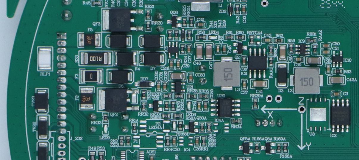

PCB Design Considerations
Power supply selection also affects PCB layout.
For LDO designs:
- Use short traces.
- Place capacitors close to the regulator.
- Ensure adequate copper area for heat dissipation.
- Maintain a solid ground plane.
For DC/DC converters:
- Minimize high-current switching loops.
- Keep inductors close to the switching node.
- Separate noisy and sensitive analog sections.
- Optimize thermal vias and copper pours.
- Follow the manufacturer's recommended reference layout whenever possible.
Because switching regulators are much more sensitive to layout quality, PCB design can significantly influence efficiency, EMI, and long-term reliability. Experienced PCB manufacturers such as PCBMASTER can assist with design-for-manufacturing (DFM) reviews to ensure power circuits remain manufacturable while meeting electrical and thermal performance targets.
