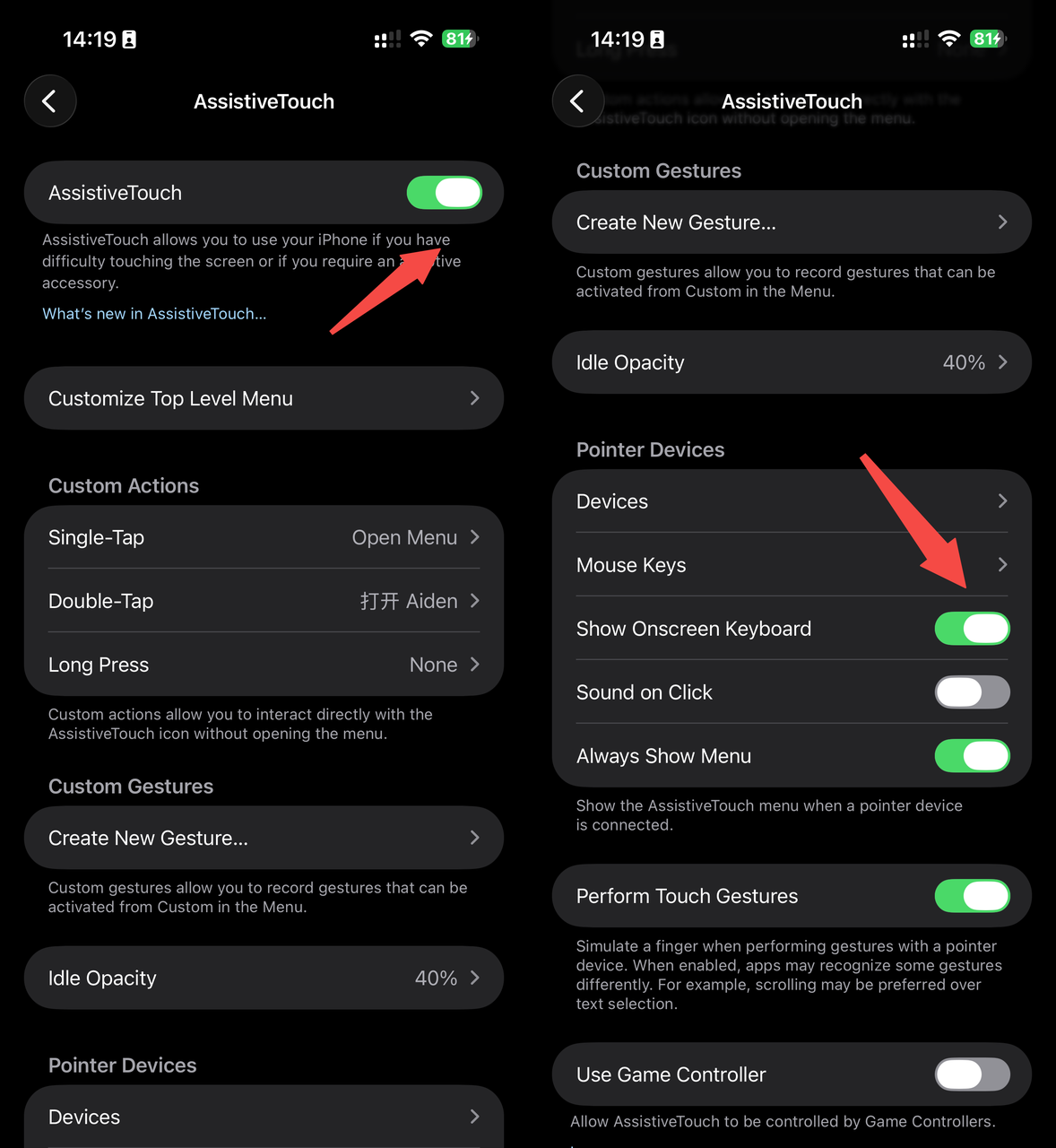

With AssistiveTouch left on throughout:

Critical pair: identical keyboard, identical settings, identical test method, keyboard-only vs. keyboard+mouse. Adding the mouse brought the failure back immediately. Removing it: 22/22 clean.
Conclusion: with AssistiveTouch enabled, if iOS detects Pointer/Mouse capability on the connected device at the same time as a keyboard, it can misroute modifier-key commands to SpringBoard. Reproduced on hardware with zero relation to our stack (a standard gaming keyboard, a Bluetooth keyboard), so this rules out an HID-compatibility explanation specific to us. It's a routing bug inside iOS itself, and without source access we can't say why Pointer/Mouse capability affects KeyboardFocus resolution, only that it reliably does.

Two USB HID profiles with different Product IDs/serials, so iOS doesn't reuse stale device state:
- Normal: keyboard + pointer
- Right before a modifier-key action: re-enumerate keyboard-only, send the keypress, restore pointer after
Switching scope covers a whole agent action, not a single keypress, to avoid the software keyboard popping/retracting repeatedly mid-action.
