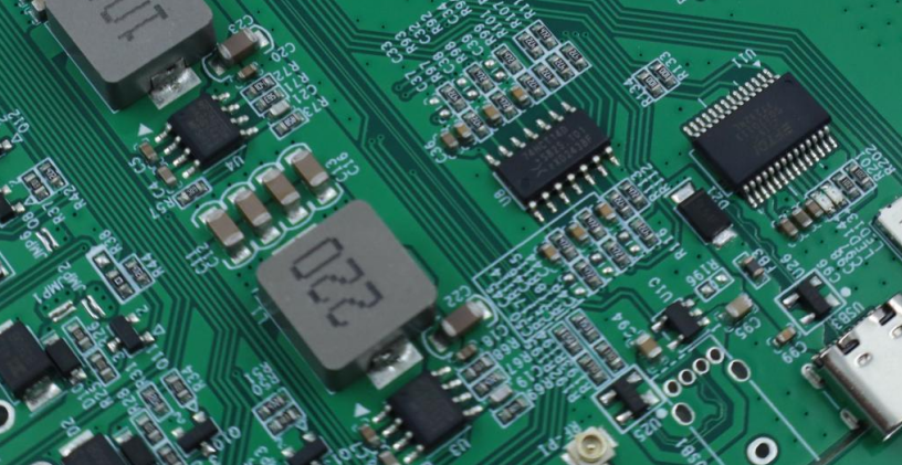

What Happens When a 1 Farad Capacitor Is Connected to a PCB?
This is where things get more interesting for PCB designers.
A large capacitor is still connected to the PCB through physical interconnects, and those connections introduce their own resistance and inductance.
For low-frequency energy storage, these parasitic effects may be manageable.
For fast current transients, however, they can become significant.
A simplified power path might be:
Capacitor → connector → PCB copper → power plane → load
Every section contributes some impedance.
Consequently, PCB layout becomes important when a high-capacitance capacitor is expected to deliver substantial pulse current.
Design considerations can include:
- Short current paths
- Adequate copper width
- Appropriate copper thickness
- Low-inductance connections
- Proper via arrays
- Solid power and ground planes
- Thermal management
- Mechanical support for large components
For production hardware, PCB design also needs to account for the capacitor's physical footprint and mounting requirements.
This is one reason PCB fabrication and assembly should be considered together rather than treating the capacitor as an isolated component. PCBMASTER, for example, can incorporate component constraints into PCB manufacturing and assembly considerations when translating a power-storage design into production hardware.
