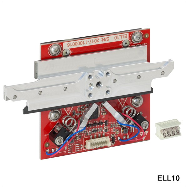

There is this resonant housing contraption for example which pushes against a linear or circular object to create motion:
Thorlabs markets this type of resonant actuator as a linear stage for optical benches.

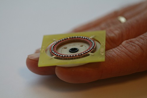

But ultimately I'm looking into designing a sort of resonant type linear actuator with these SMD piezo elements (reflow capable):
https://pcbmotor.com/
Note they again show the resonant ring type geometry but one can also buy the piezo elements as taped 0404 SMD parts and go from there.
